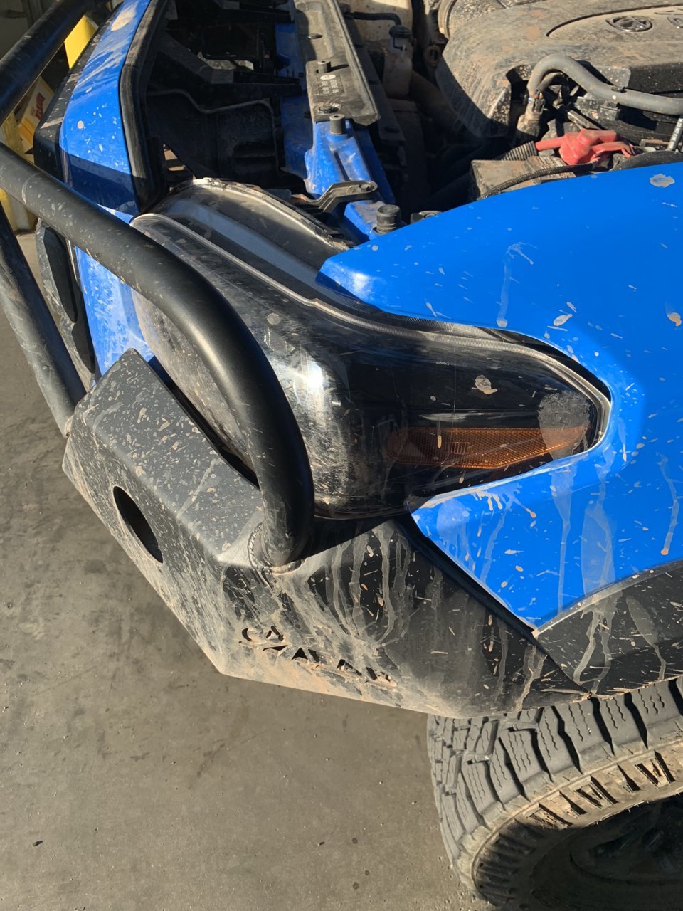

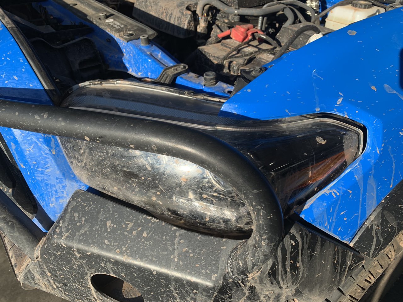

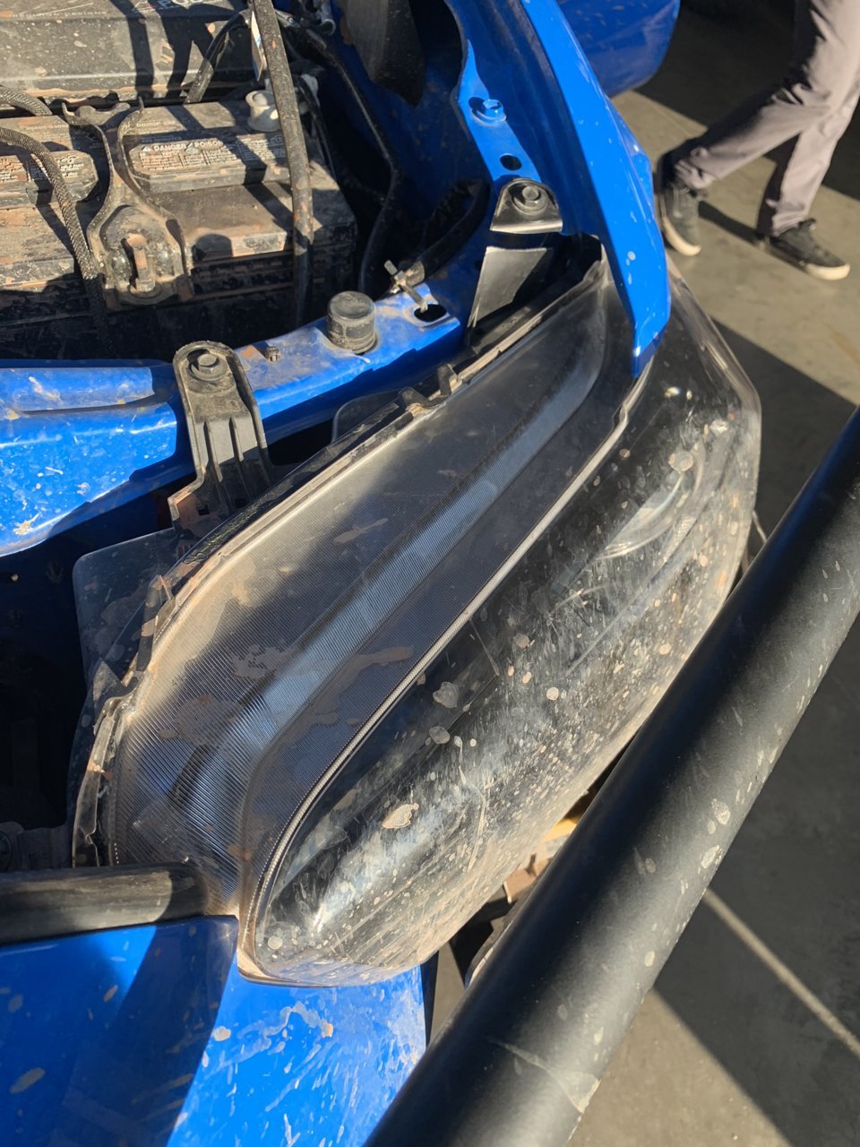

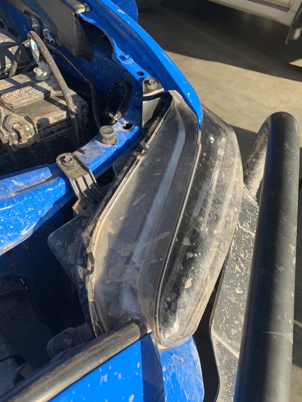

    I recently drove my 2019 TRD Pro across the country on the TransAmerica Trail. When I got to Colorado I realized the driver's side headlight was rattling around as I bounced around the trails. By the time I got to a dealership in Denver, the top plastic tab broke and the headlight had dropped down behind the fender. The Toyota dealership wasn't sure what the issue was and zip tied the light up for me since I was not at my home dealer and it was going to take 2-3 days to order a new unit anyhow. About a week after that, the same exact issue happened with the passenger headlight. Now they both are broken and I had to use zip ties to minimize any additional damage since they were banging against the fender. When I took it to Toyota back home, they are insisting that this was caused by some sort of impact but I did not hit anything and this is clear since there is no damage elsewhere on the truck. They wanted $1500 for EACH headlight to replace them plus a few hundred dollars for minor body work where the fenders have gotta misaligned and the paint rubbed on. I'm fighting it with corporate but wondered if anyone else has had this issue? I heard something similar was happening with FJ Cruisers a few years ago. Somewhat frustrating that the most 'capable' off-roading Tacoma and expensive TRD Pro had this sort of issue with just 10k miles on the odometer.

    I've never had an issue and I'm not easy on my truck. Was the truck clean when u brought it in? I know those tabs are weak.

    I’d say that aftermarket bumper being bolted to the frame and the body on bushings bolted to frame made contact and damaged the headlights

    What say you op? Any marks at the bottom of the headlight?

    Looks like the support from the oem bumper under the light is gone with that bumper. And only the tabs holding it. Probs why they with all the off-road they snapped

    No I didn't wash it when I took it in since I literally just got off the trail and went straight to the dealer in Denver. I will be washing it thoroughly whenever I take it back once I hear back from Toyota North America. There is no damage to the bottom of the light where the bumper lines up and the lens has no cracks or scrapes. There are minor scrapes on the skid plate where I hit a tree root or rock but nothing major. It does have a screw on either side where the factory bumper attaches and there is a bolt there which should provide support. C4 Fab is a reputable fab shop and I'm sure they have sold a ton of these bumpers. I feel like if the bumper was causing this, C4 would have heard by now or others with the Overland front bumper would have the same issue.

    do you have any other broken tabs of anything else...or missing retainer clips?

    Nothing else, just those the top tab on each of the headlights. Exact same tab on the driver as the passenger.
