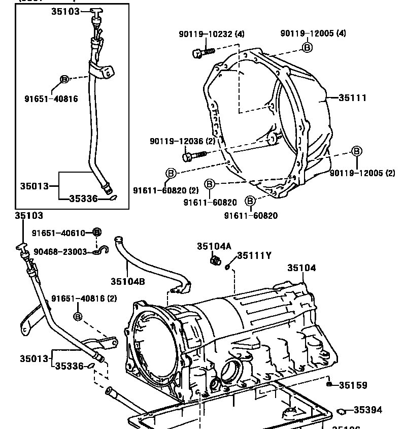

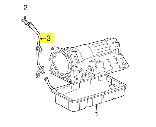

    Just in case you need the part number..........
    Filler Tube - Toyota (35013-34060)
    Toyota Part No.: 90301-09011 (Rubber O-Ring)
    Not exactly like your truck or mine, so ignore the part numbers. Just a good example of how the trans tube connects.
