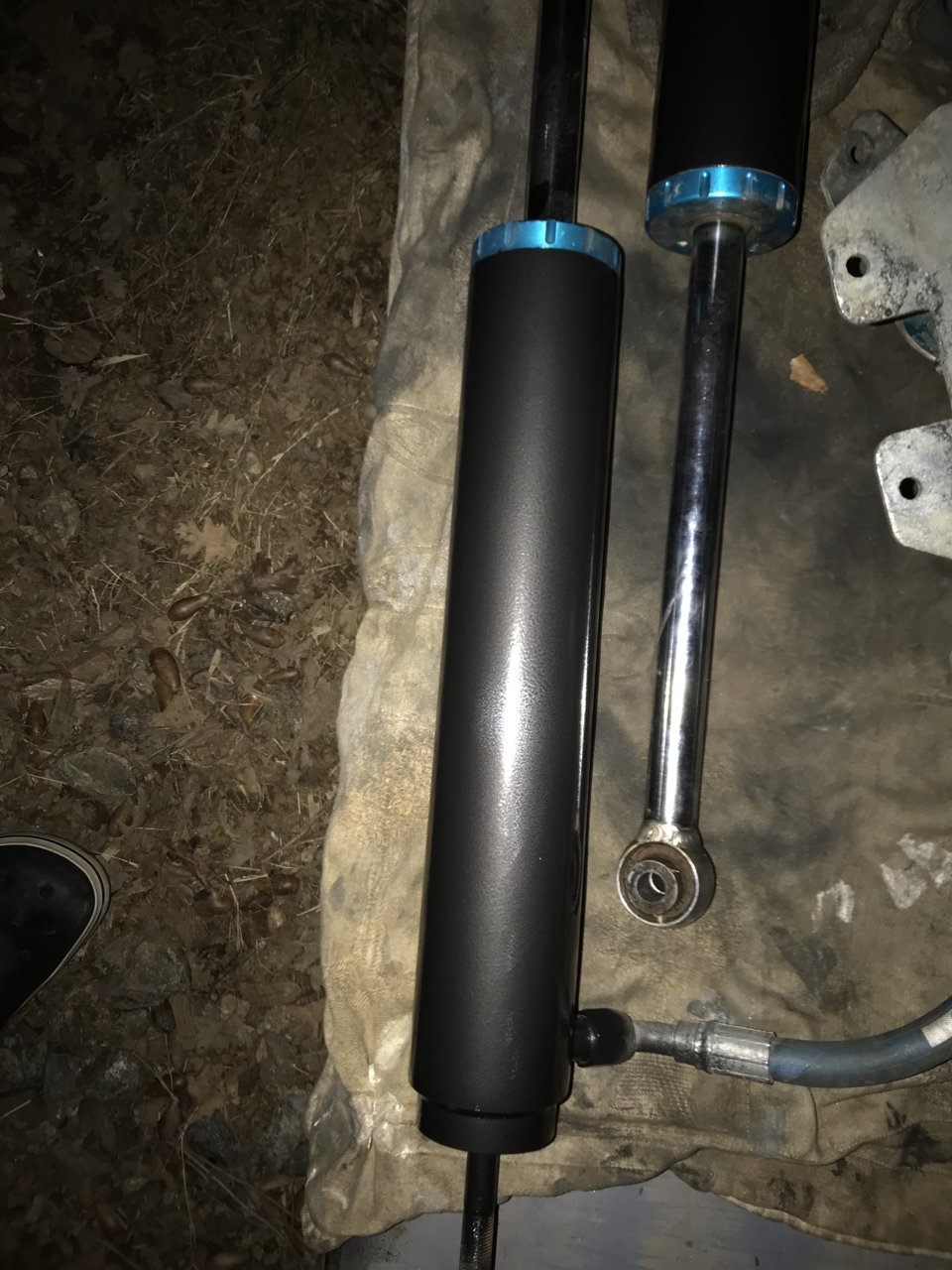

    Here are my kings and they have lived almost their whole life right here in Cali. Just took this pic today as I am painting them. Fronts look just as bad. And my coils look almost like his as well. My icons on my other rig look way better and they see almost the same kind of conditions.
    Edit: I just went out and rechecked my fronts and my coils do look better than his. Just my bodies are jacked up.

    I have had them for 6 years and I have rebuilt them a couple of times so I knew they were getting bad over the years. I just wire wheeled the top layer off and then primed and painted them today. Fronts will need the same as well as new coils due to some rusty spots.
    CrispyTacoLover likes this.
