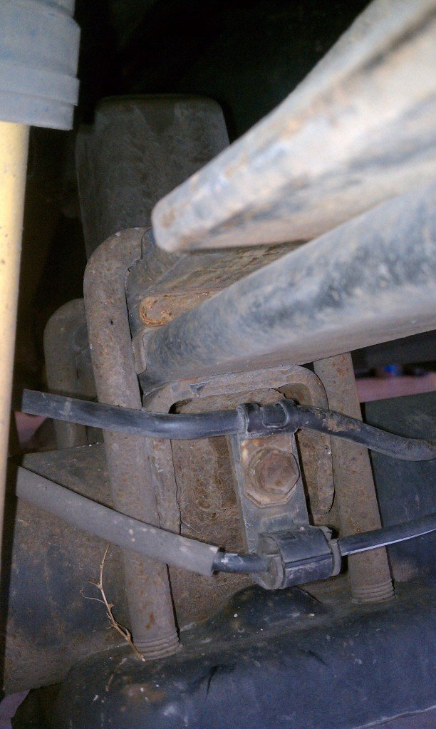

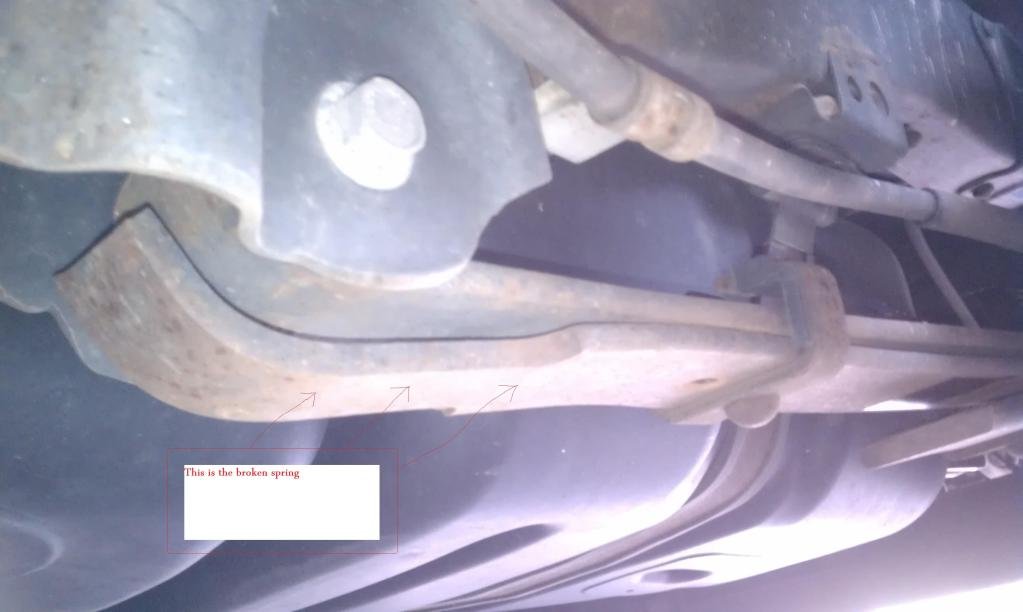

    Hi, my name is Al, and I am new to the forum. I have a 2007 4x4 Tacoma Sport Double Cab with 123,000 miles that rides like sh**, so I have been looking into getting the "highly-recommended" bilstein 5100 ride height adjustable shocks to improve my overall ride. Today, I noticed a slight lean on the drivers side (looking from the rear) so I crawled underneath to take a look, and found a broken leaf!
    As I am new to all of this, please give me some advice as to how I should repair, and the money that this repair will cost me. Thanks in advance to any advice!

    You should replace both leaf packs, springs, and front and rear shocks. You are about due. And ya about $1000 bucks should cover it.

    It's both leaf packs, new front coils, and all 4 shocks. Youll have to get leaf spring bushings from wheelers off road. Freight on the leafs was $85 for me because they're overweight. The ride is better than stock IMO and its a nice lift. Do your research though and make your own decision.

    This. If you just want your leafs un-broken, a replacement stock pack is in order. But dear god, don't pay what the dealer wants for them...get them used for a song.

    I would suggest taking your truck to a spring shop and getting an estimate to replace the one broken spring and add one spring to each side. My guess would be $300-350 installed. There should be several spring shops in Columbus and there is Black's Spring in Zanesville or S&S near Gratiot.

    Alby22, I have heard of trails West, but never dealt with either shop. The $300 installed is a quote from both Blacks and S&S for installing one additional spring to a Tacoma Rear Suspension. Add the $50 for replacing the broken spring at the same time. A local spring shop will give you exactly the ride and lift with alignment and a waranty, that you want. They can install the shocks while they install the springs real cheap. Springs are their business. For myself, I would not even consider anyone beyond a local spring shop. They will have your truck in and out in under an hour.
