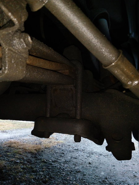

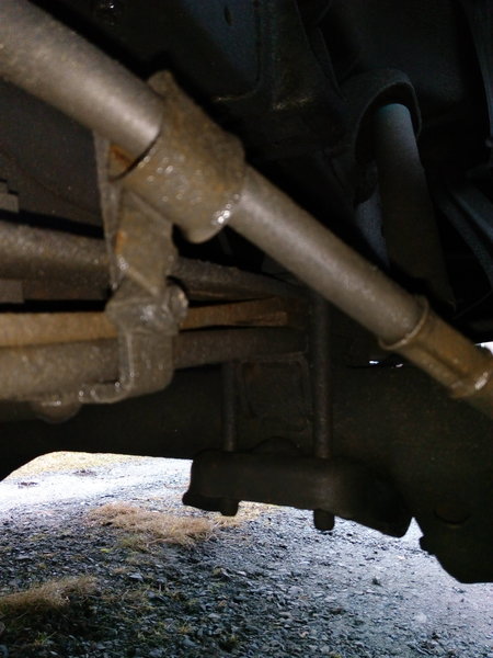

    Well hello everybody! I'm new here, been reading for a bit though. Lately I've been looking at new summer tires for the spring and have been looking here for sizes and suggestions, but now I have bigger problems! This ended up quite long so a TL;DR is at the bottom.
    For Reference: 2009 Tacoma, SR5, 4x4, 4 cylinder, 5 speed standard, ~110k Km (I'm in Canada, not the US)
    I had a few errands to run today, so I went out, opened the door, jumped in, and BANG! Didn't sound good but I had a quick look around and didn't see anything obviously wrong (Clearly I didn't look closely enough) so I went along my way. It seems to be riding rougher than usual, and when I go over a speed bump there is a terrible bang, similar to the first. I have another look in a parking lot, and this time I notice something seems off about the driver's side leaf. Thankfully I do make it back home and crawl under for a better look and to take some pictures.
    From the pictures you can see that part of one the leaves is straight up gone. It's not in the driveway, so I have no idea where it is. I've come to discover that my vehicle is covered by the leaf spring recall. My understanding of the Toyota website is that they still do not have parts for this, but of course the dealer is not open today for me to go get more information. I'll go in tomorrow and see what I can find out. Also, this is not the first time the leafs have broken. I know that the previous owner had broken and replaced both leaf springs previously.
    I'm looking for opinions though. How bad is this? I can't imagine this is a good idea to drive on, but I don't have much of a choice at the moment. I was always hoping to lift if I ever got the money, and based on my reading here it seems Toyota may reimburse for leaf replacements. In that case, I'm hoping I may be able to get Old Man Emu Dakar leafs and get reimbursed. Is this really a good idea though? I should really replace the shocks with longer ones if I go with a lifted leaf right? And then it may also be a good idea for extended brake lines, and a differential drop may be required if I have shudders. Unfortunately I don't think I'd be able to afford to lift the front as well (Mostly because I'd like to do it properly with new coils, shocks, and control arms) so it would end up with just the rear lifted for some unknown period of time. Thoughts and opinions?
    TL;DR: Broke a leaf spring, what to do now?

    It's not the main leaf, your good. If it were me I'd replace the leaf asap but it's acceptable as is. Hell here in pa state yearly safety inspection will pass a truck with a broken leaf as long as it's not the main leaf.

    At this point call the dealer and let them know a leaf snapped. Hopefully they can magically procure a new set of springs.

    Turns out there were 2 leaves broken on the driver's side and 1 on the passenger side! I can't imagine they all broke Sunday so who knows how long they were broken. Cost me $350 (CAD) between parts and labor. I'll be keeping the invoice to get a refund for Toyota when (if) they ever get the second notice out.
