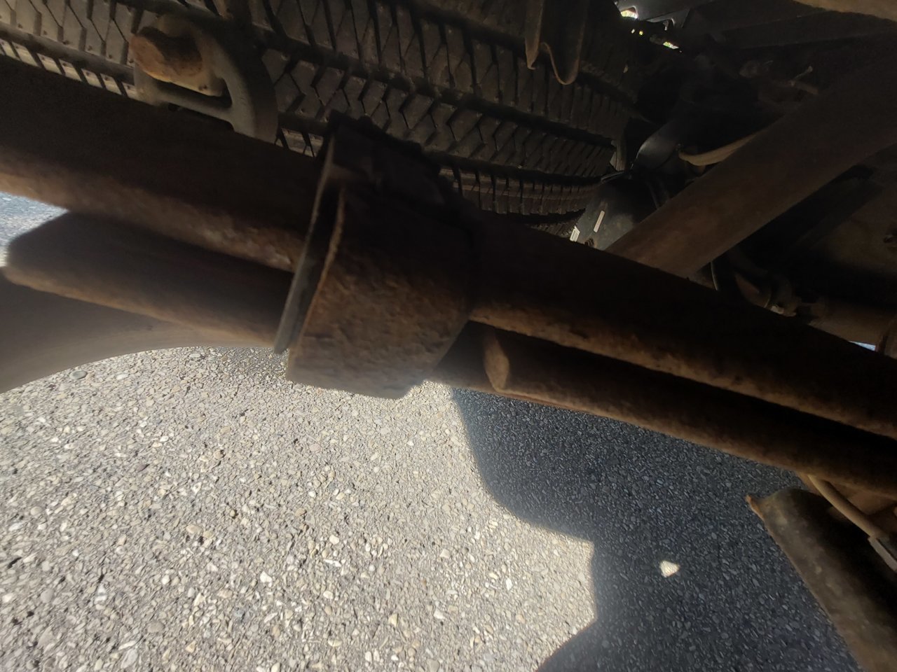

    One of my leafs seem to be broken and have to get replaced, instead of getting the whole thing replaced I was thinking of getting an aal instead, how would that go

    Toyota will replace the early 2+1 springs under recall with a 3+1 spring, call your dealer.
    It appears that you have the 2+1 being a 2006 and that they are rusty, hard to tell from your pic.
    Toyota may also install fresh shackles and U-bolts
    Then if you need an AAL for hauling weight after that, hit Archive up

    Is it an expensive replacement with toyota dealer? Cuz I've heard it's a pretty expensive fix with a mechanic shop
    I was thinking of getting an aal and replacing it wt the broken leaf

    Free under recall, bring it in and see what they say

    Called a few dealerships
    One said since my trucks American (Im in Canada) its not under their recall, a few charged like 2.1K and one said they will do it under recall
