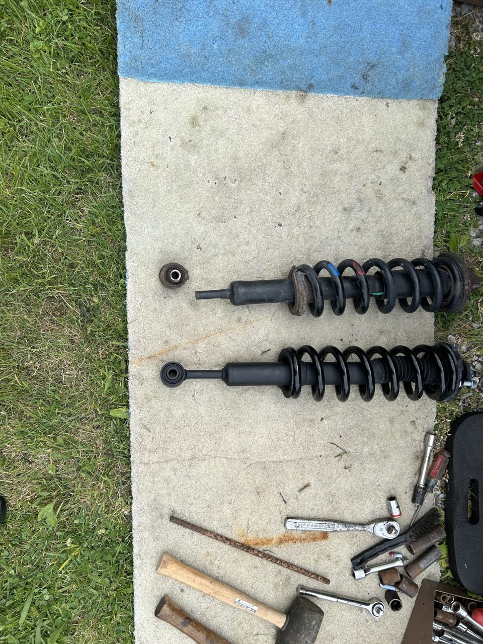

    2006 Tacoma, Pre Runner, 2.7 Broken eyelet, or lower strut mount on passenger side. Normal driving, no off road stuff. Original equipment, truck stays in Cincinnati area, 242,000 miles. I’ve read this has happened to a few other owners, being a fault, but not a common one.
    Was wondering how to prevent it from happening again. I’m not sure the lower mount bracket allows it to flex properly when the bolt is tightened down to spec

    It may have failed due to rust

    Just looks like it was time. Hopefully had a helluva life!

    Yeah, I’d say remediate by slightly reduced replacement intervals.

    There may be nothing you could due. It may be just a poor-quality joint from the factory that just couldn't take it anymore.

    You probably have already but if not a good time to check out your lower BJ and tie rods. If the shocks are original probably most parts will be.

    At 242k miles, it was well beyond its service life.

    You have it out push it and see what kind of resistance you get if it ain't much there is your answer

    Looks like just fatigue from age but also those rubber bushing joints should be tightened with the suspension loaded so the rubber bushings are in a relaxed state with the suspension loaded to minimize stress on the rubber bushing, same thing goes for upper and lower control arm bushings.
    I see this mistake made alot even in shops, tightening them with the suspension unloaded and then loading the suspension causes the bushing to be in a stressed state when the suspension is loaded which can cause it to fail prematurely.
