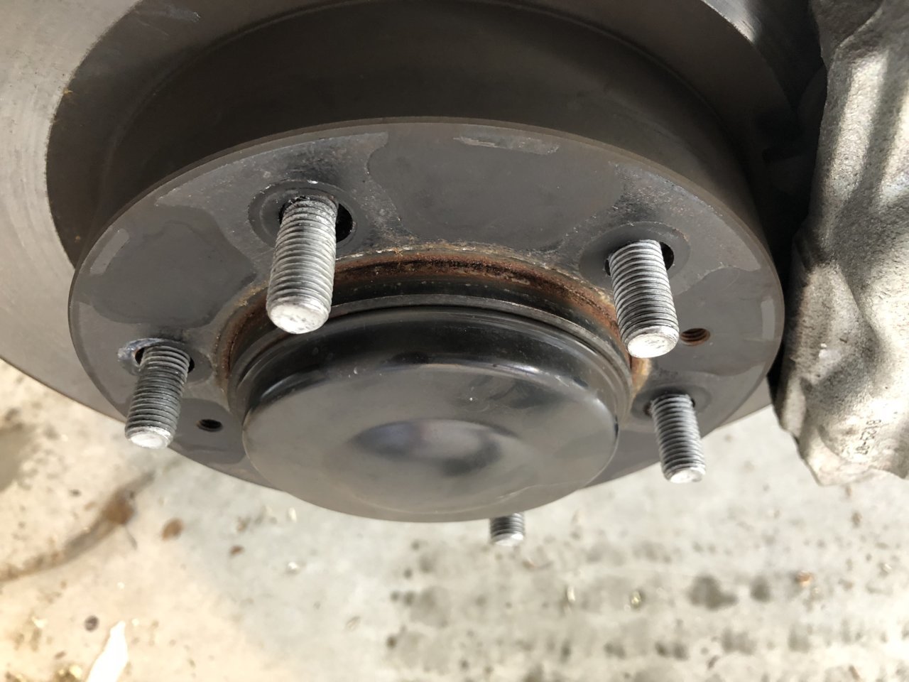

    Yes, it really sucked. It was weird how it happened to only one wheel when the others had been torqued down the same way. Backed the lugs off and retorqued all of them, only problem was that wheel. Maybe that axle shaft got into a bad batch of studs?

    Well got the wheel back off and it appears that all of the other lugs are ok. I guess I will put it back on and take it to a shop in the morning before work.
    I was going to try and install myself looks to be a pretty big job. There's a plate on the back side that is blocking it and would have to remove quite a bit of stuff to get to the studs.

    Oh and I checked the torque on the other lugs and they weren't to 83 pounds yet. Had to give them another quarter turn.
    So maybe it was an out of spec stud after all ?? :confused:

    Maybe it's just the camera angle but the top most stud in your picture (second from left) sure looks like the threads have been stretched. If so, might as well replace it too before it fails.

    That stud at the 11 O'clock position is most definitely a candidate for replacement alongside the one already sheared off.

    Got the studs replaced at the dealership this morning. They checked the others and all seemed good. They thought it may have just been a weak stud, since it spun off so cleanly. Replaced under warranty.
