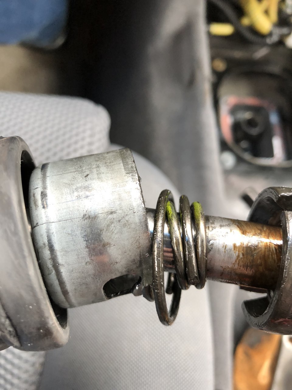

    Ok, so I dug into why my shift lever just came loose completely and would not shift into/out of gear. Found that the conical spring was broken and the top cap was bent. Is this normal or

    No, that is not normal at all. That is a sign of abusive shifting.
