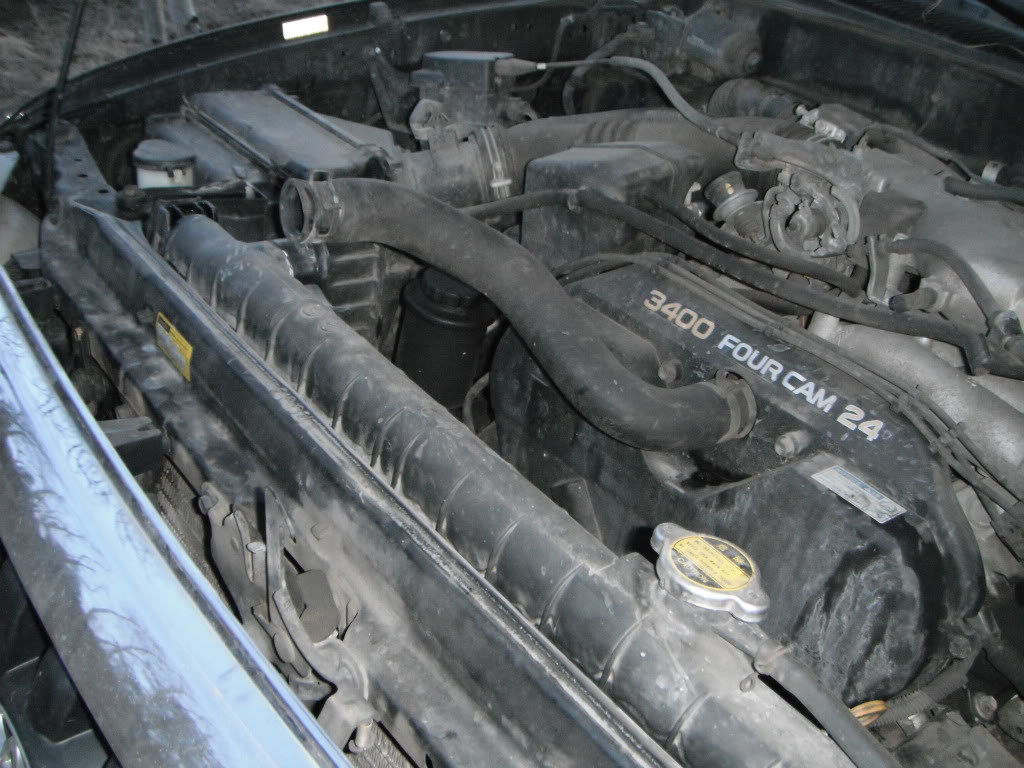

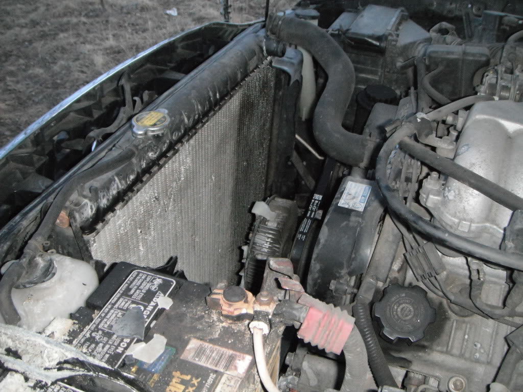

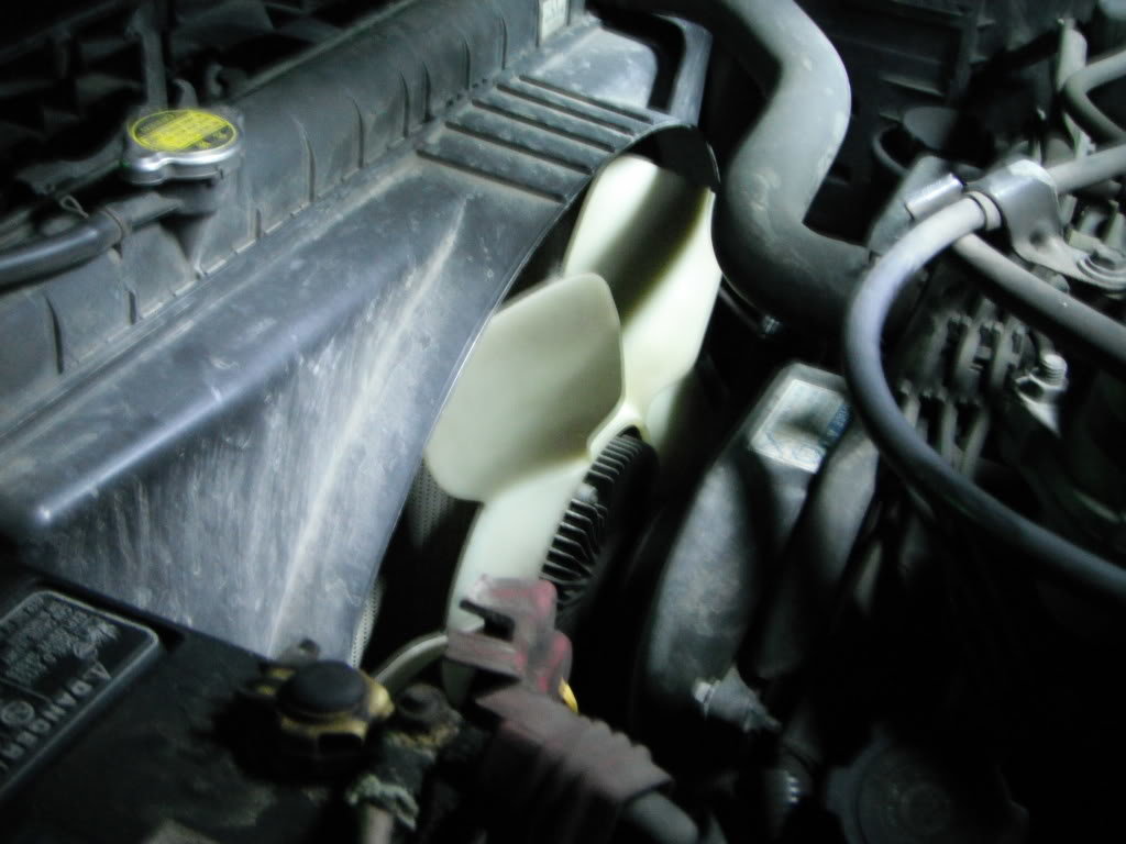

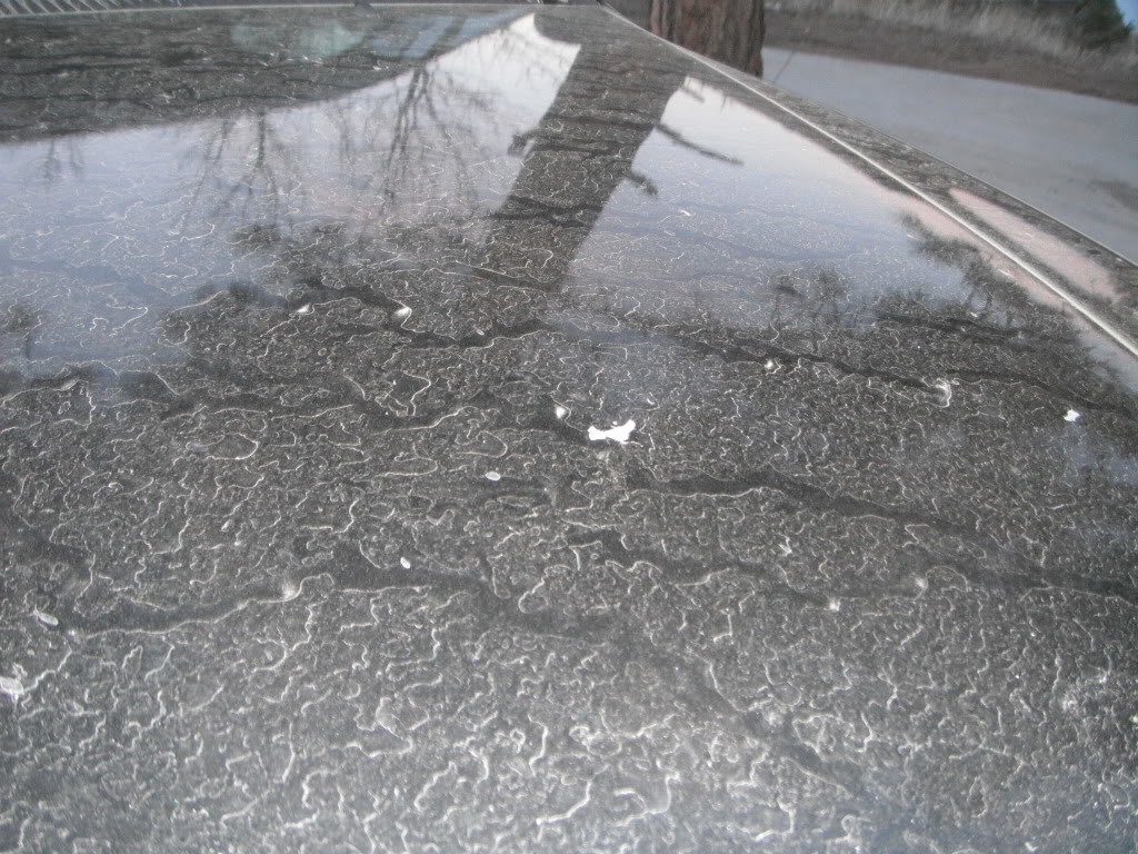

    Okay. Well i was out of town but when it was light out and i could actually see, i did an assesment of the damage. The radatior has some damage. Hood was in perfect condition. And now it has quite a few dents and paint missing on those dents :mad::mad:. I did snap a few pics though.
    Hood dammage. (Picture doesnt show it the best)
    I will be getting a new fan in the next few days. I will mount it and see if it hits anything. Then fill her up with fluids and give her a test drive. Hopefully thats all that needs fixing mechanically.

    It looks like the fan flew apart.
    Yes, a fan could cause a dent in a hood.
    Maybe it's because of the pic quality, but I can't see horrific damage to the radiator. Me thinks your fan delaminated from the fan hub. If the fan had hit the radiator, I think you would have seen a ton of radiator damage and probably would have seen a temperature spike (maybe, maybe not).
    It seems you are doing the right thing (new fan, top of fluids and give her a whirl).

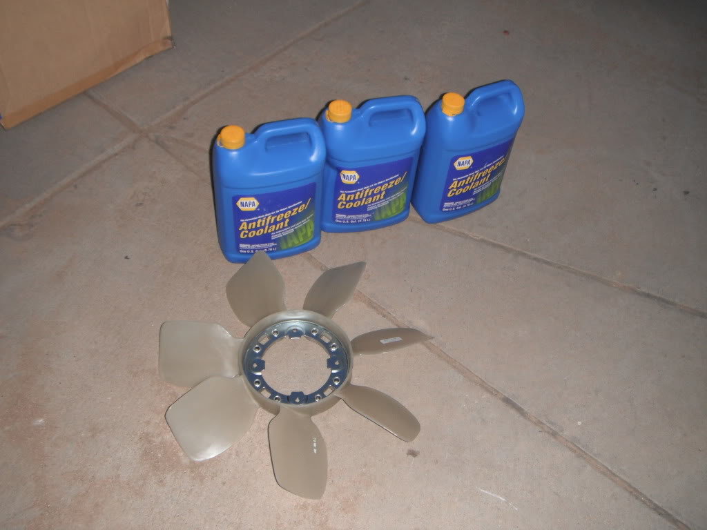

    Got some stuff at NAPA today.
    I installed the fan and refilled the coolant. Started it up and she was running. There was no major damage. Took it for a testdrive and everything was still working. Now it just needs a new radiator shroud. Im just glad it wasnt anything super expensive.
