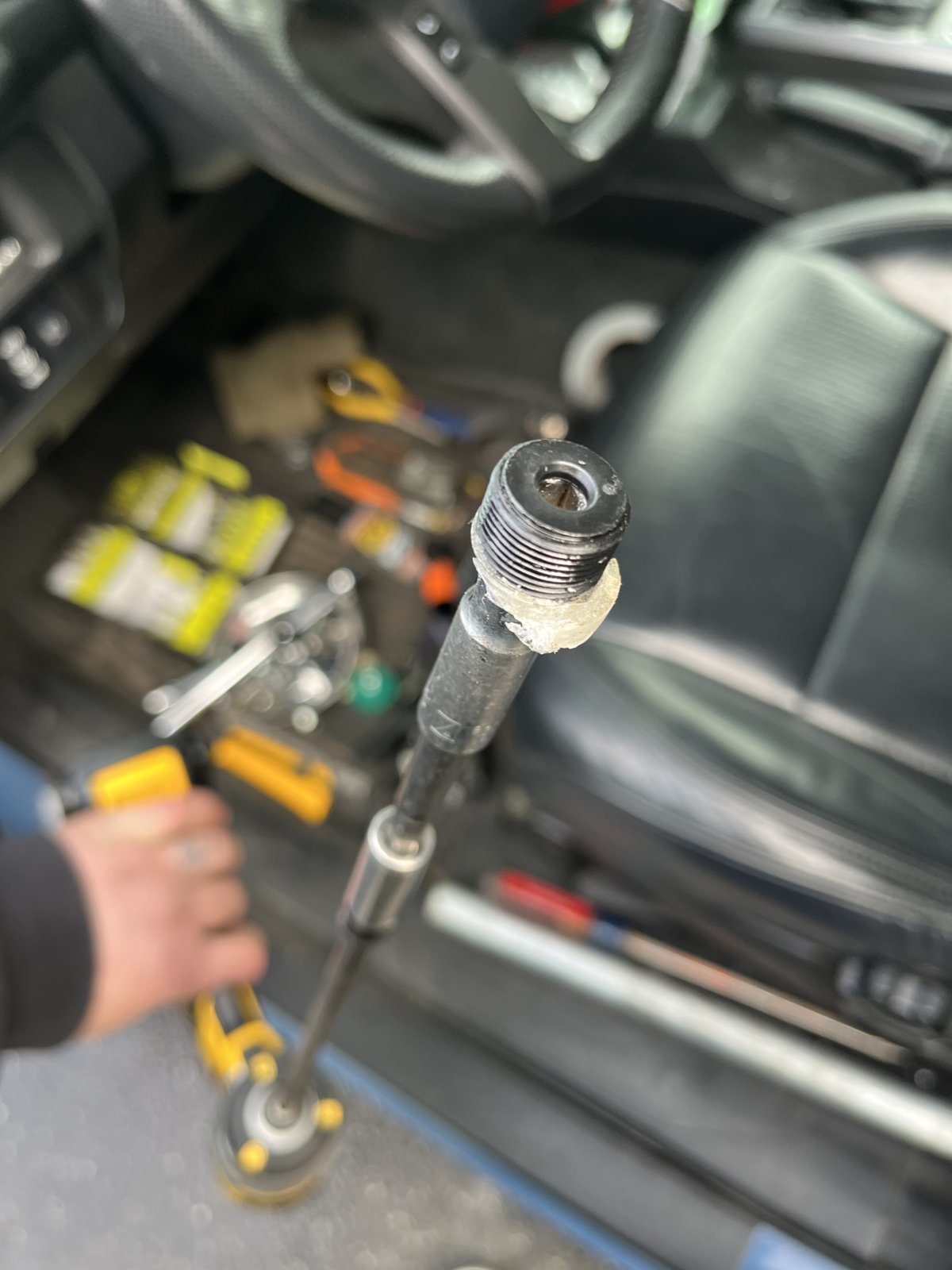

    Was changing out my PCV valve & set torque to 44 in/lb. It snapped anyway. I was tightening from an area where I couldn’t see anything. Also didn’t break in new 1/4” torque wrench. I had a few ideas of how to get it out. I tried using gorilla epoxy glue on the tip of a 1/4” socket. I let it sit for 6 hours and nothing. I tried again and let set for recommended 24 hrs and she came out. Also used my DeWALT XR Impact. My new PCV valve should be here today.
