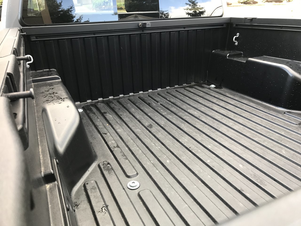

    I just found a broken piece of plastic that comes from the front of the bed at the center by the top (below the sliding window). It appears to hold the tonneau steady, along with the screw. There are two similar plastic pieces on the tonneau and this piece fits between them. Has anyone else had this problem? I've never removed the tonneau but I fold it back at least once a week, and secure the folded sections.

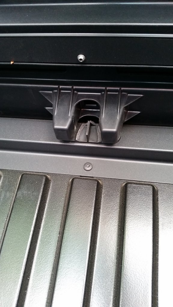

    I've an update. First, The pic shows the broken part I'm talking about. Second, I went to the dealer today and they said they need to order the part, it will arrive tomorrow, and it costs $72. I said, you mean this is not covered under warrante. She replied she would talk to her manager and see what she could do. My truck is less than 6 mos old and I've never removed the tonneau.

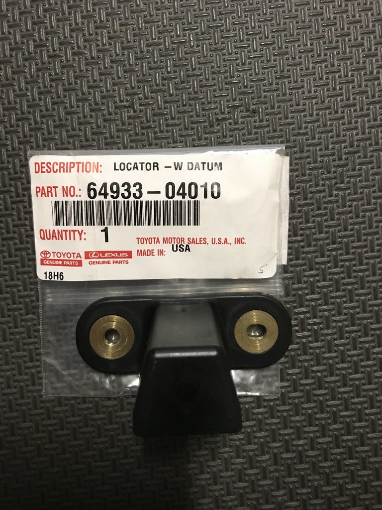

    People in the thread below talk about having bought that piece for like $5 . . .
    https://www.tacomaworld.com/threads/oem-tonneau-cover-install.444415/
    https://www.tacomaworld.com/threads/oem-tonneau-cover-install.444415/page-3#post-15676234
    http://www.sparksparts.com/oe-toyota/6493304010

    Yeah, the same thing got broken off of mine. I doubt it actually needed to support any weight of the cover, I think it just needed for centering the cover when installing on the bed.
    Mine has been broken for a few months now, just been too lazy to go to the dealer to order a replacement (also it might just break off again if I take it on the trail). I might add it to the order when i order a few air filter at the dealer. but it would be crazy if they try to charge you 75bucks for it though.

    Yes, that's what he's saying. The part directly above the pan-head torx screw in the picture is the broken part. The part that juts out toward you like two BOOBS is part of the actual tonneau cover itself.
    The piece pointed out by the arrow directly down from the light at the top of the cab in the picture below is the broken part. The two BOOBS on the tonneau fit over the top of the broken part, to help keep the cover centered on the bed.

    I found the part # here on TW and its a $5.00 part
    I also discovered the bolt securing the cover was not torqued to spec. In fact I could turn the bolt with finger.
    I believe the cover was loose, at some point I hit a bumb in the road and broke said "5 Dollar Penis Part"
