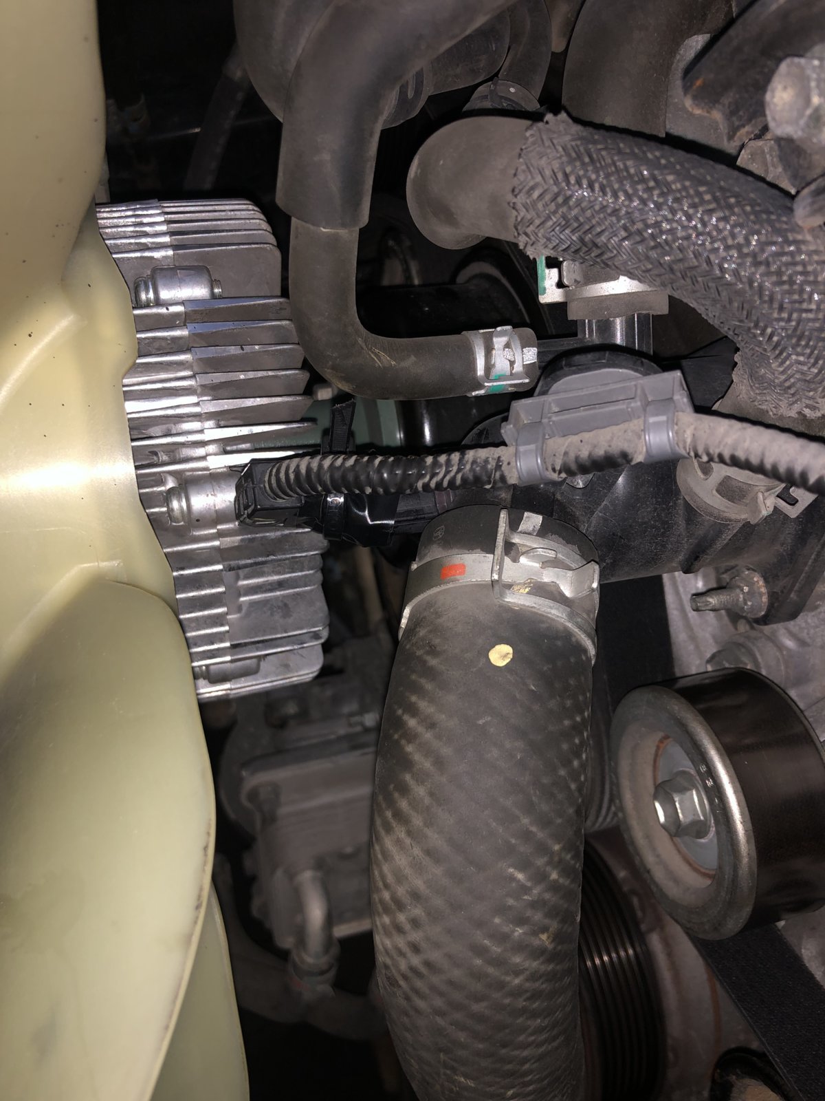

    Need help, changed the serpentine belt today on my Taco and my son while pushing on the tensioner broke the end of the plug that goes into what I
    believe is the Thermostat housing at the end of the radiator hose in picture. Its the black plug that sits in front of the fan. See picture. I put black electrical tape and a zip tie on it but I'm wondering how hard it would be to replace the plug itself? Any help is appreciated. It still works but don't want it falling off.

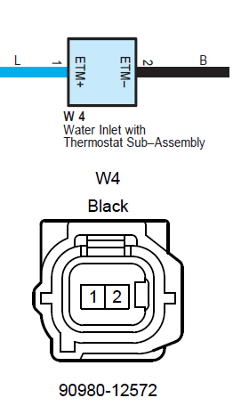

    @caribe makaira - can you help this gentleman with the part # for the connector housing?

    caribe makaira
    caribe makaira Well-Known Member
    Feb 13, 2011
    #51121
    11,811
    Caribbean, Puerto Rico
    05 PreRunner TRD Offroad AutoTrans
    Hood Struts, My version Fogs always ON, Map & Overhead Light Mod,

    @kgilly - now you can order that connector and just depin/repin. Unless you have more going on.

    thank you guys, i will order and give it a shot, hopefully it is easy to do, thanks again. i am hoping it is just the plug part that pushes in, not sure if the receiver end is damaged?

    Just went on OEM Toyota parts direct and it says that part does not fit my vehicle? mine is a 2016, is there another part number for the plug end? thanks in advance!!

    The part number is embossed on the connector. Maybe a fellow Taco owner with a '16 can confirm. Wouldn't want to have your Taco's connector fall apart while you check it.

    If you have a dealer near by drop in to the parts department give them your VIN and they can get you the correct plug.
