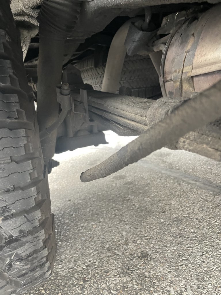

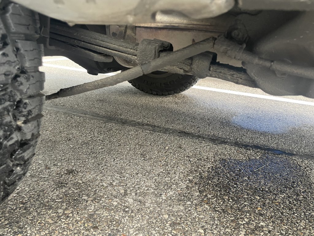

    Ex girlfriend 5’4 blonde 30DD, cut my rear brake line.
    is this a simple replacement and bleed?
    browsing part numbers now

    That's a parking brake cable. You'll have to remove the brake drum and unhook the end of the cable from the shoe's actuating lever. The cable has an aluminum fitting secured to the backing plate with screws. You'll probably need to heat up the screws with a torch to loosen them.
    Given the *stainless steel* muffler is held on with duct tape. Are you sure the ex cut the cable? If so, which of the two did this?

    Thank you, I thought it was regular brake. It’s some fibreglass muffler repair on a hole in my muffler
    does the replacement cable run all the way from the drum to the cab?

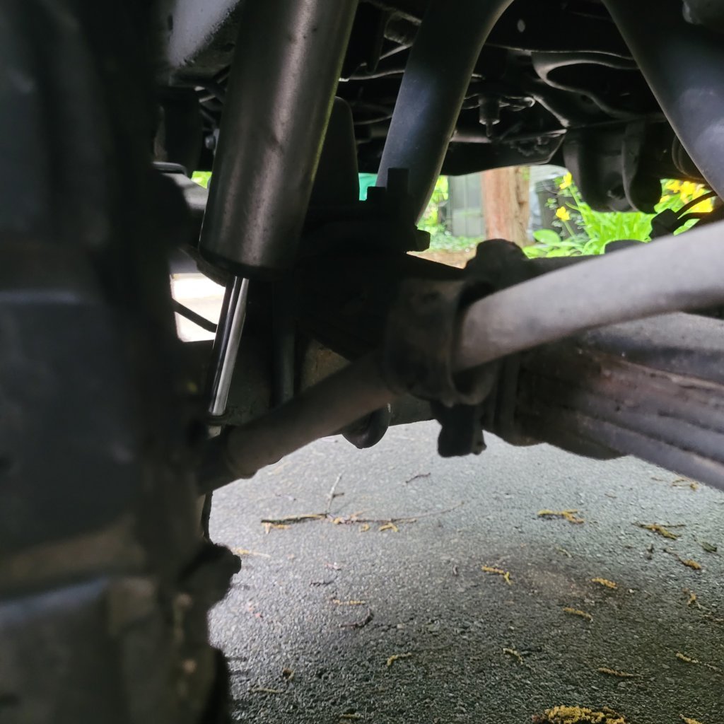

    The angle of the bracket near the axle housing looks off. It looks like the bracket causes the cable to go too vertical, versus guiding the cable towards the front of the truck. This would cause a sharp bend in the cable. It also looks like the cable sheathing is cracked, just rear of backet holding the cable to the frame.
    When I put new leafs on mine, I had to alter the bracket closest to the axle housing to limit the bends in the parking brake cable.
    It is possible that the cable snapped because the bracket caused the cable to bend too sharply. When you had your frame replaced, also possible bracket and cable were routed in a way the put stress on the cable. Something to consider when you replace the cable
    Here is pic of the bracket on mine and the cable routing. Notice no sharp bends in cable.
