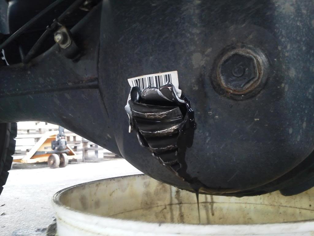

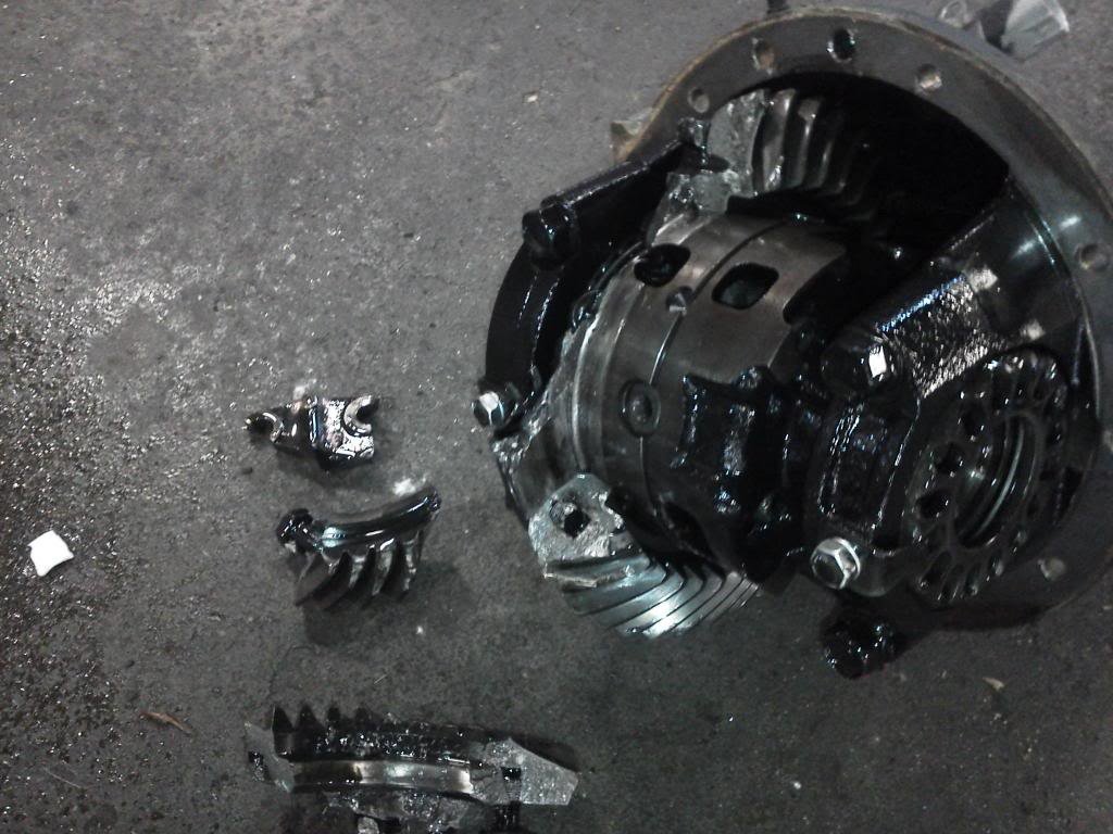

    Basically, when you're in a low traction situation and you get one wheel with traction and the other spinning...
    ...and you give it a lot of gas to try and get free
    ...but the wheel with no traction just starts spinning fast and the rpms increase
    ...and then you bounce the truck or shift position or whatever
    ...and then suddenly the wheel that's spinning with a lot of speed and momentum temporarily finds traction
    ...and then suddenly the tiny little spider gears in the diff have to transfer a *huge* power load across the diff from the wheel that had previously been spinning freely over to the other wheel
    ... which is a sudden jerk-load transfer it was never designed to endure
    ... it breaks.
    So, when wheels are spinning and you start bouncing - let off the gas. Do it sooner not later.
    If you're in a variable traction situation and you're spinning one wheel a lot and you've got a locker - lock it up.

    What bjmoose said. The Toyota Rear end isn't weak, it is perfectly suited for what it was designed to do. It isn't the weakness of the rear end that is tearing them up. It is the abuse. Just to be 100% honest about it. I have been driving a long time and have never torn out a gear in the transmission or rear end of a truck.
    The truck is not or was not designed for 33 - 35 inch tires etc... If you are going to install tires etc and abuse the truck you should beef it up to withstand the mods that you install.

    The factory alloy of the second gen diffs is probably weaker than it should be. It seems a lot of second gens have blown the rear end when they shouldn't have.

    No its seems to be the ring gear everyone eats in situations where they should not have blown up.

    If you want it to be stronger, upgrade to an ARB air locker.
    1. The carrier itself is stronger
    2. You can lock it in a low traction situation, which reduces the chance that you'll end up loading it in a way that forces breakage.
    Ultimately, anything mechanical can be broken. Drive to avoid breaking stuff.

    OK, I can't disagree with you because you are right, but I do think the 8" diff is pretty much the minimum for a stock V6 Tacoma. Compare that to the early Toyota trucks with a similar 8" diff and less than half the available engine torque and a much lighter truck, they were far more "abuse resistant". That said, anything can be shock loaded to failure if you try hard enough - I've seen an 18" ring gear blown into three pieces much like some of the photos shown here, operator abuse was unquestionably the cause.
