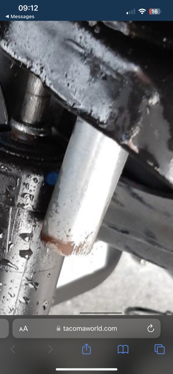

    That's what it looks like from here.

    Check out this lift guide. Your current block set up might predispose you to this early failure. Cheapest would be to just replace shocks but you might run into the same problem later (might be worth it if you don’t want to spend a ton of $$). Or you could get longer shocks/custom leaf springs but that might be expensive. Your current set up is causing a change in the shock travel which led to this failure. If I am seeing this correctly, looks like the shock has already started leaking? Or is it just the shaft extension that has failed? Or both?

    That's right. Don't even need to take the wheel off.

    yeah, that looks like a shock extension. that is a cheap way to extend the shock. i wouldnt run that, along with at least 75% of the members on here.
    post a picture of your rear block. im curious how big it is.
    you can run the 5100.....but they are also rated for a specific height. they make them for 2-3" lifts 3-4" lifts etc.

    I have seen a lot of crazy shit in my day... but this is a first!!! A shock extension!!!
    This makes Rough Country look like top tier lift equipment!!!

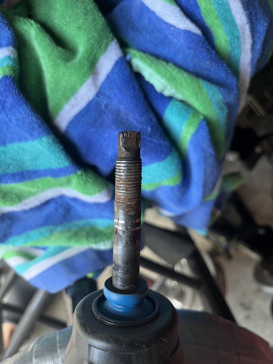

    Got damn hitachi crap. Out with those and put the bilsteins on.

    They are cheap! I repeat. Replace the hitachis ASAP if you don’t want any issues. Stripped shock bolts when removing the rusted nuts. And rubbing on the shock reservoir, proving the shocks are pre-defective.

    Trying to figure out what this is.. if you look more at the pic.
    What is the steel hollow looking rod attached to the bottom of the strut mount area? I just changed my shocks and didn’t that there. Is that for a lift or something? To my knowledge this is not part of the shock absorber…

    I think that is the extension part. I'll find out here in a few.

    Take that thing off and put the strut bolt in where it’s supposed to go. It’s ruining your nice truck. Did you buy it that way?

    Tell them to peel that shitty "lift" off and return your hard earned money. If they want to replace w the same crap,, I'd just look at getting a real lift.

    It'll be interesting to hear whether they cover it "under warranty," clearly the stock shock absorber configuration was modified w/ aftermarket parts which caused the failure.

    factory installed lift. didnt know better at the time. Here now. looks like its covered. trying to negotiate Bilstein's. We'll see. waiting on manager. I'm freshly divorced so no new lift is in the plan right now. ex has all my available funding, haha. maybe for Christmas.
