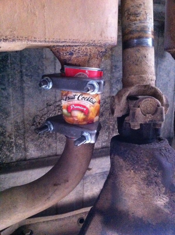

    Zip tie?! Someone is messing around with your safety if they are willing to do shoddy repairs like that to your truck. Hope you reported it to Toyota Corporate and to their regional service manager. I had an inept service mechanic leave my plates barely attached because they couldn't line up the holes after a oil change- I found their oil filter wrench wedged between the plate and oil pan when I got home and was able to secure the skid plate as normal after that... Sometimes, nothing is more frustrating than expecting a good repair job! :p
