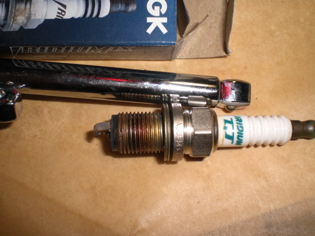

    would this work
    I mean asking if this is yur preferred E tool?

    Hmmm

    what tube?
    The hex head is gone, that will not catch anything.
    What's left of the plug base is full with the threads of the plug.
    Countersunk persay.
    Thats a great tool though...

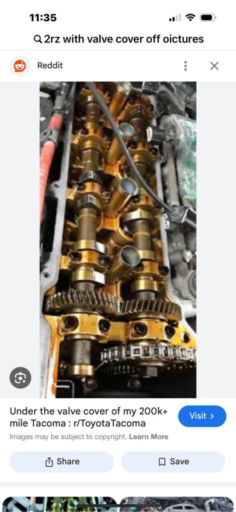

    I searched my 2rz ‘rebuild’ pix and I don’t have a single one with the V cover off
    (Probably off dozen times)
    Internet pix (meh) shows steel tubes with valve cvr removed

    Shit
    Unless design changed from my old ass 96
    Ugh.
