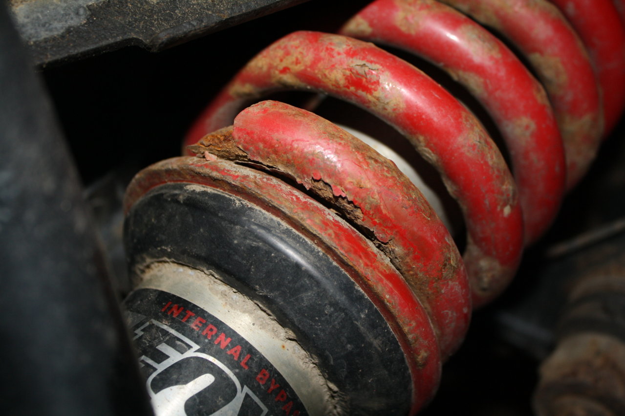

    IMG_5703.jpg broken springs on my 2017 pro.. also, do your self a favor and get adjustable ones. i also had a 2015 pro for 2 yrs. it had bilstein's on it ?
    just found this on my 2017.. see photo, gonna replace them with these. reservour's for me,
    PM sent
    https://www.headstrongoffroad.com/store/p51/Fox_Factory_Series_2.5"_Coilover_with_Reservoir_-_Standard_or_Extended_Travel_-_05__Tacoma.html
    or these
    https://www.headstrongoffroad.com/store/p49/Fox_Factory_Series_2.5"_Coilover_Kit_-_Standard_or_Extended_Travel_-_05__Tacoma.html

  11. May 31, 2020 at 12:29 PM
    EIOi352
    EIOi352 [OP] Member
    May 30, 2020
    #329843
    12
    2015 White TRD Pro/ auto trans
    Wow!!
    that's bad.
    Thanks for the sites
