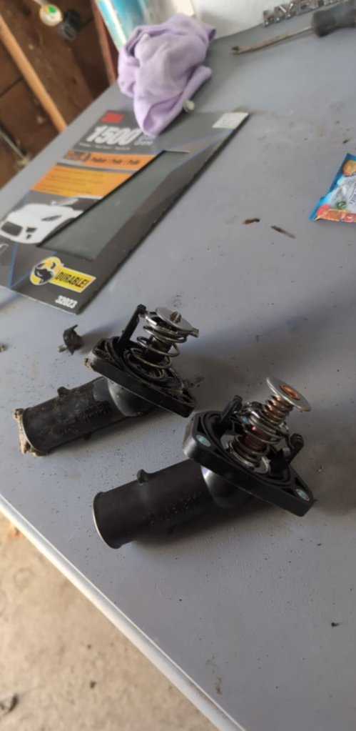

    Hi 2gen club ! The 1gr-fe question is... Where is my broken finger ?
    At the end of the summer i notice a little crack that finish in one of the 3 bolt hole so i decided to replace it ( Now i understand why URD sell a Metal housing upgrade) anyone here experience this really bad situation ?
    I try to figure out where it most probably stuck but for sure i will need to open water pump to see if the impeller still has good blades and bearing. I have a big thought that the finger isn't stack in the water pump cause it spin really well without any strange sound.
    Motor does'nt heat but temperature tends to be a little high when idling (92 celcius or 200 Farheneight )

    It can be anywhere in the cooling system, I wouldn't be too concerned about it.
    It certainly isn't gona hurt the water pump, the impeller is steel and is pretty stout.

    What URD Metal Tstat
    Never heard of it
    my plastic lasted a long time and is easy to change.
    not sure what you mean by 200F is high. That is probably not high. Gas engines typically run at 190-220F by design.

    It is kinda elevated for a 2nd gen unless your in 100+ degree weather, 2nd gens run a 180F thermostat. Mine runs around 178-195 depending on how hot it is outside.
    Could just be a shitty thermostat if it's not OEM, I've not had very good luck with aftermarket thermostats on alot of stuff lately

    The metal ones are a waste of money,as the factory ones last a LONG time.
