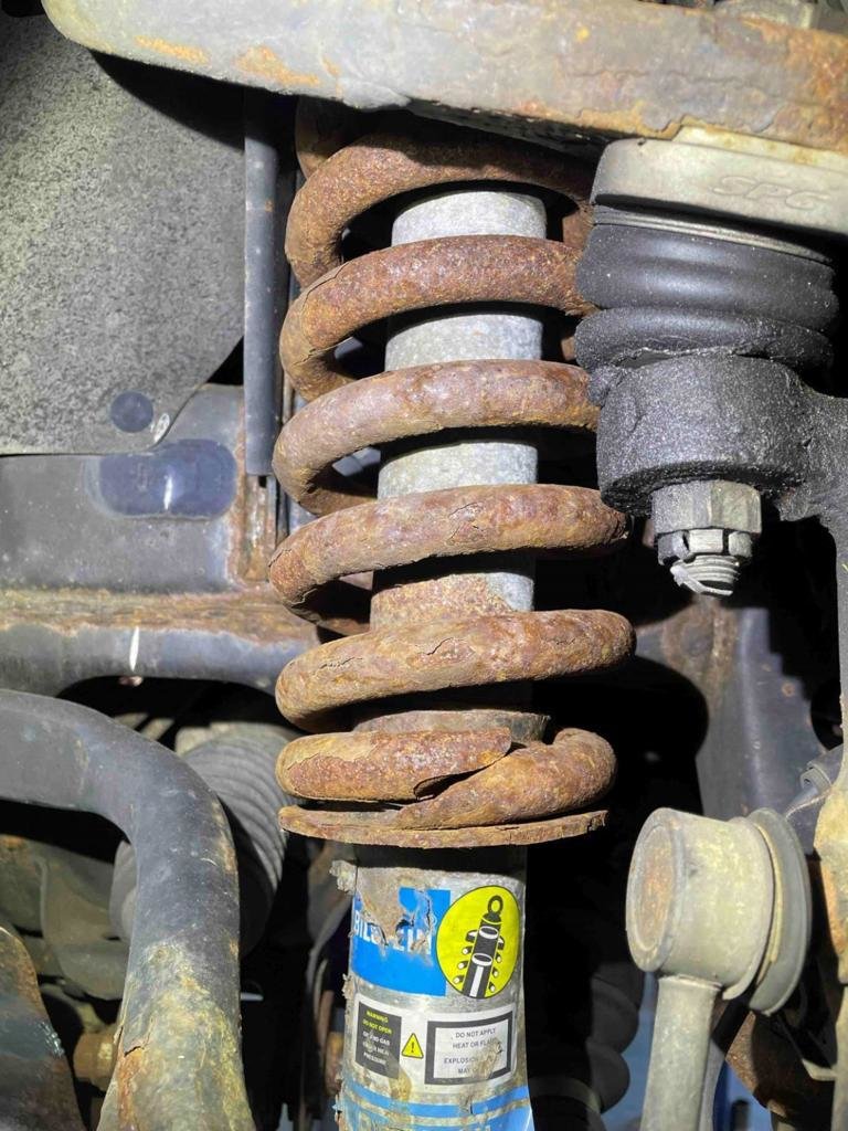

    Took my truck for an oil change and tire rotation. The shop saw that the left driver side spring is broken. The shop owner said it’s not an immediate safety concern but this does not look good. I’m going to replace it (can’t put a price on safety) but what do you all think? 57FD36FE-93E8-47B1-B0A5-699265727999.jpg

    Due to where it broke and you not knowing it was already broken, I'd say if you have to drive around, drive around - cautiously. Those are pretty rusted out though, definitely due to be replaced - probably the shocks as well.

    It's probably not going to fail catastrophically right away, but as it's a critical suspension component I would try not to drive the truck too much and replace it ASAP.

    Not a safety concern?
    You would fail a safety inspection for that.
    It will drop that side and potentially throw off the alignment reducing steering traction if it’s in the front
    I would replace the whole unit
    That shock body looks beyond saving with that amount of rust

    Guys, I’m gonna replace the shocks (Bilstein 5100’s) and coils. I don’t want to risk driving 7+ hours down to DC. While I have you here, seems the popular opinion is to indeed get them replaced. I trust my mechanic (been going to him for 6+ years) but I think I’m gonna go against his better judgement on this.

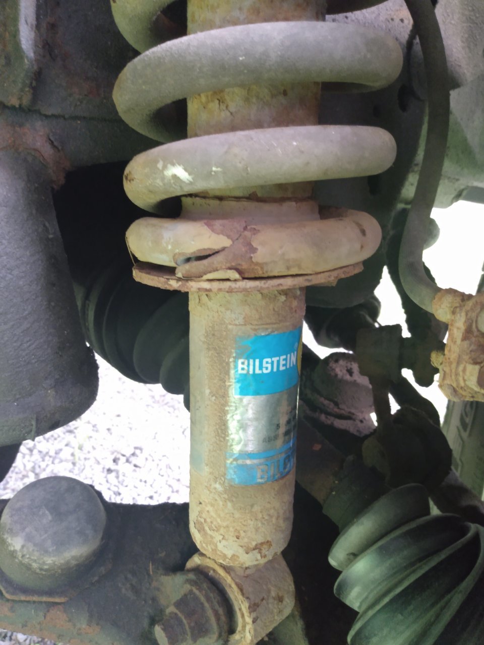

    That looks identical to mine 3 years old and around 20000km . I'm thinking the eibach\toytec springs are garbage.IMG_20220629_190612545.jpg

    They are
