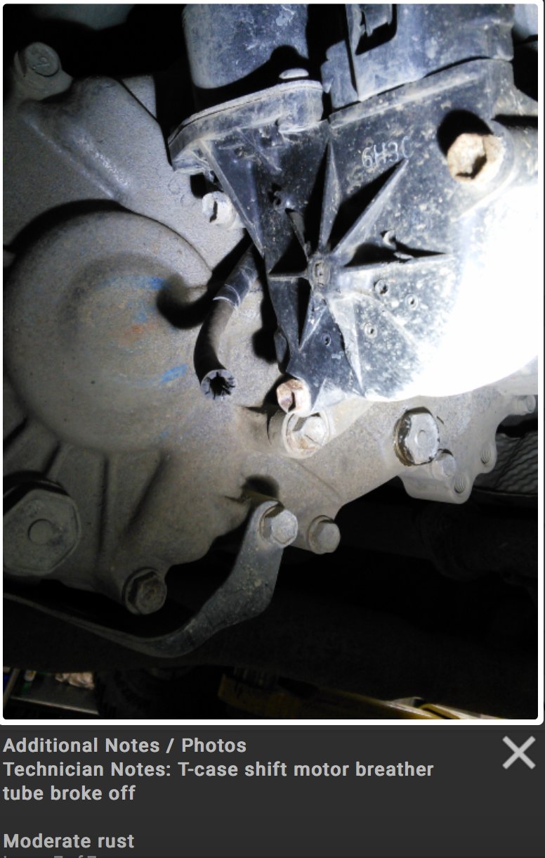

    Anyone have any ideas on how to fix the broken breather tube on the transmission actuator?

    looks like you need more than a hose

    Yea thats what I was thinking about using...Thanks. Anyone know if you can pull the black cover off without removing the entire actuator? It doesn't appear that it would be easy.

    Don't pull the cover without fully understanding what you are doing as you may get the tcase drive unclocked and it can be a real pain to reclock. That may be why the FSM is silent on the matter. There are a number of threads here and at TTORA that have discussed this. I don't find the search function for this site very good and have overall better luck y google searching..
