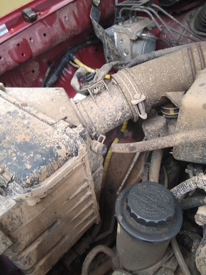

    While doing the Deckplate mod I noticed my hose was cut/rotted/broken. Have no idea since when its been running like that, the car didn't have the Check Engine light or anything.
    After I finished doing the mod, I removed the broken piece from the intake and just stretched the current hose to the nipple (Plan or replacing this soon).
    As soon as I started the car the check engine light came up and the engine is running rough.
    Wondering if the Canister went bad since it was not connected to the intake and when I connected it picked up it was bad?
    I finally found my OBDII scanner and will check what it's picking up. All symptoms point to a faulty "Canister Purge Solenoid", I just find it weird that it was picked up until after I connected it.
    Let me know what you think! (Pardon the dirty intake/engine, its been raining like crazy lately).
    Thanks.

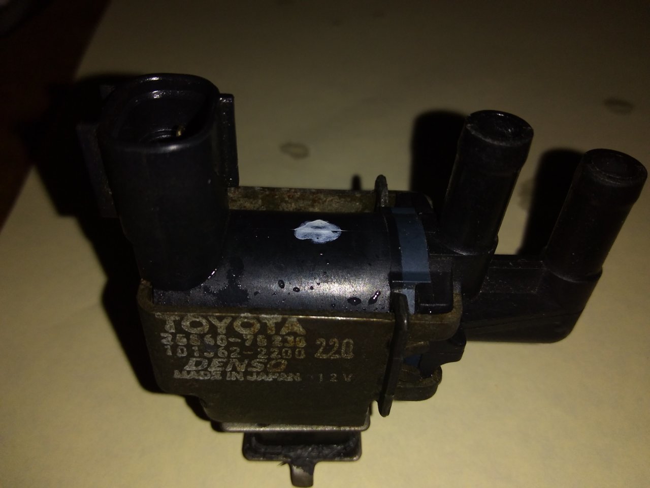

  2. Dec 26, 2019 at 5:56 PM
    Black DOG Lila
    Black DOG Lila Well-Known Member
    Jun 14, 2019
    #296344
    9,116
    Virginia
    2003 Tacoma SR5 2.7 5 speed 4WD
    Stock. EZ pass.Dump pass.Inspection sticker.Convict printed lic.plates.FG cap.
    Probably got dirt in the purge selnoid. Take it off and blow it out.IMG_20191023_224059219.jpg

  3. Dec 26, 2019 at 8:29 PM
    Glamisman
    Glamisman Well-Known Member
    Oct 22, 2016
    #200436
    4,762
    more than likely the charcoal canister has not been purged of the store vapors and your re-connection is now pulling more than normal... I would check the line for liquid too.

  4. Dec 27, 2019 at 11:10 AM
    Smendez31
    Smendez31 [OP] Well-Known Member
    Jul 8, 2018
    #258698
    120
    San Diego, CA
    2003 Impulse Red Tacoma, DC, V6 4x4, TRD
    OME 3" lift kit (883 springs) Magnaflow 1125 Spidetraxx 1.25" wheel spacers
    Not sure what the function of the canister is but yes, Logic tells me that dirt/vapor accumulated at the canister since there was no vacuum. After I reconnected it, it might be pulling all of it in.
    In case that the canister hasn't been purged, should I replace it or can I clean it? I will be installing a new hose today.

  6. Dec 27, 2019 at 11:41 AM
    Dirty Pool
    Dirty Pool FLIES ON THE FRIES, KETCHUPS WATERED DOWN
    Mar 24, 2013
    #100471
    2,311
    59.4 Miles, 56.67° NE Of Moab
    99 XCAB V6 MT TRD
    Dirty Pool rear bumper/air tank with integrated spare CV shaft storage, DP customized TJM front bumper, 8000 lb Ramsey/Technora rope, E-locked, Extended breathers with front diff catch can, PCV catch can, SAWs with DP heim joint seals, DP custom 6 leaf rear springs/Billies, DP custom skids, 2lo, Gray wire, Cap, Bed Rug, Black steelies, 01 Center console, Map lights, Disraeli gears
    The purpose of the evap system is to contain/filter/burn evaporative vapors from the fuel tank.
    Your broken line is the "fresh, filtered air inlet" for the system, it is not a vacuum line in any way. The air in that line travels from the air box to the charcoal canister. The "vacuum" that drives or pulls the "fresh" air through the system is the line at the top/rear of the intake manifold just downstream from the throttle body.
    The function of the system would be 100% unaffected if connected to the air box or not.
    Not connected, could certainly allow water/debris to enter the system causing illness to the purge valve, check valve and/or the media itself. Best guess is this is the issue.
  7. Dec 28, 2019 at 6:19 PM
    Smendez31
    Jul 8, 2018
    #258698
    120
    San Diego, CA
    Thanks for the information!
    So, first thing I did was connect my scanner and the MAF was not being read, checked the connection and I t was just loose. :rolleyes:
    Thanks everyone!
