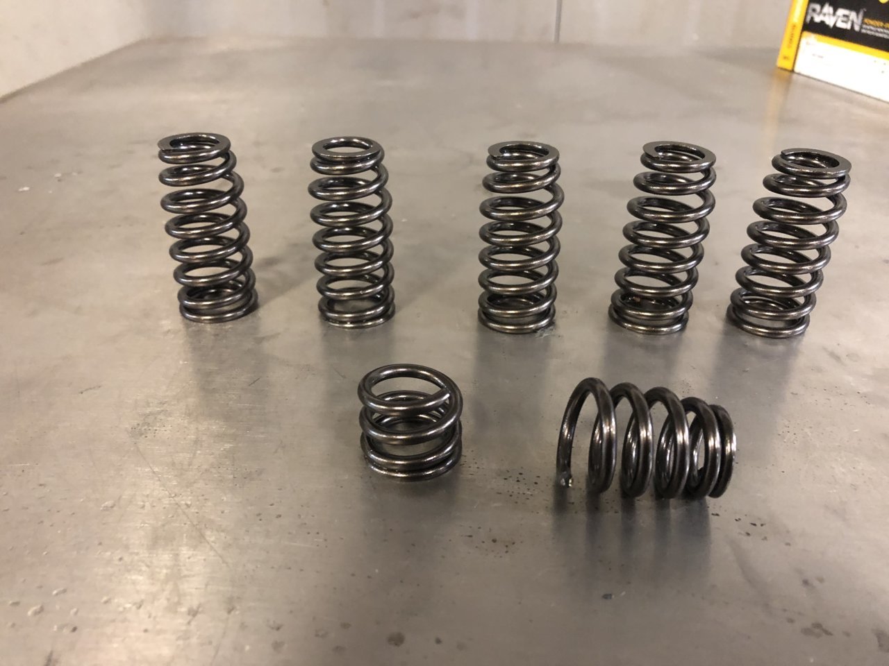

    Failure: One "cracked" exhaust valve-spring on #2 cylinder
    This occurred while coasting down-hill on my way to work. They stated it was cracked during diagnostics, but when removed it fell apart into two pieces as shown in the attached photo. This occurred right at one month of ownership, and 1800 miles on the odometer. I purchased the truck new of course, with 10 miles on the clock.

    Repair Applied: Replacement of all six valve-springs in #2 cylinder.
    Would rather they had taken a more modular approach such as replacing the head for cylinders 2, 4 and 6 to minimize potential human error and allow quicker turn-around, but was not the case. I am requesting an extended warranty from Toyota given the method of repair taken.
    Picked the truck up on the 23rd. So far it is driving great with no issues.IMG-2986.jpg

    This is not Toyota's first rodeo with valve springs. They performed a full on safety recall 10 years ago with some Lexus vehicles. Could be material or bad manufacturing... hard to tell much by examining the above picture. Maybe they skipped the shot peening.... LOL! Lexus claimed bad material years back...

    I had the same issue with less then 500 miles on my truck. They did end up extending my factory warranty after repeated polite complaints. My dealership claimed that the valve spring retainer was not properly seated when the valve train was assembled.
