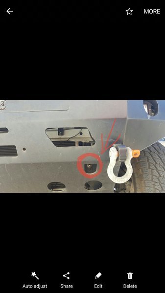

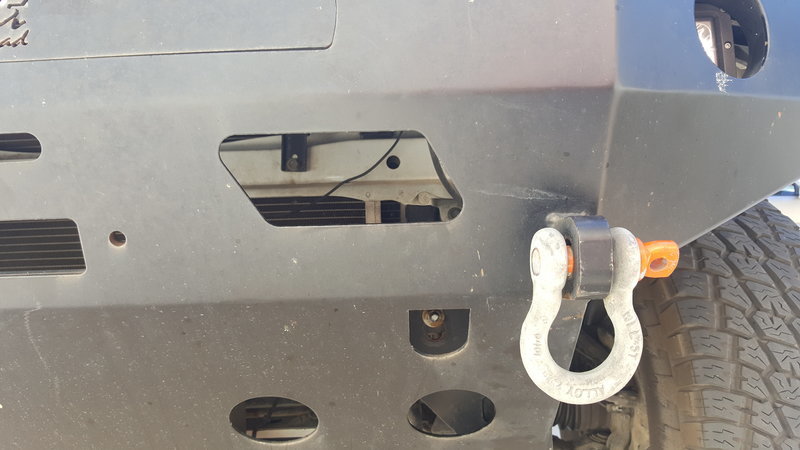

    I just noticed that the tabs that hold on on my Pelfreybilt steel plate bumper on are cracked at the welds. Does anyone know a place in San Diego CA or Near Oxnard Ca that does fabrication/welding to fix this? As you can see, the weld is cracked almost all the way through. There are essentially only two bolts holding the bumper on, 1 on each side. Help please

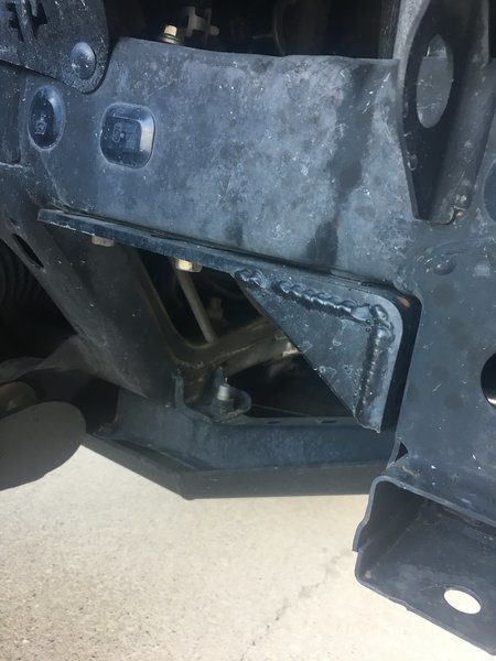

    I'm getting these from SOS Concepts @EddyRRT
    http://sosoffroadconcepts.com/weld-on-frame-brace/

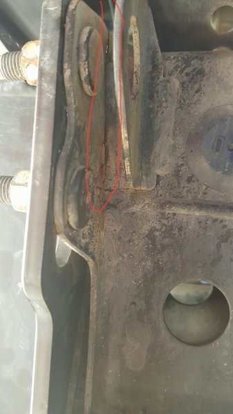

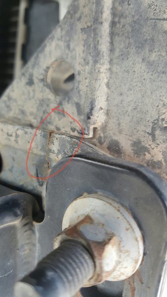

    Yes i bought the truck used....There are 3 attachments on each side from what i can see. Those 2 and one on the inside that you have to use an extension to get to. So a total of 6 but only two are really holding it on from waht i can see. The crack isnt all the way through but its still bad. There is one on each side that would need an extension to get to. Take a look

    I think you're missing another support that goes on the sway bar bolts to the bumper

    Looks to me that it is actually the tabs on the truck's frame that are cracking there.
    Also looks like there was a gap between the truck frame tabs and the bumper tabs, so when the nuts were tightened down, it bent the tabs on the truck frame out to the bumper. Probably should have had some kind of spacer in there.

    Yes there is a gap in there almost to where the bumper can hand down alittle putting stress on those welds. After time i guess i just couldnt take it anymore.

    It appears you are missing the reinforcement brackets that tie the bumper to the frame. The little flange that the bumpers attach to are simply not enough to support the bumpers, especially under winch pressure.

    I meant these brackets

    Added support to bumper
