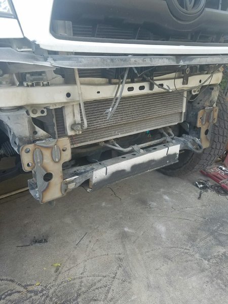

    I just picked up those brackets that you pictured and are they just strictly bolt on?
  3. Oct 17, 2016 at 3:35 PM
    #23
    Jamart5
    Jamart5 HoeRunner
    May 19, 2014
    #130181
    9,137
    Juan
    SETX
    '16 4Runner TRD
    The ones from SOS or Pelfreybilt?
  4. Oct 26, 2016 at 2:03 PM
    #24
    Solution.45
    Solution.45 [OP] Well-Known Member
    May 31, 2011
    #57544
    325
    Chase
    Redding CA
    2011 White 4x4 double Cab
    Sorry for the delayed response man but i picked up some brackets over at pelfreybilt from @Socalduckslayer and had @jeffz0rz replace the Factory frame ends where the bumper attaches with 3/16 steel plate. So with the brackets and Jeffs welding it came out super sturdy. Couldn't be happier.

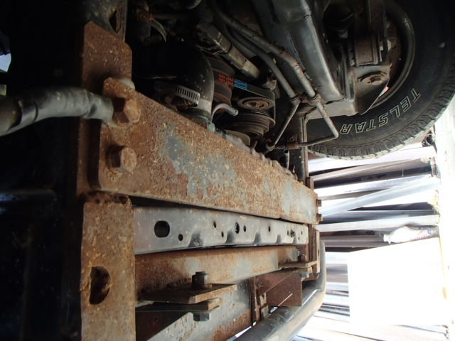

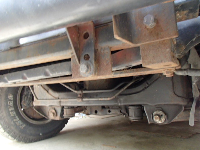

  11. Oct 29, 2016 at 8:55 AM
    #31
    Wyoming09
    Wyoming09 Well-Known Member
    Apr 24, 2015
    #153833
    14,277
    New Tripoli Pa
    2000 Work truck 5 speed 4x4 3.4
    Super Springs
    002.jpg 001.jpg 001.jpg Now just remember this is not the same Bumper but the truck side is the same .
    I did this one day in a hurry and really have not changed anything in a few years
    The first picture is laying down looking left to right the bolts you see are where the tie downs or Hooks mount
    Then a piece ties those bolts and the weld nuts I installed in the piece I welded to the front of the frame .
    I wanted things to take a good pull from the front and still be completely bolted fast to make removing easy in case I decided to change bumper designs or install it on another vehicle.
    Jamart5 likes this.
