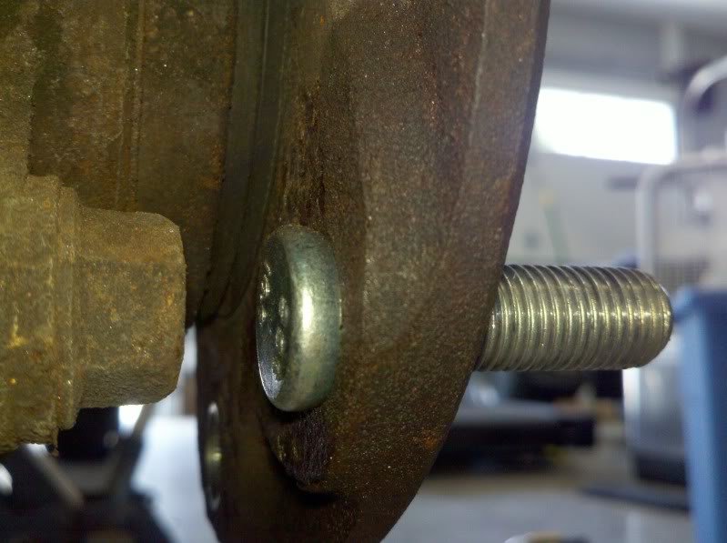

    Now I just need to figure out if I have the stud pushed in far enough through the back of the hub. Let me know if this looks good

    Looks good to me. How is it compared to the others? Get a couple of washers, put them on there and a nut and screw that bastard in till it goes no more.
    FYI - You're going to need 2 pairs of vice grips to get the calipers back on the rotor.
