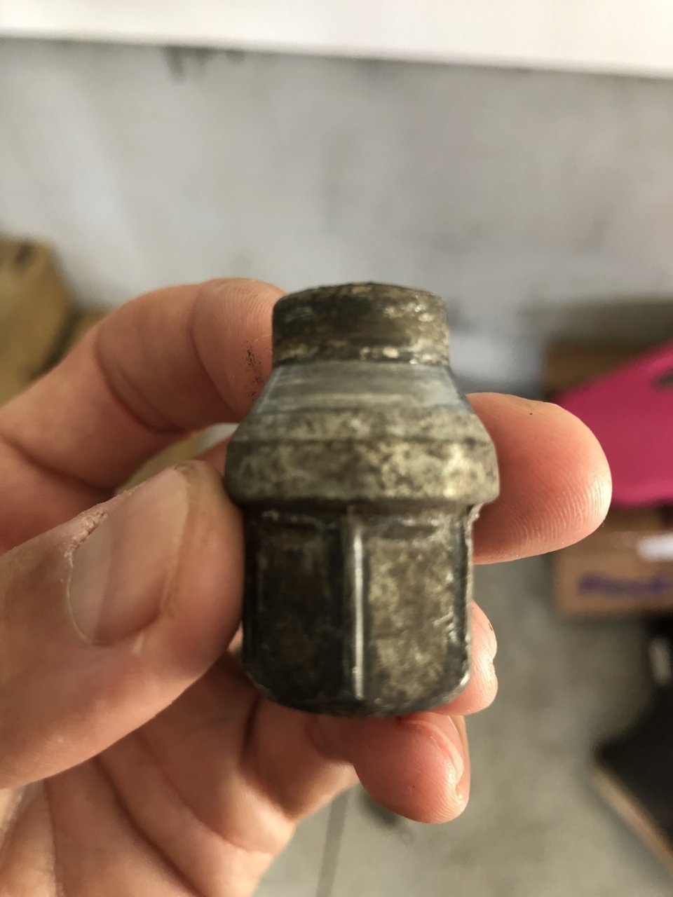

    No the wheels are Method NV305, the lug nuts look like this:

    Well........ you're still safe on 5 lugs until you can get a replacement.
    As long as you are not hooning in 4wd off road somewhere. :D

    No, but the realization that I’m probably going to have to buy a whole new set of lugs is settling in…
