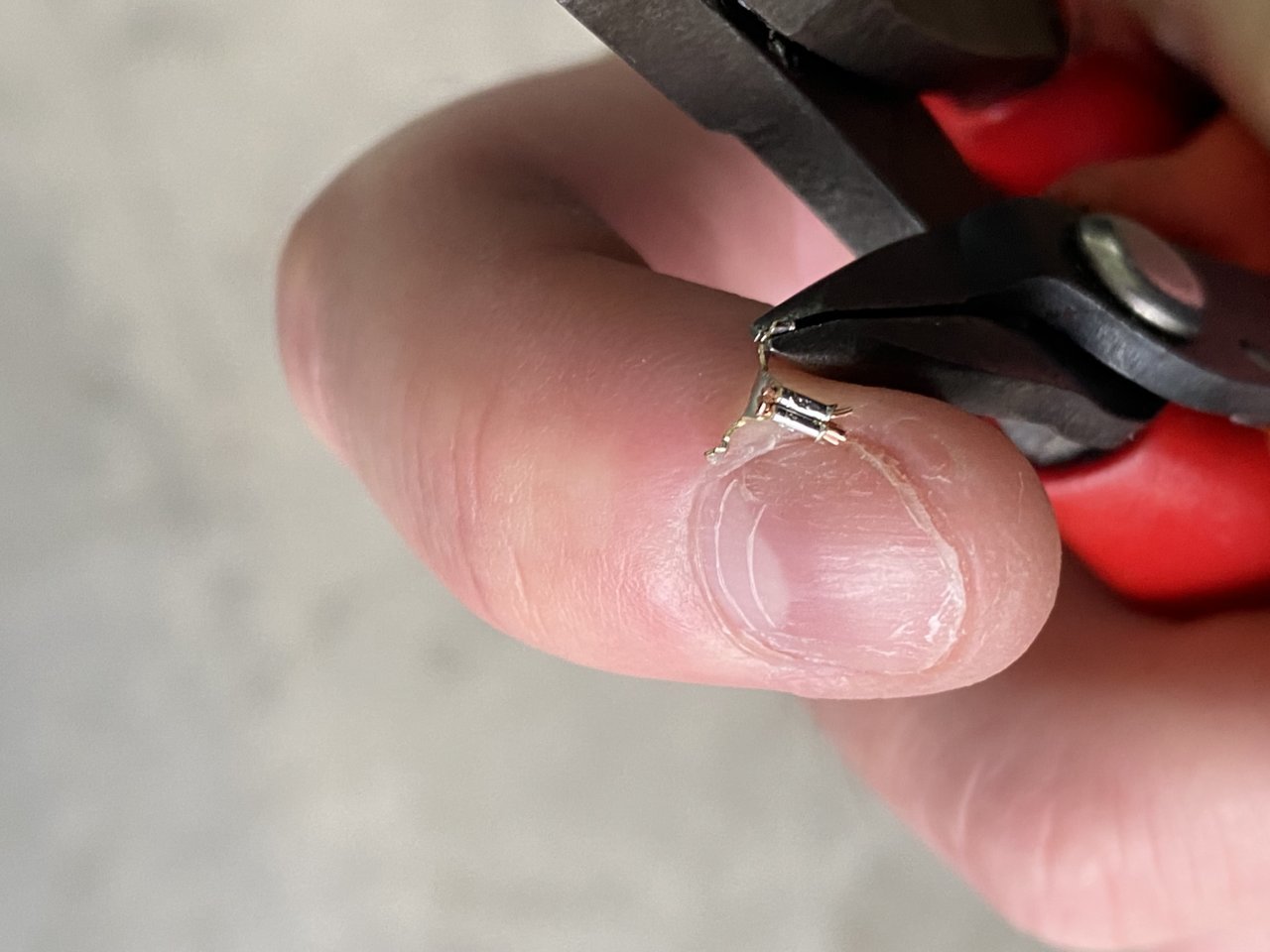

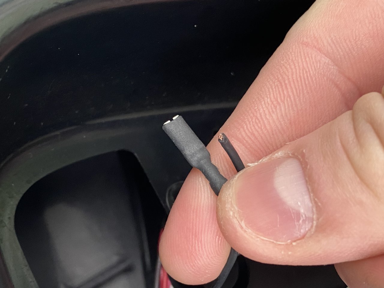

    Hey Y'all
    In the process of swapping the stock mirrors for the Rav4 mirrors with integrated blindspot mirrors, I accidentally snapped the female spade terminal right in half on the wire.
    I'm not sure how to find what the Part Number of the spade terminal may be nor where to find it.
    TIA!

    I done the same thing. I found the spade clip at autozone. Make sure you cut the shrink wrap off of the connection before trying to remove the spade clip . It will slid off easily. I went with spotter mirrors.
