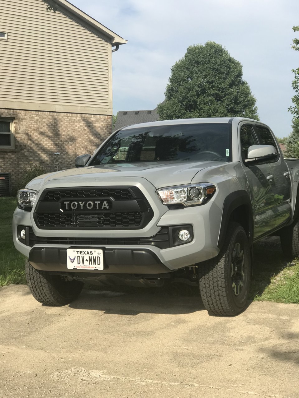

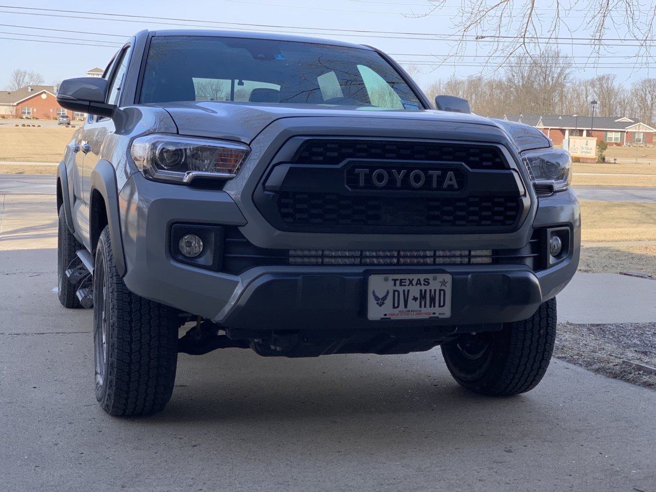

    (Jul2018) of course the very first thing to go was the grille. Added a TRD Pro grille
    Also added an @CaliRaisedLed lower bumper hidden LED bar. Of all the things I put in, this ranks up there as one of my favorites. Super bright and clean install and don't have to worry about parking lot bandits stealing your stuff. :)

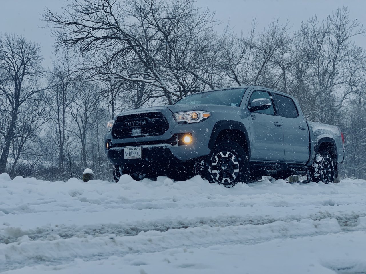

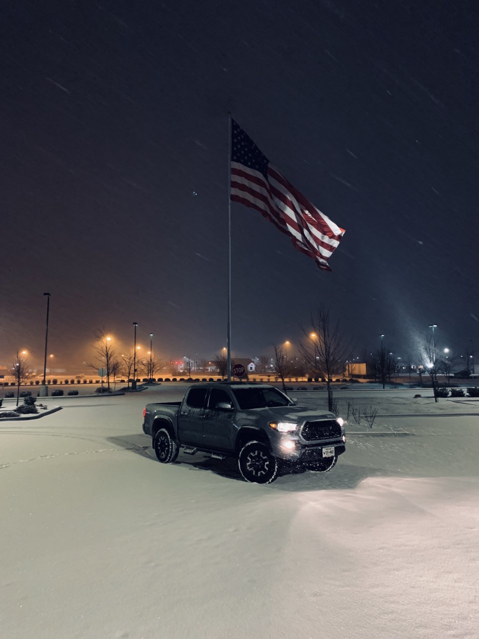

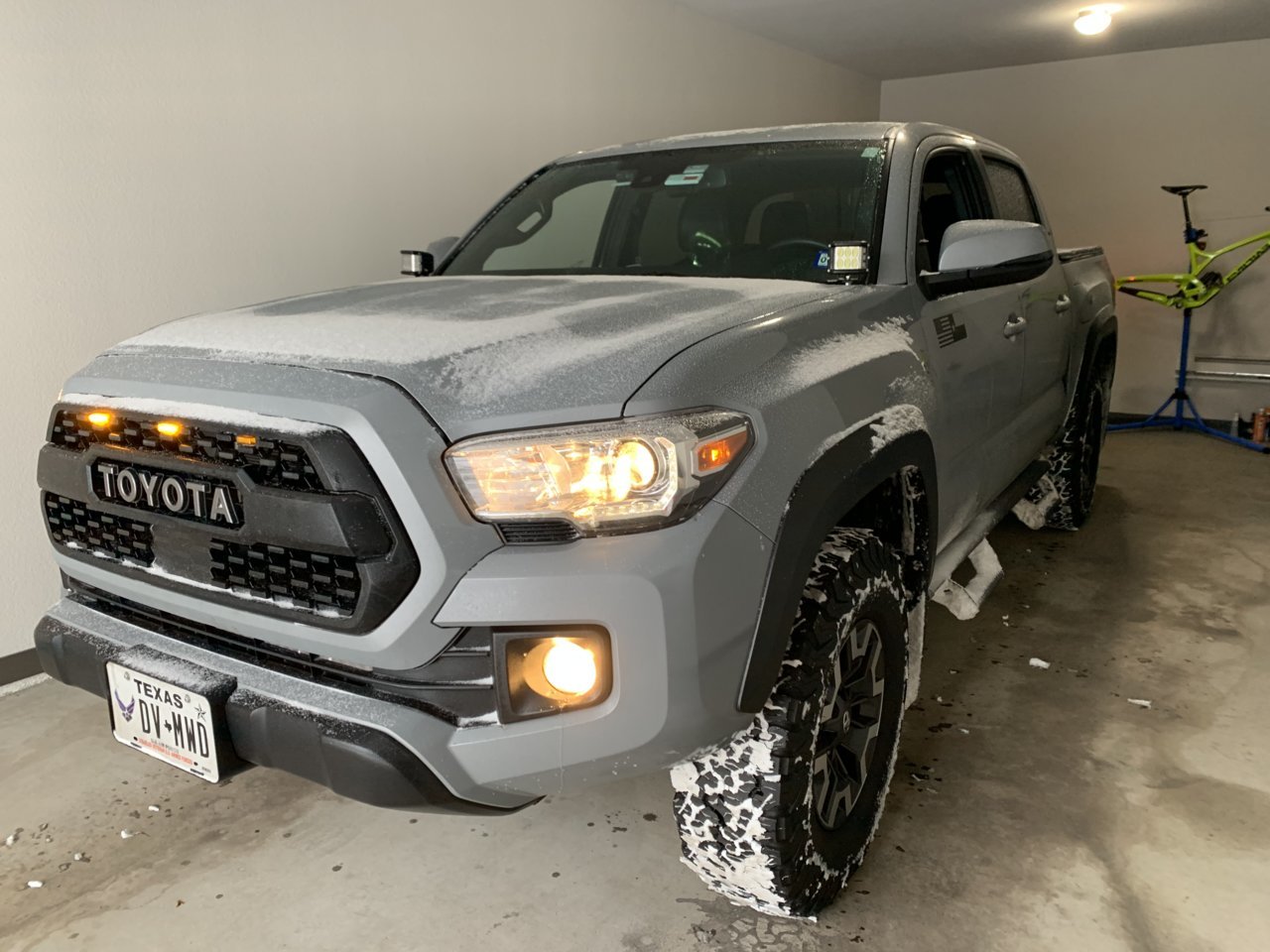

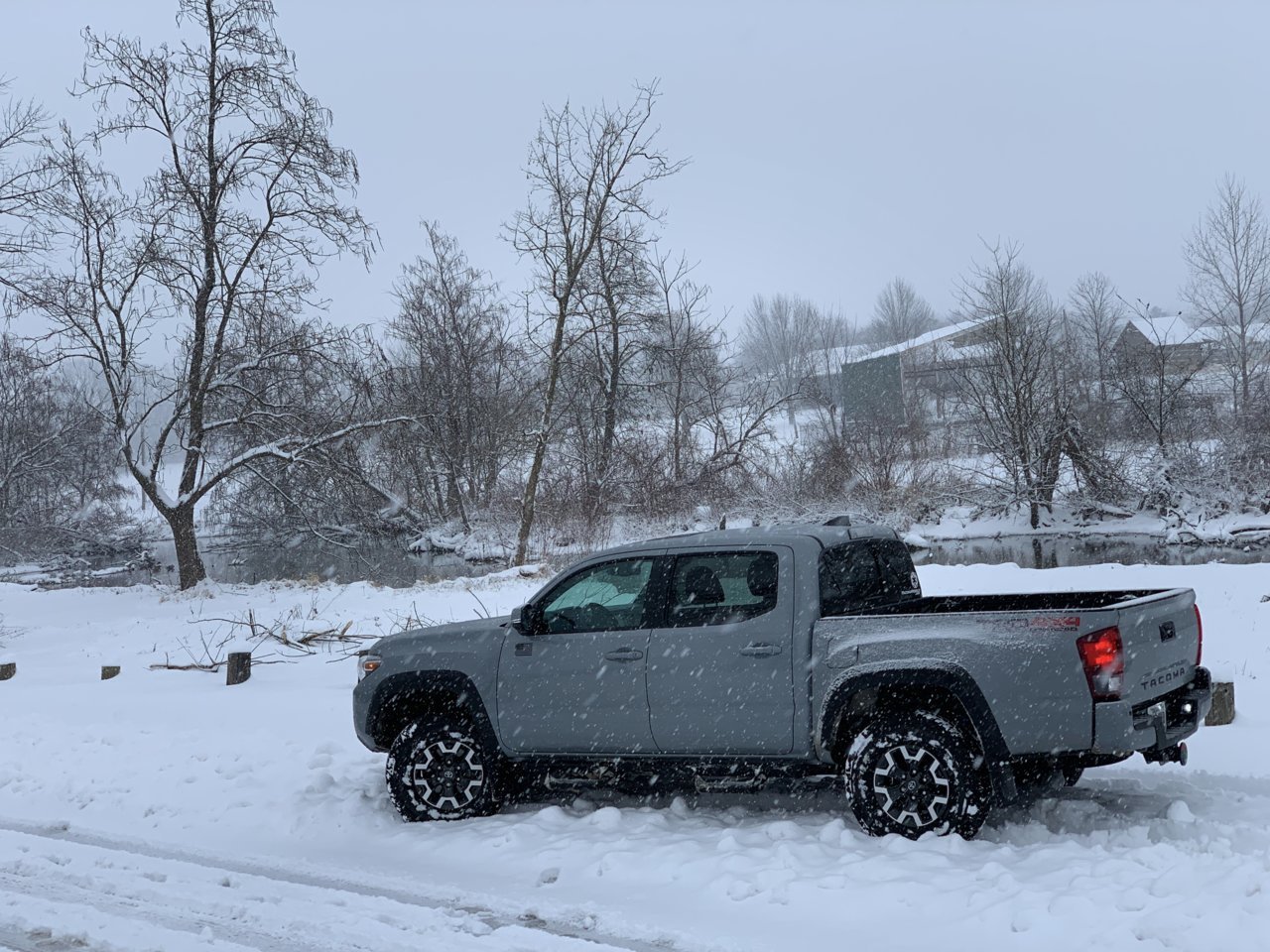

    (Dec2018)First snow day:
    'Merca

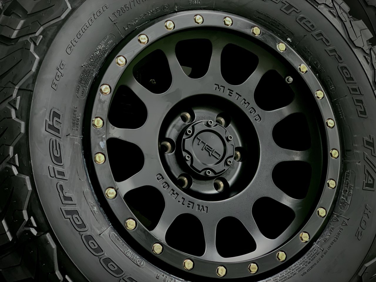

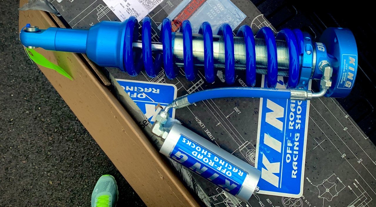

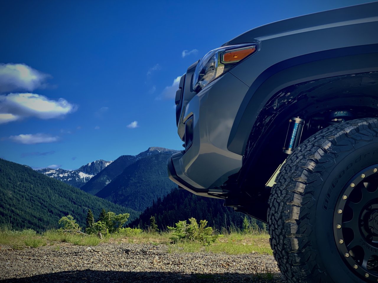

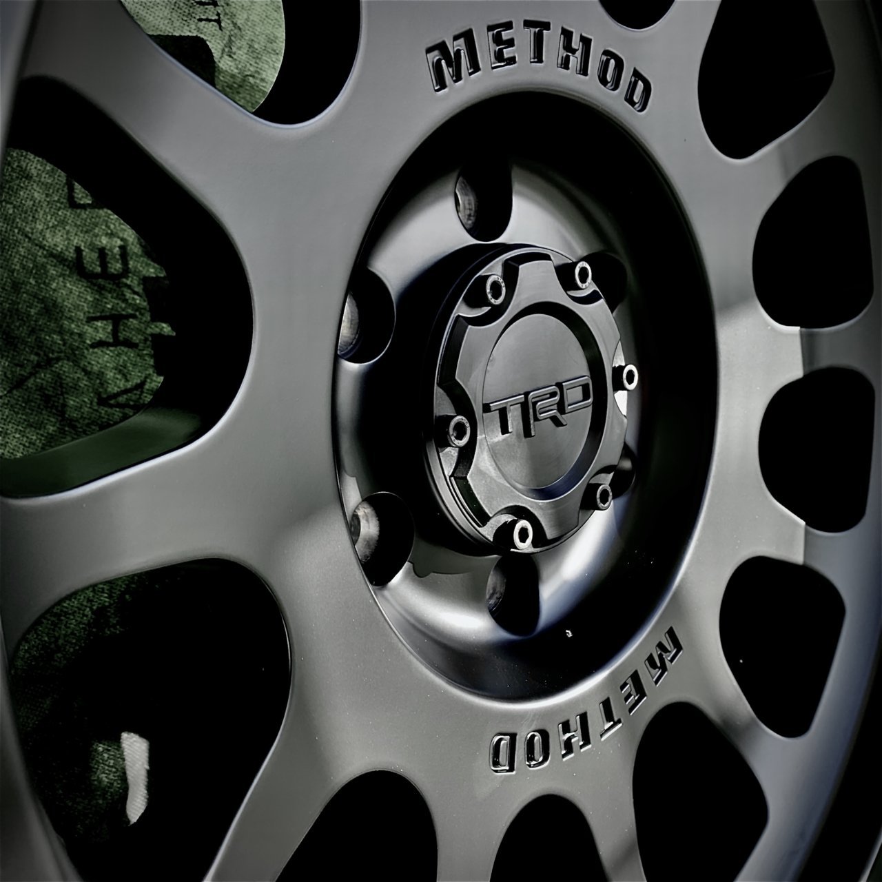

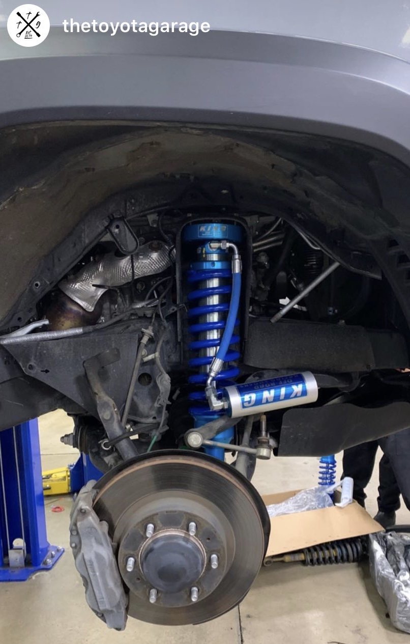

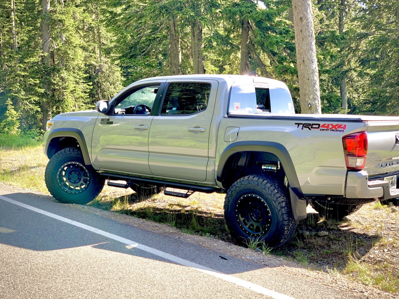

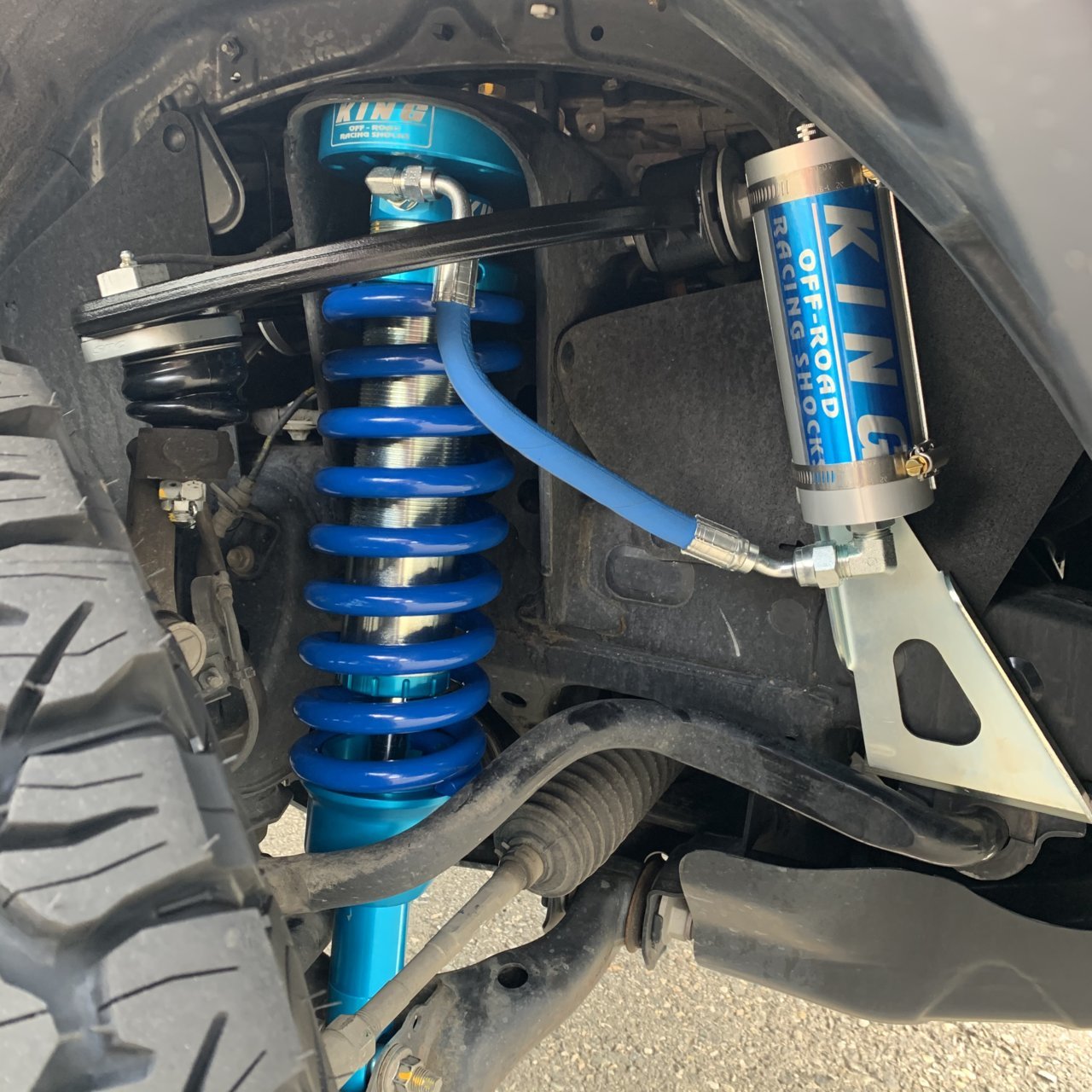

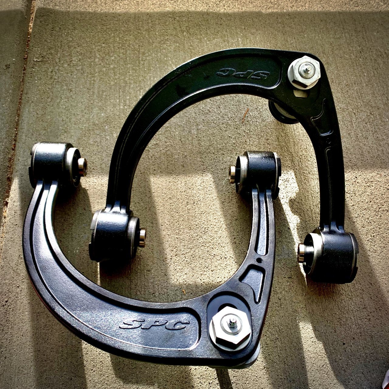

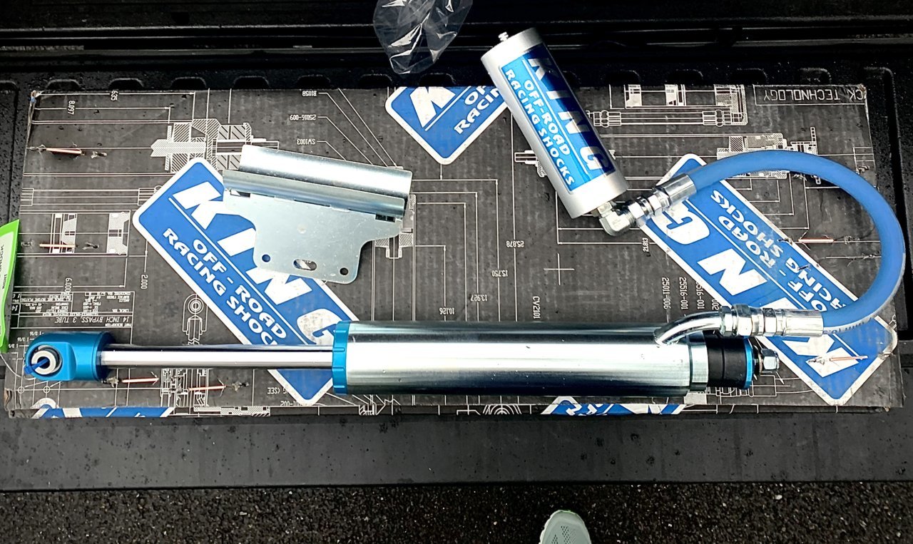

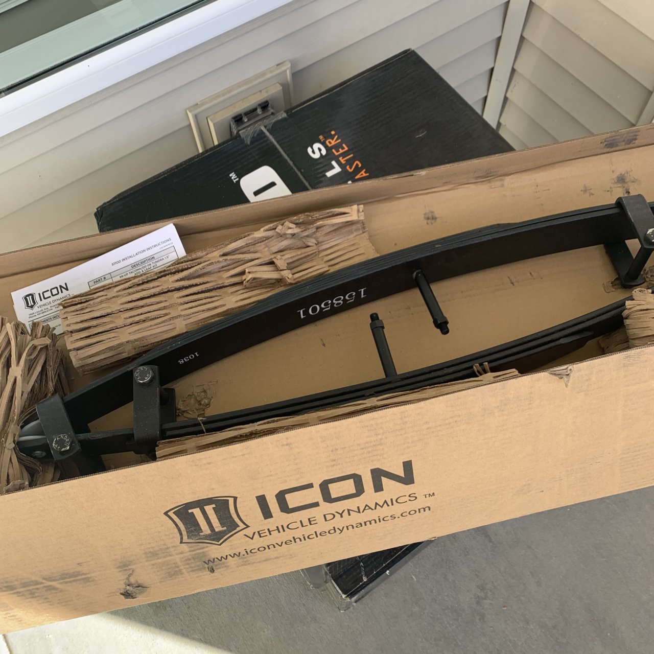

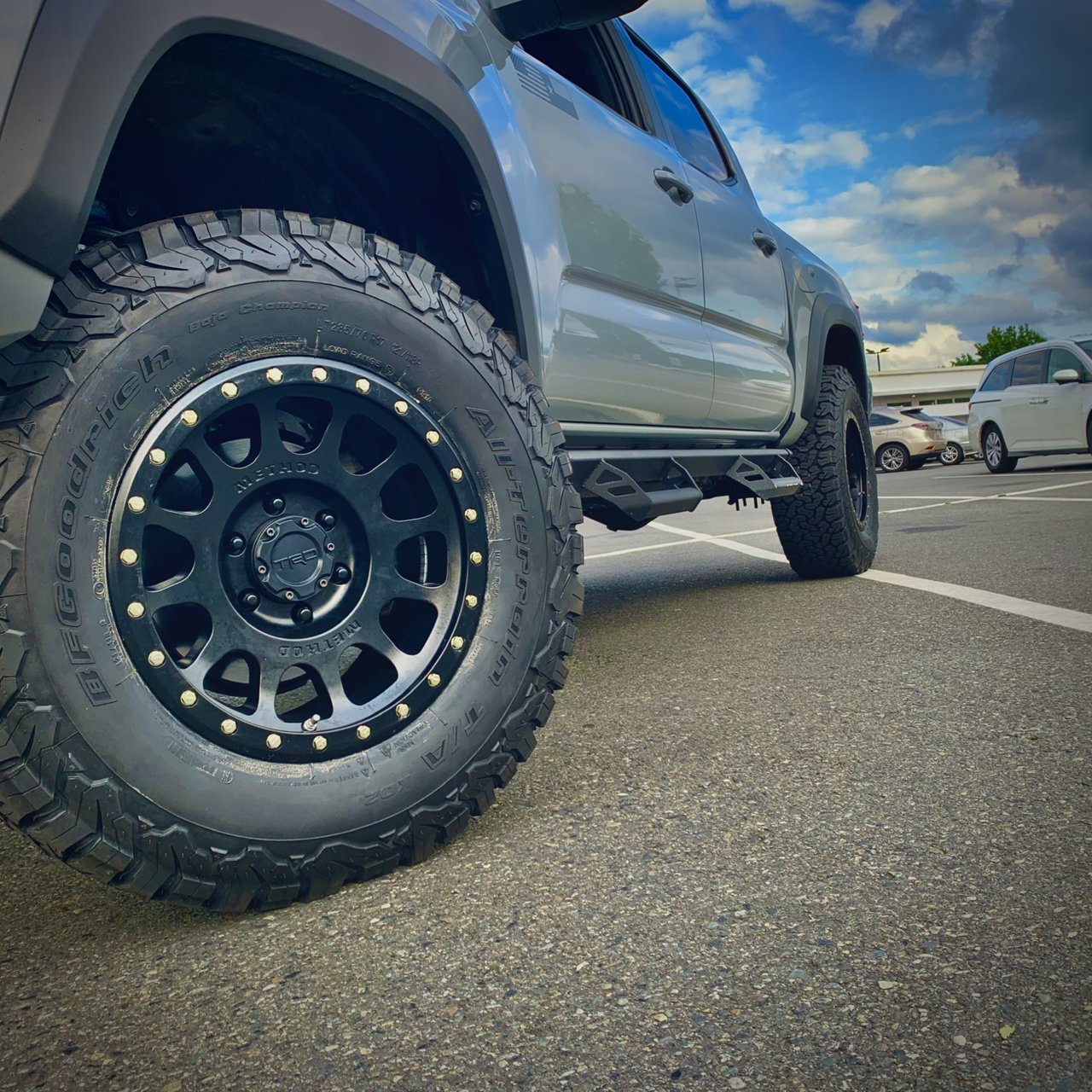

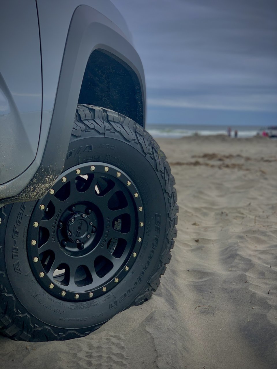

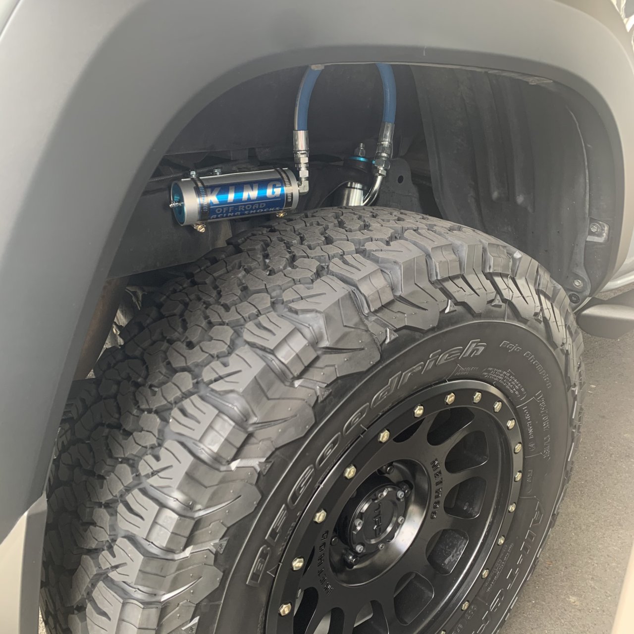

    Suspension install with Method 305s. Work done at @TheToyotaGarage
    I asked for the front to be set to 2”. The minileaf added about 1.5” in the rear and I wanted to retain a bit of rake so it will be more balanced during towing.
    Parts/Install pics with gratuitous beauty shots:
    King 2.5 w/ resi (set to 2”)
    SPC UCAs
    Icon minileaf
    Method 305
    MESO center caps
    Gorilla lugs (black)
    BFG K02 ATs 285/70R17

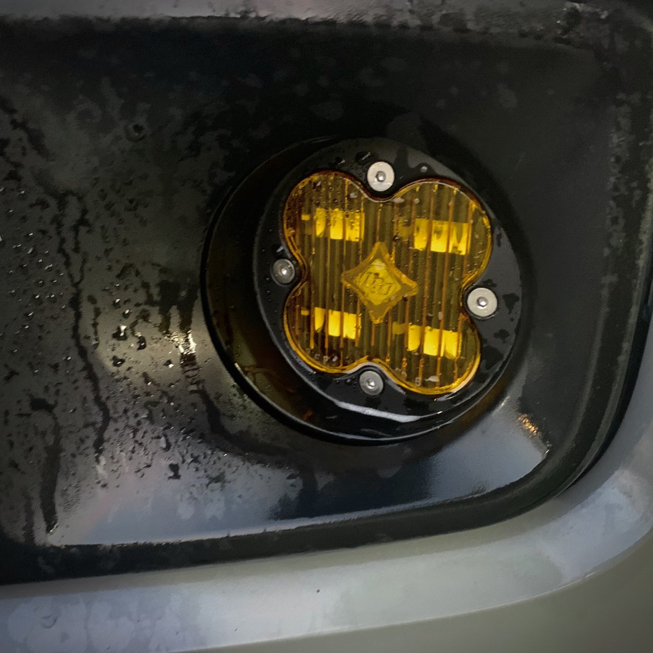

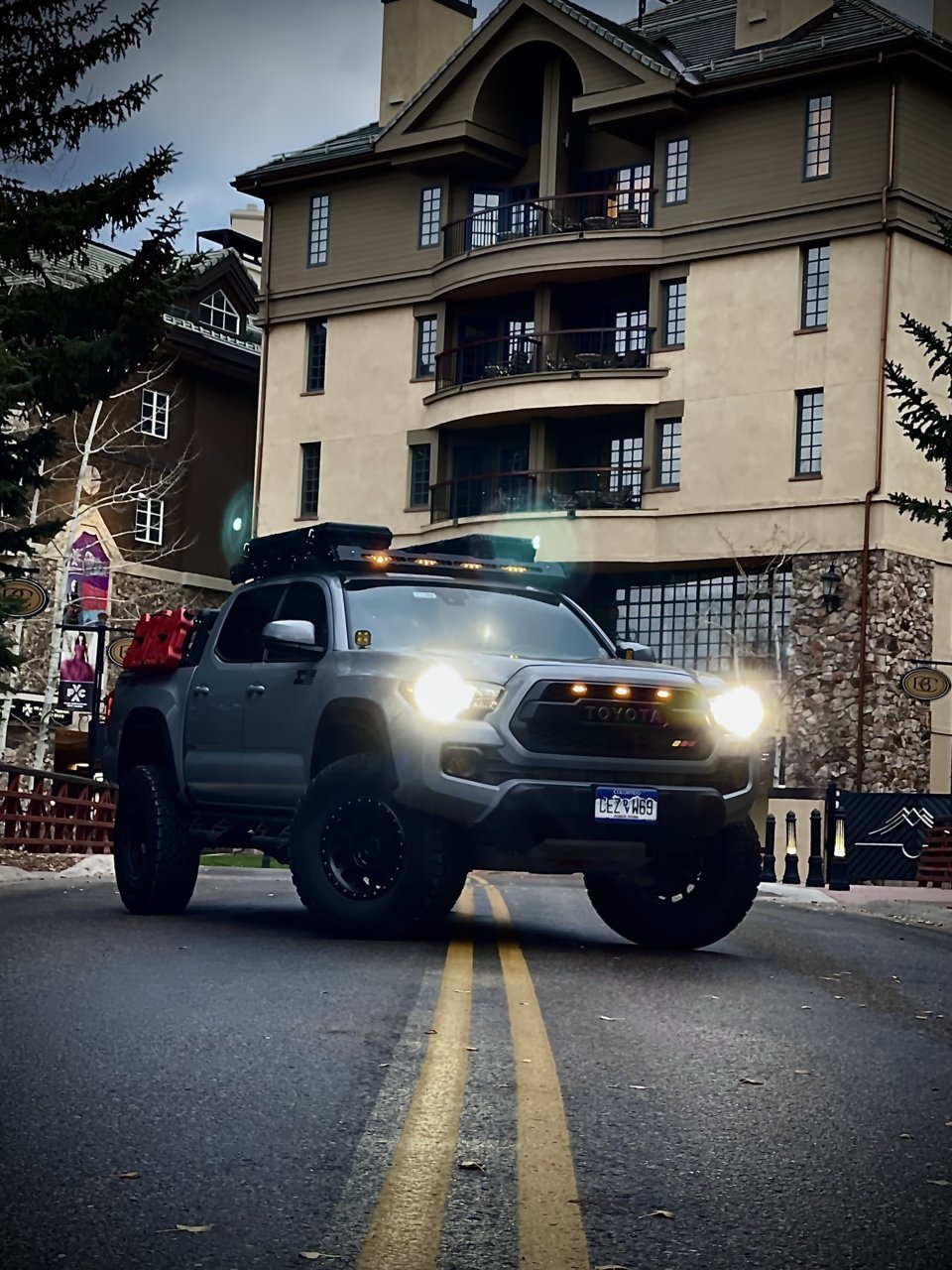

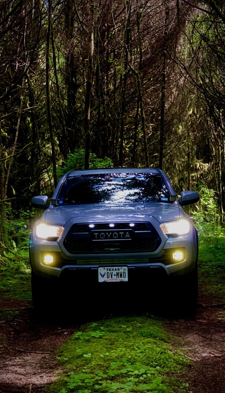

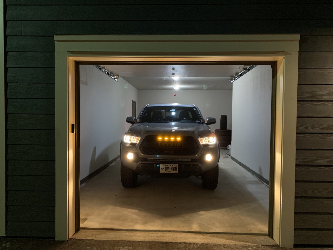

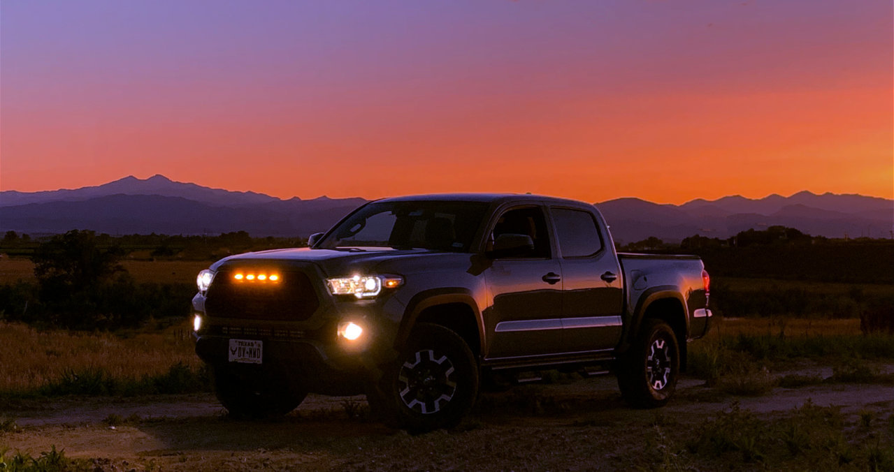

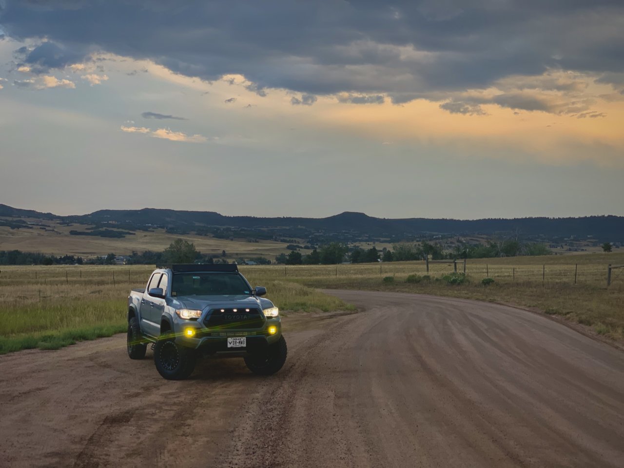

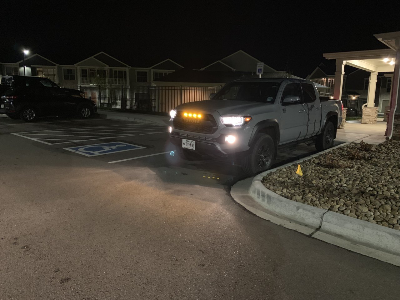

    Some lighting bits:
    With regards to the R4T grille lights, I originally ordered the 4-light harness in amber.
    After a couple months, I thought the 3-light setup was better.
    After buying BD fogs in amber, I noted that the BD lights and the grille lights are two drastically different shades of amber. So I decided to just swap the grille lights out for the white ones in smoked color to conceal them a bit more into the grille. :cool:
    …aaaaand now I’m back to ambers. LoL

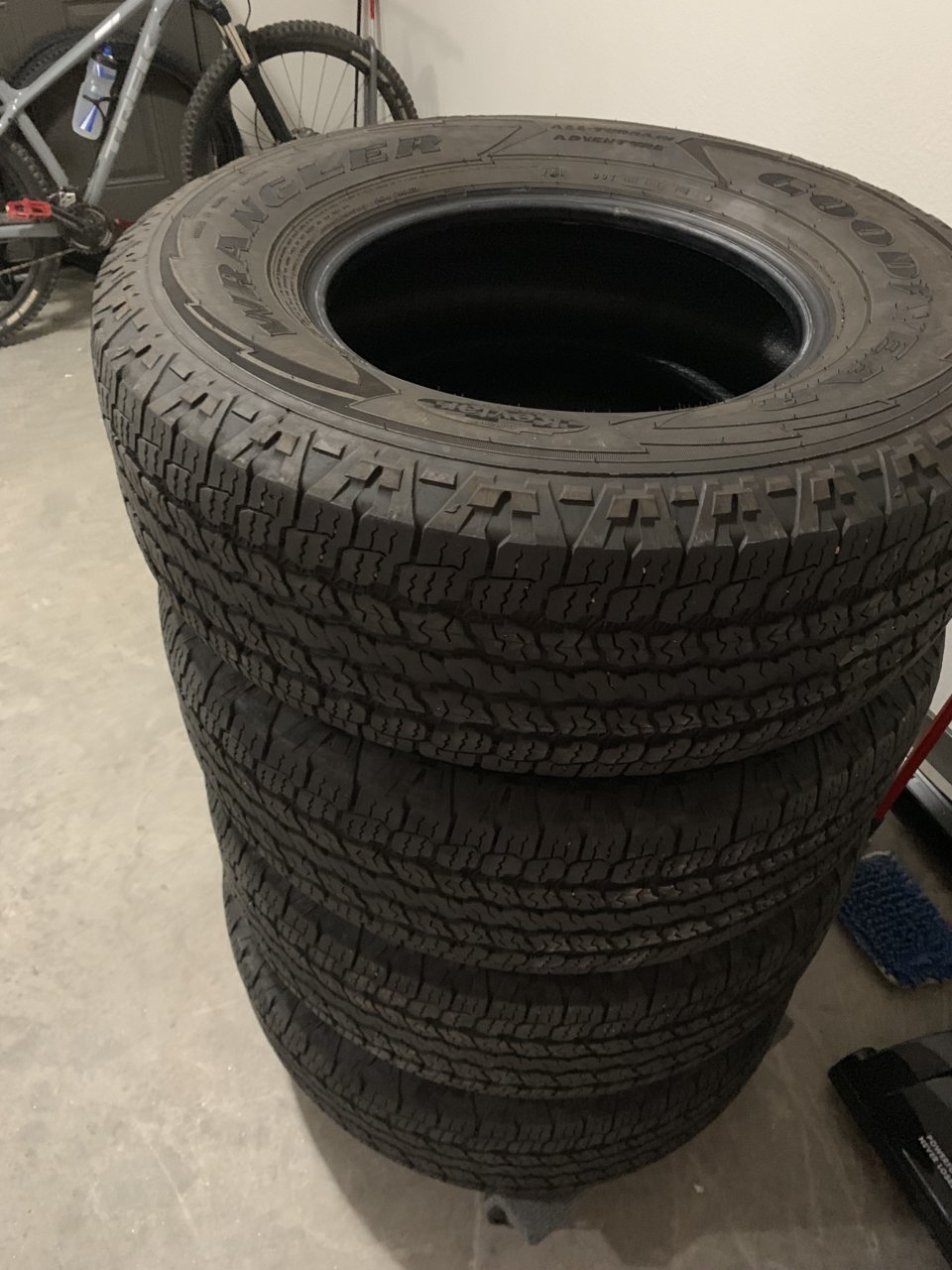

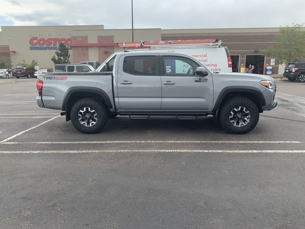

    Before lift, I swapped in some 265/75R16 BFG K02s on my OEM TRDOR wheels.
    This is a basic change. Basically a direct swap for OEM Wranglers (which aren’t really that great).

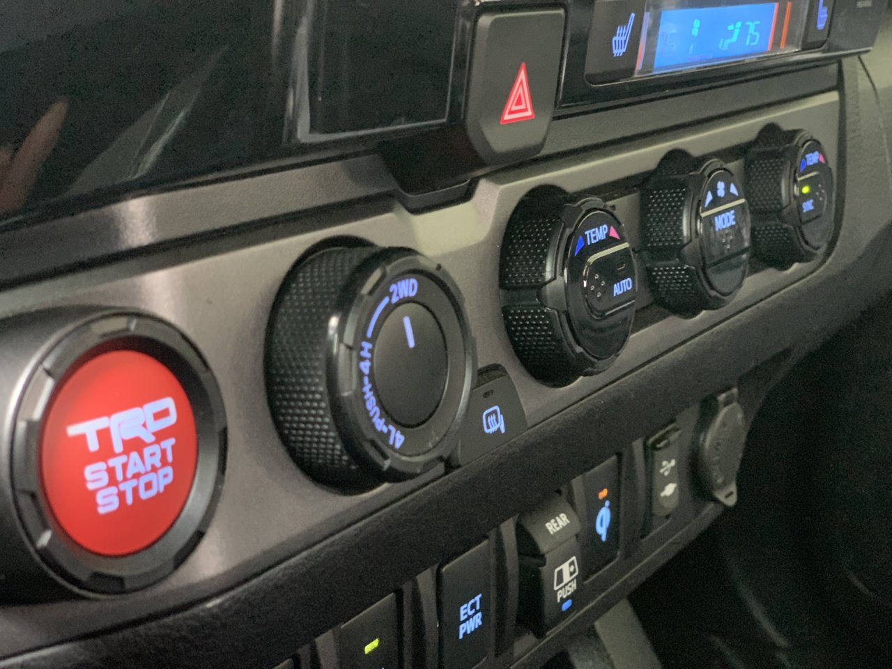

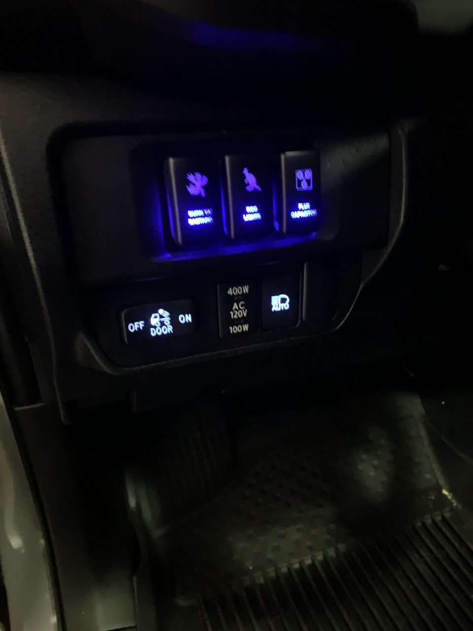

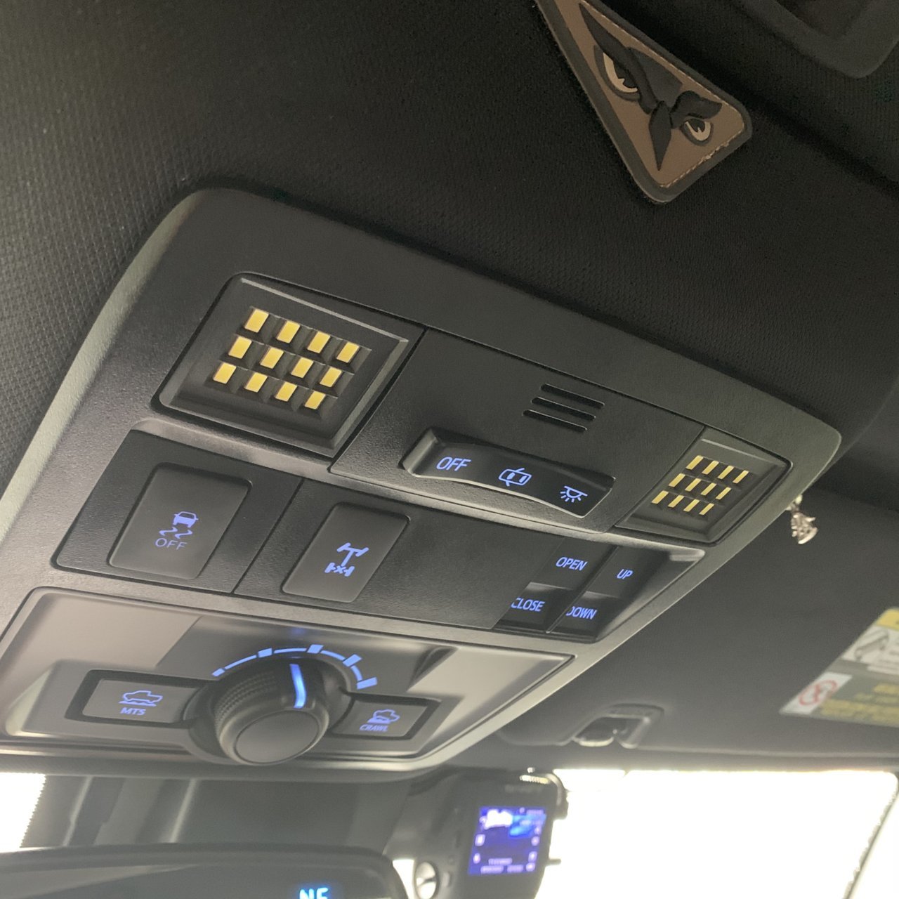

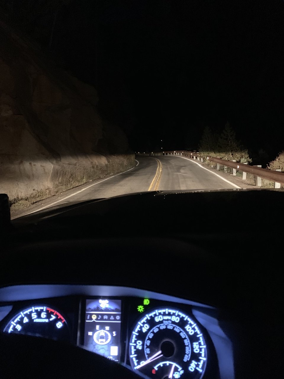

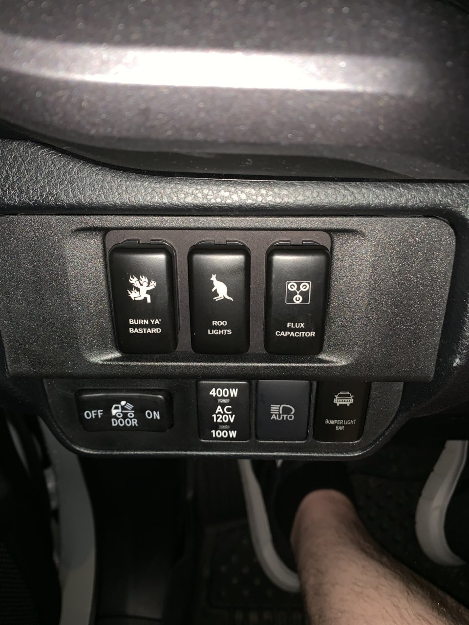

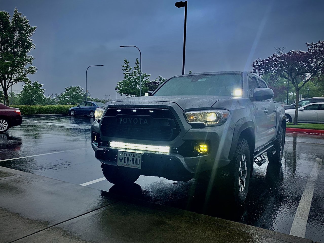

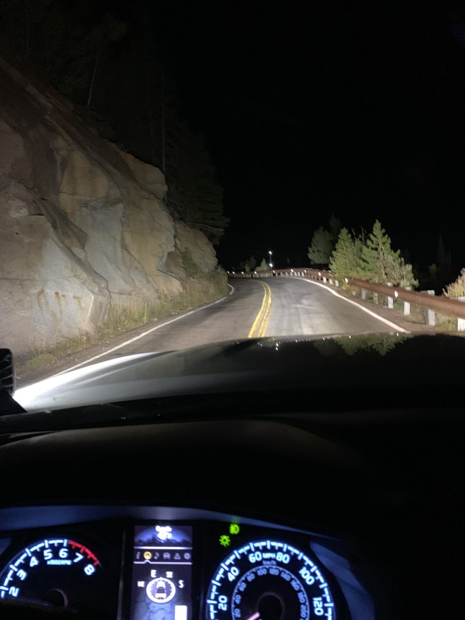

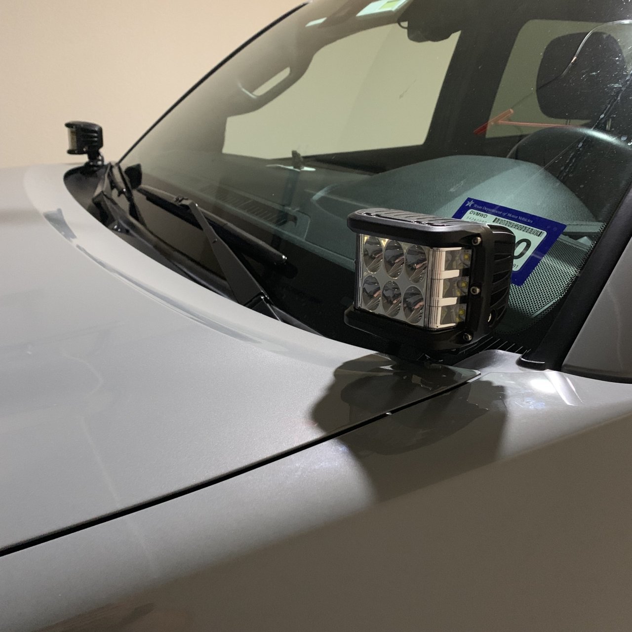

    Exterior lighting stuff:
    In addition to the LED bar and ditch lights, I installed some OEM-style switches from AirOnBoard:
    • "Burn Ya Bastard" to LED bar
    • "Roo Lights" to ditch lights
    • "Flux Capacitor" to rear anytime camera
    Light comparison on a back mountain road near Aspen, CO (Independence Pass) with the standard headlight/fog lights versus the @CaliRaisedLed LED light bar and ditch lights.
    Also swapped the standard mounting bolts from @CaliRaisedLed for some "tamperproof" bolts.

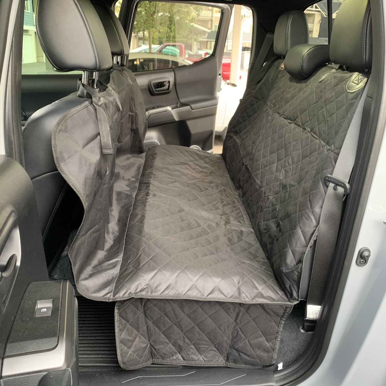

    Added a rear seat cover for dogs and dirty MTB gear. :)

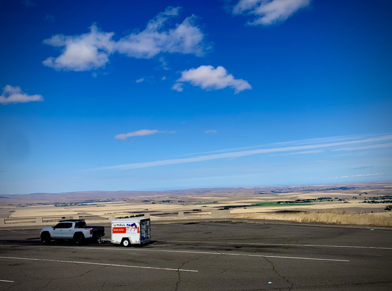

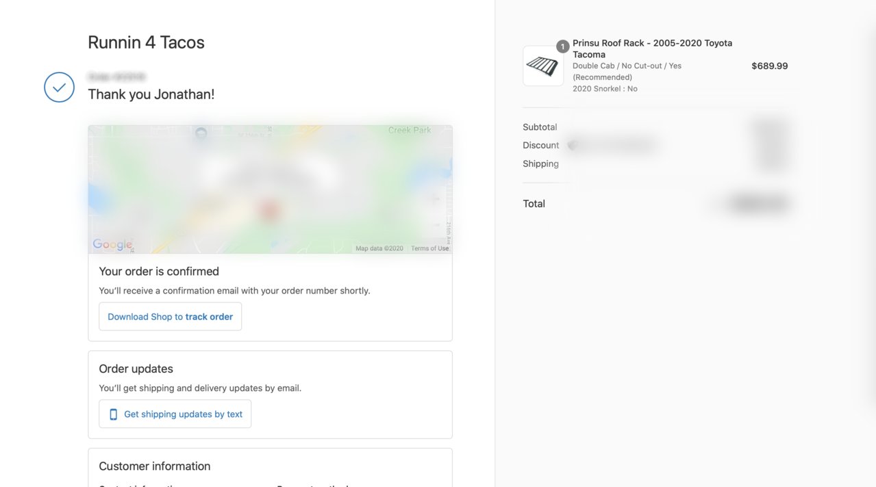

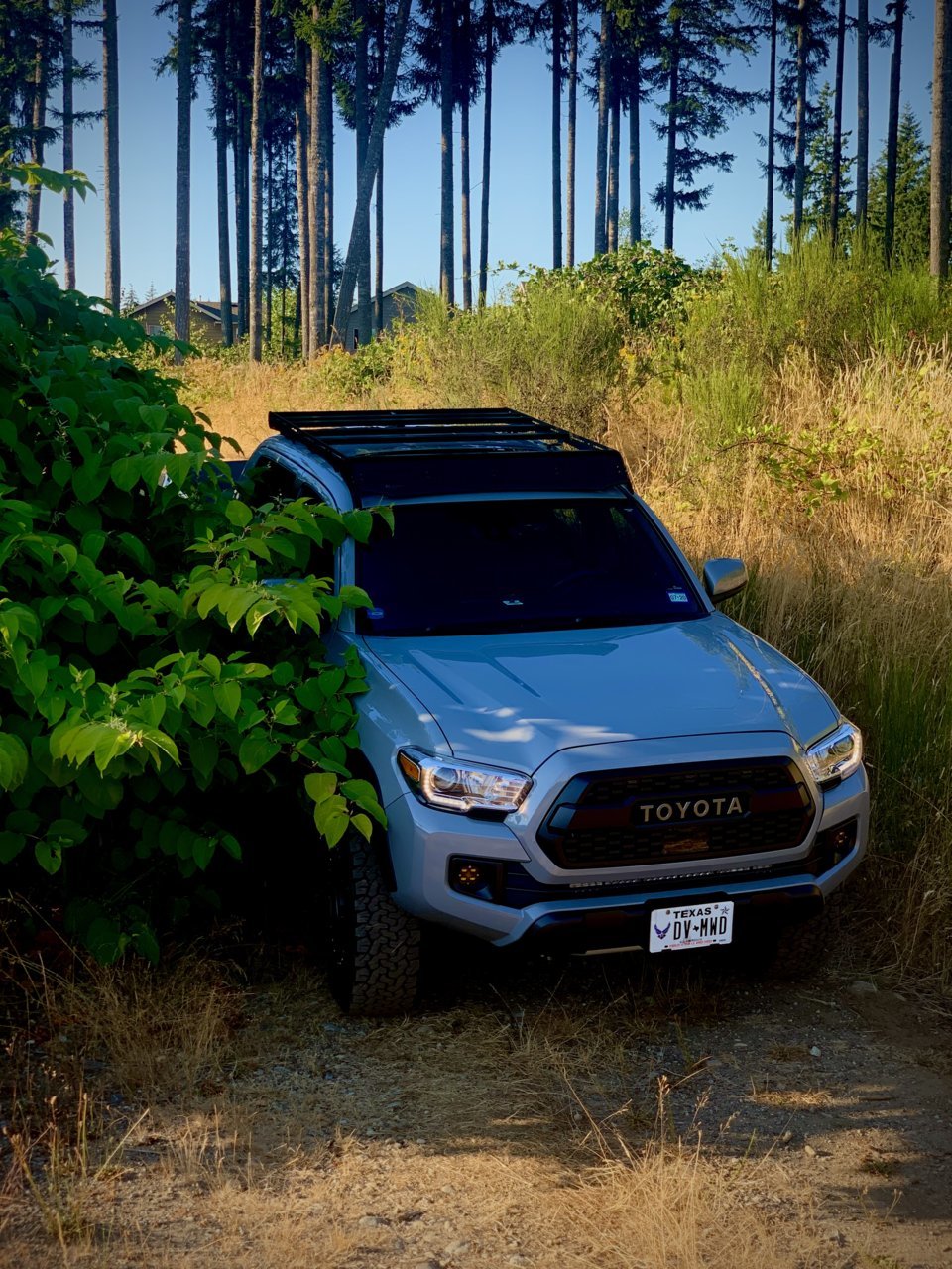

    Waiting for my Prinsu, road tripping to Bellingham, WA

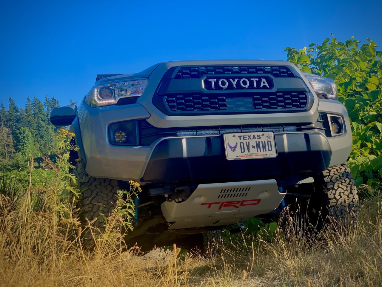

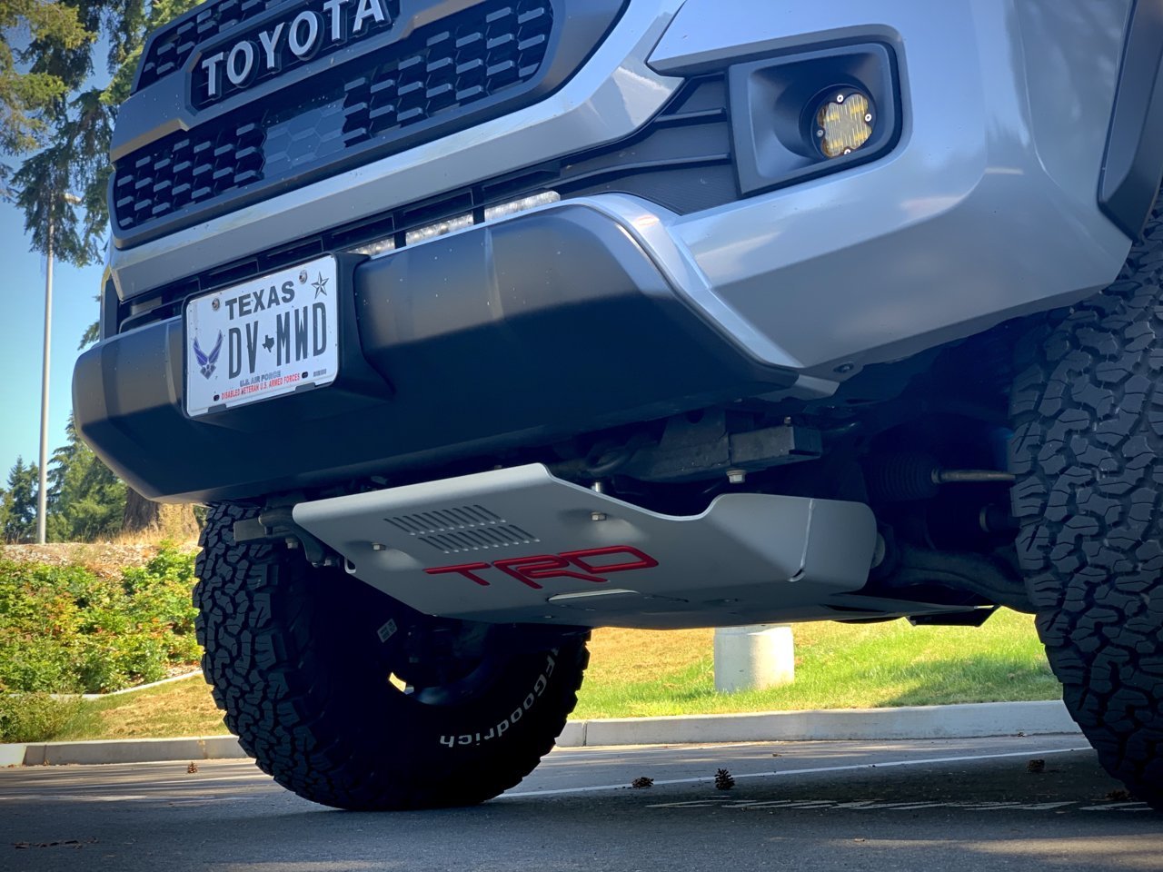

    Also threw on a new skid...

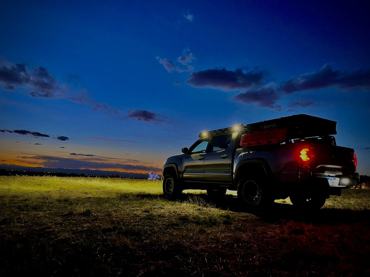

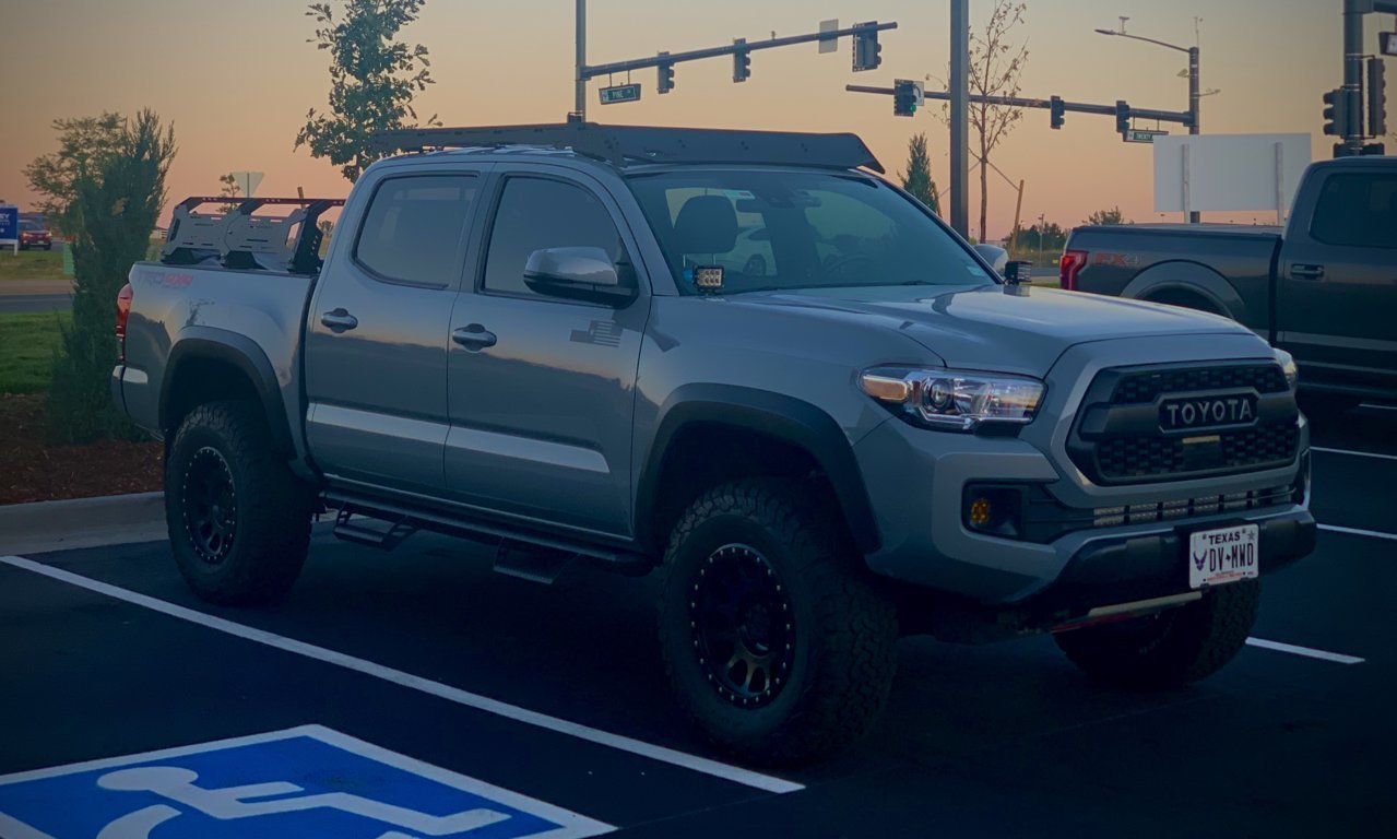

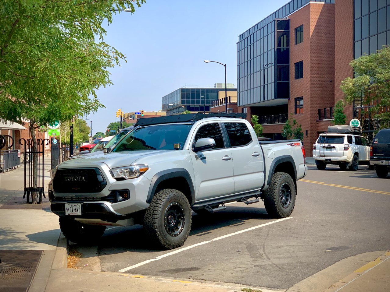

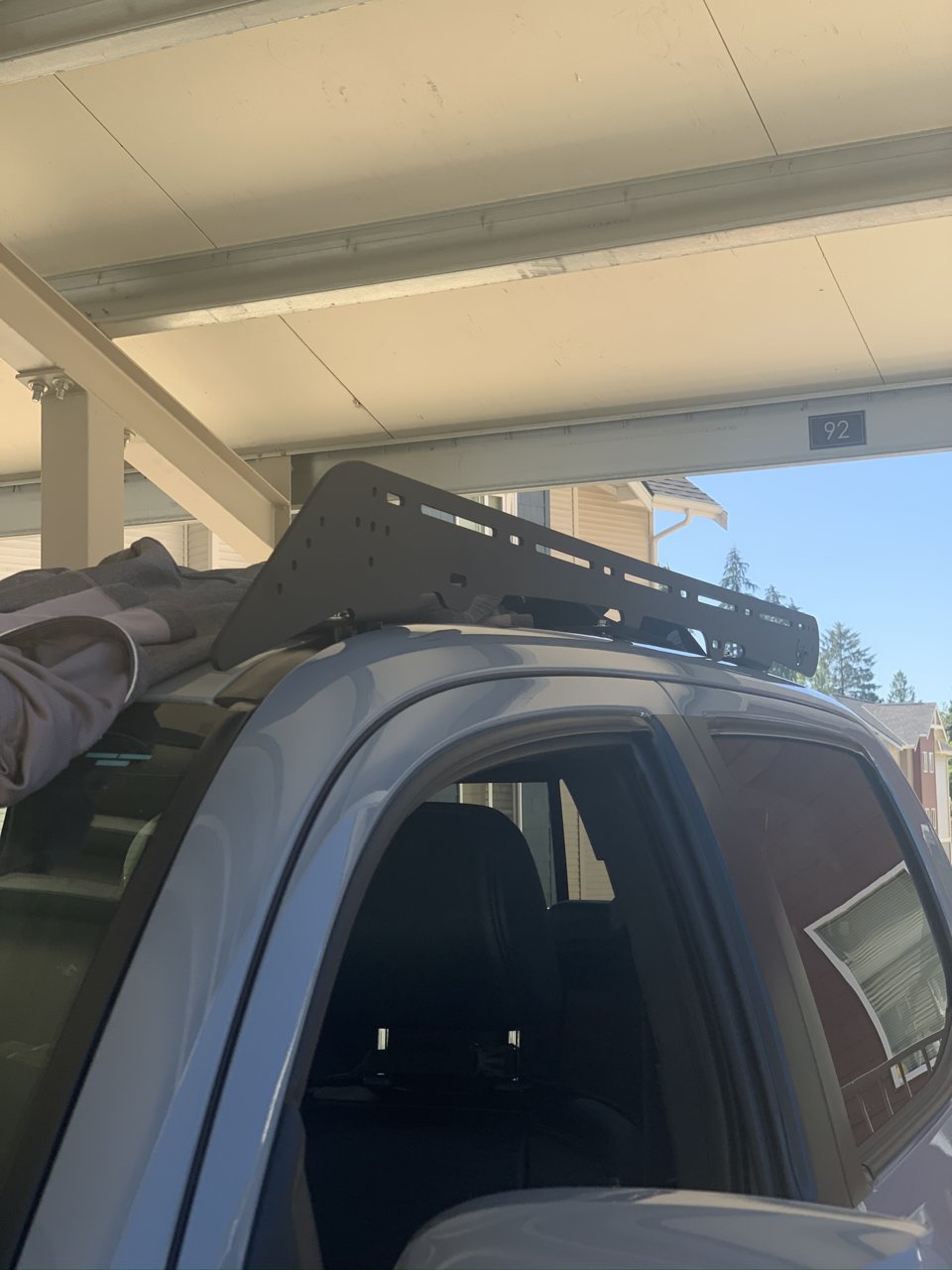

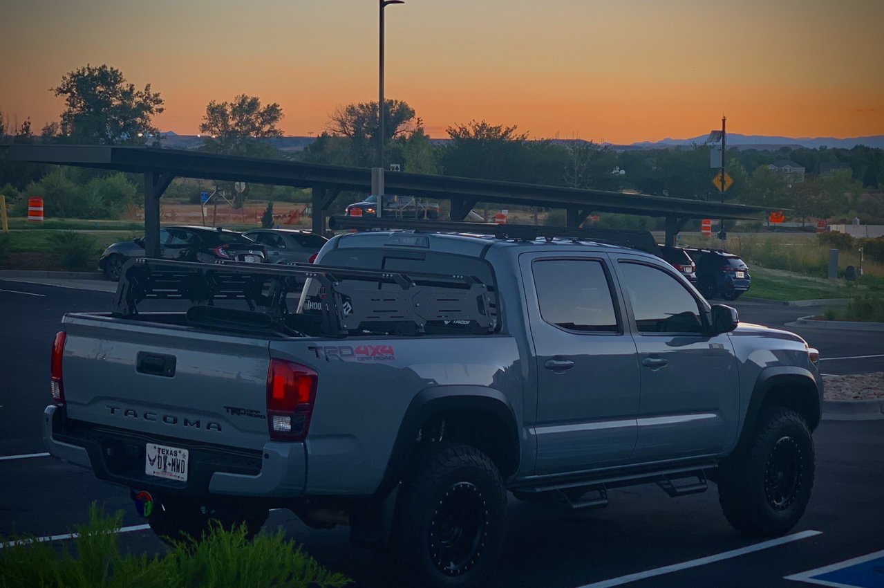

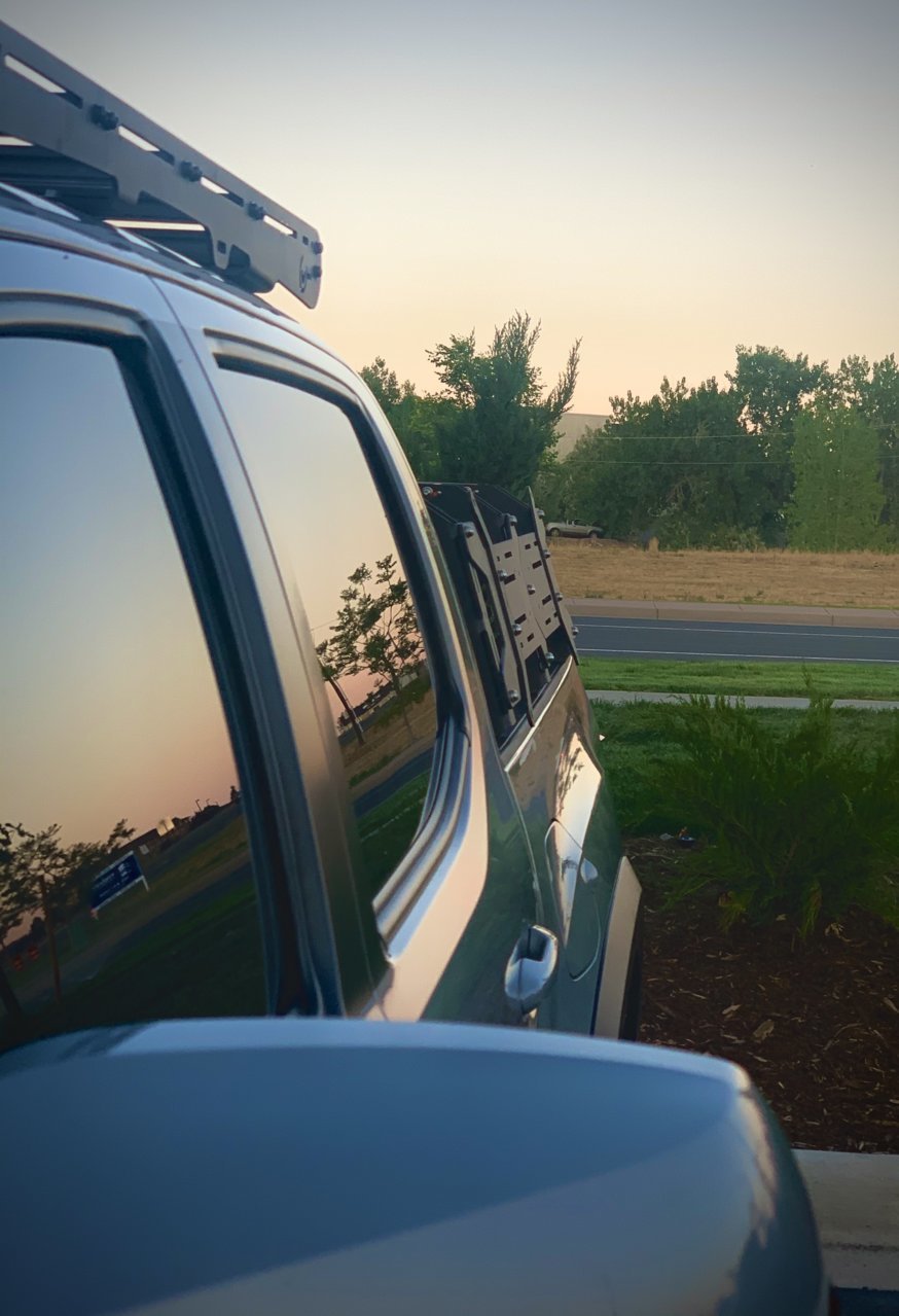

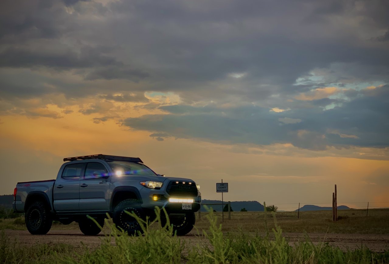

    Been awhile since my last update. I made a move back to Colorado (#LoveCO).
    Since then, I’ve added a @CBI Offroad Fab Prinsu Rack and @upTOPoverland mid-height TRUSS rack.
    Planning on some MaxTraxx boards before saving for an iKamper RTT and @DECKEDUSA bed deck.

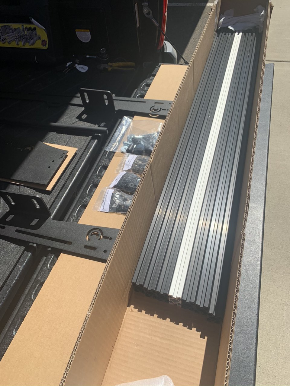

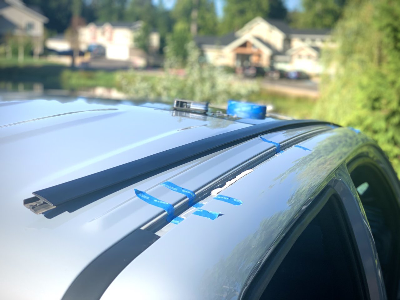

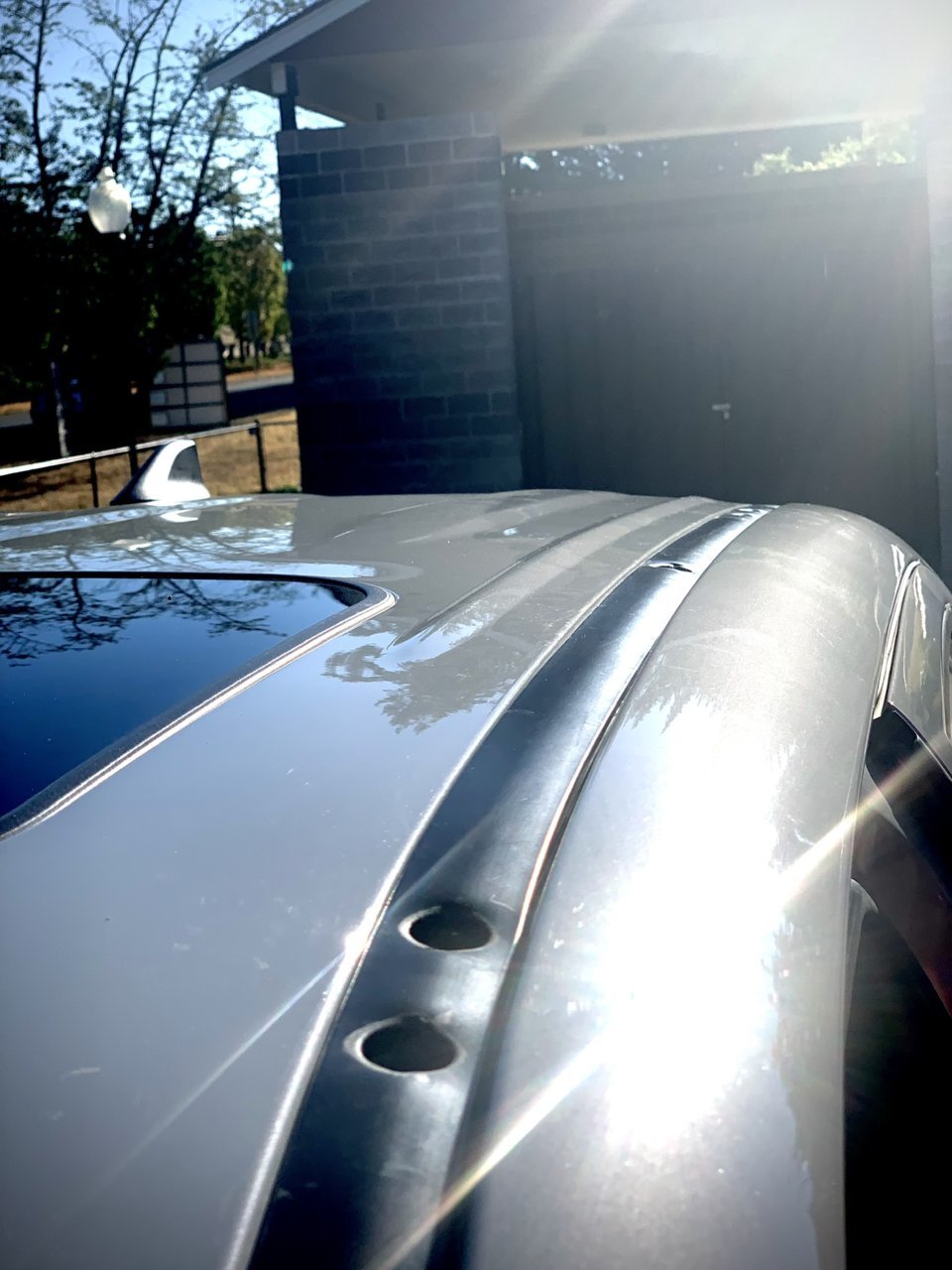

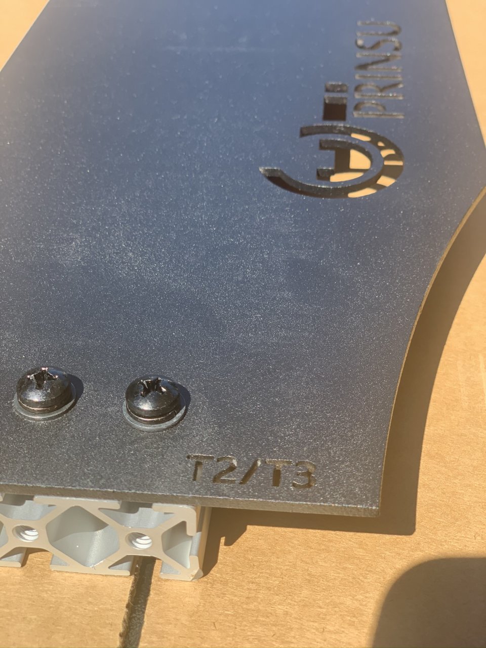

    More pics from Prinsu install after delivery from @runnin4tacos. The instructions said to fully assemble off the truck. But I was a one man show. So I did the side rails and then did cross bars individually. Lots of up and down and side to side crossing. Also your calves get a hellacious workout standing on the predator tubes. But it is very doable. :thumbsup:
