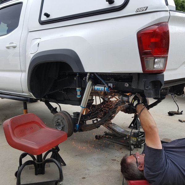

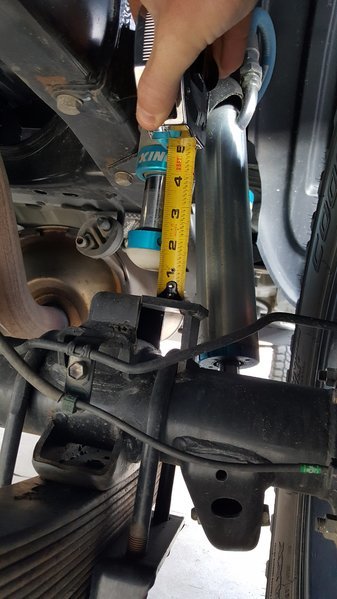

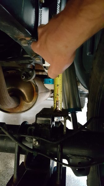

  5. May 21, 2016 at 7:43 AM
    #125
    Brosefff
    Brosefff [OP] Well-Known Member
    Sep 14, 2015
    #164242
    122
    Temecula
    2016 Taco SB 4x4
    a little something
    IMG_20160509_164800.jpg 20160509_071408.jpg 1463841226465990769216.jpg IMG_20160514_230513.jpg
    Oredered the Archive Garage shackle flip kit. I was stoked on the quality when it arrived...beefy. instalation was moderately difficult because i had to move it from the preferred position to the secondary one because the shackle was goin forward instead of back. Performance is great and got the 1.5 inches of lift needed when loaded. Just need a relocation and 14" king now!
