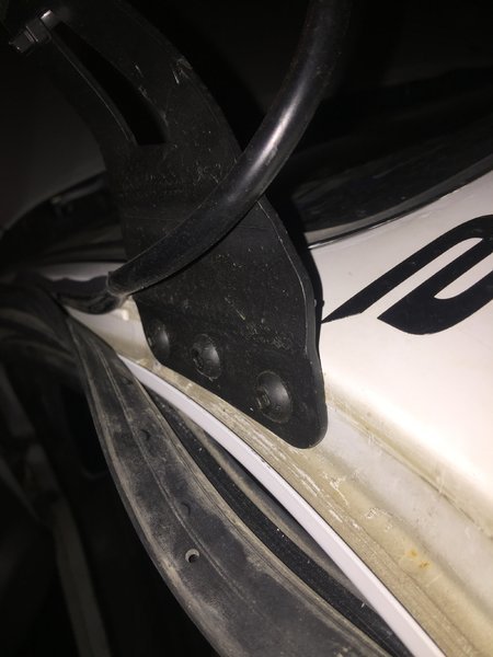

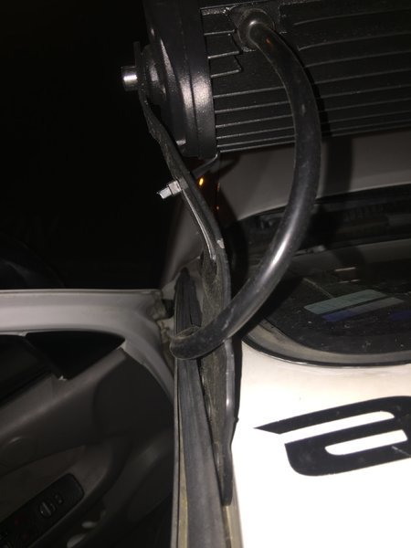

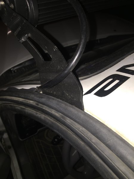

    I used a vise and a large set of pliers to bend them. After they were bent to the correct shape to accommodate the light bar, I held one up to the door frame and traced inside the mount's three holes with a sharpie. I started with a 1/8" pilot hole then moved on to the 1/2". After they were all drilled, I lightly hammered in the provided insterts in which the screws would thread. I'm really happy with how it turned out, it's pretty solid. Also, the door has no issues shutting.
    I may "modify" the mounts a little more after finals next week to bring the bar in closer to the windshield.
