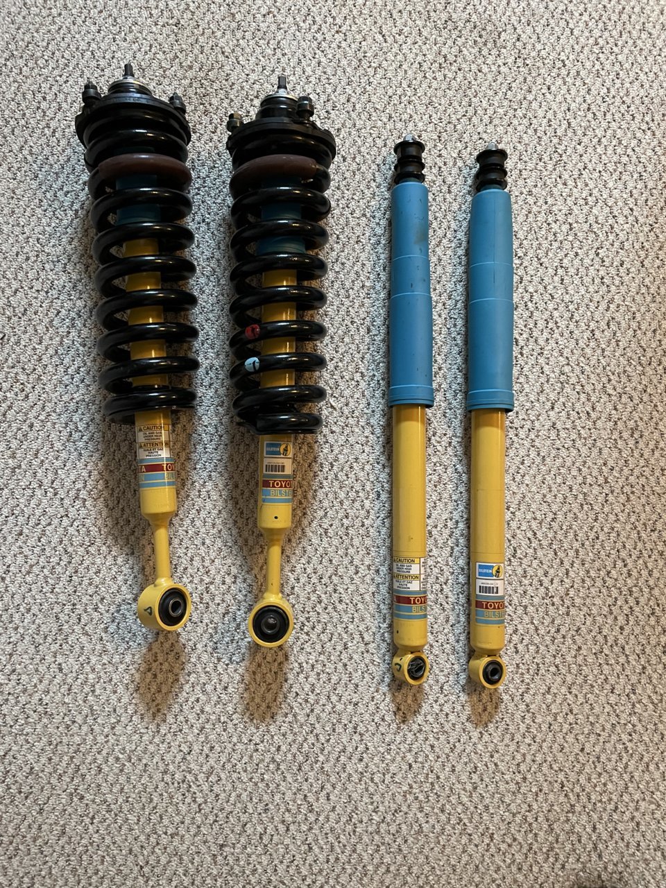

    I just picked up a set of 3rd gen. coilovers for my 08. What are the brown coils?

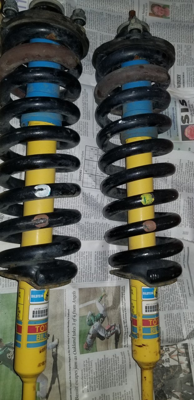

    Are all the coils brown or just one? Toyota did put a brown band towards the top… can’t say what it was for? Stole this pic from another thread.

    That's what I was referring to. For those that want pics I will work on trying to do that. I'm not very smart but I can lift heavy things. Thanks for the help.

    I noticed the brown coil on mine,,,, just a guess, but it's a factory designation for various spring rates

    The colored paint dots are spring codes. White and yellow should be left and right. I forgot which is which but the rear lelf springs part numbers are painted white and yellow also.
    The wrap near the top is a insulator. It helps with noise from the coils banging together. Most factory springs are progressive so these coils will bind first. You see these on a lot of different vehicles
