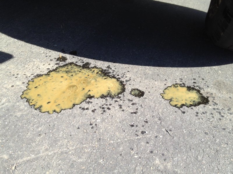

    Can you post a pic? Does it look like Dunkin' Donuts coffee with milk - like exactly like that?
    I've seen two major oil and coolant mixes now and been involved with their repairs.
    One was a forum buddy's blown head gasket on a Kawasaki Ninja ZX6E
    the second one was more of a mess: a 1998 Ford e250 that I bought as is - blowing out oil/coolant mix, and it turned out to have a blown oil cooler.
    Does the coolant feel 'oily' in your fingertips at all? It's probably not this issue (anyway).

    errrr... I'm getting a not good feeling over here about this...
    gonna post two pics. Look like this?
    (this was my "cooloil" mix as I fondly called it)

    My coolant looks nothing like that, feww, when I drain it out the bottom its green but when I pull some out of the radiator cap it's coffee like
