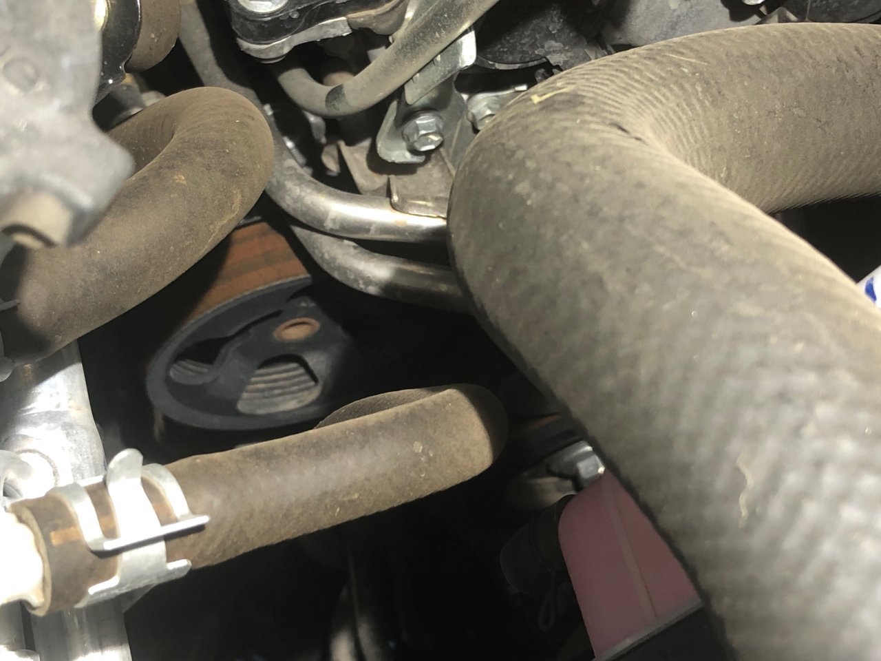

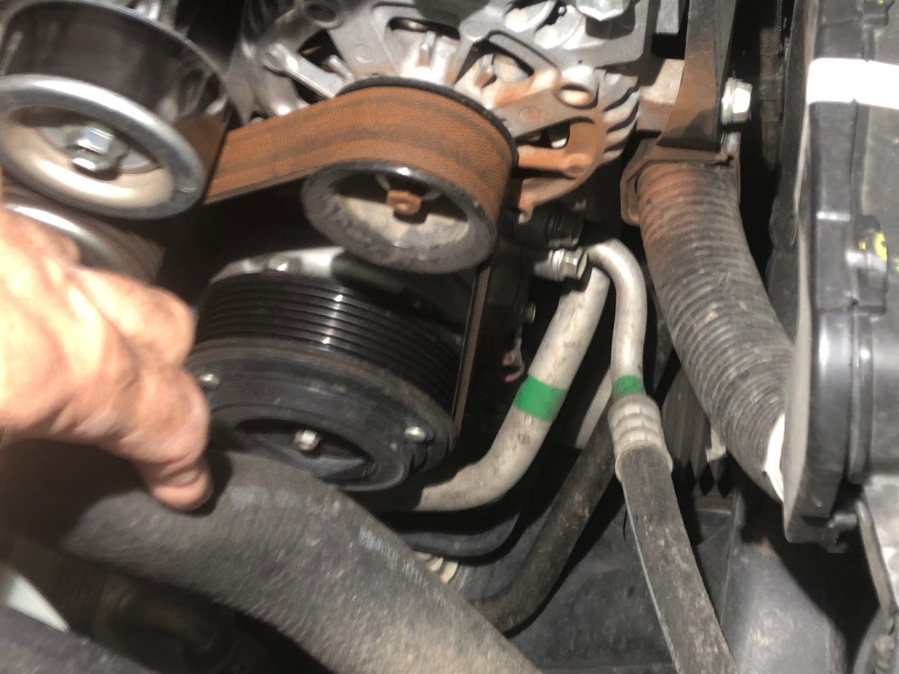

  9. Sep 14, 2023 at 9:17 AM
    #29
    22Coma6MT
    22Coma6MT [OP] Well-Known Member
    Jul 7, 2022
    #400898
    703
    2022 TRD Sport AC 6MT
    i took photos from both sides of the front of the engine and belt assembly. does these show you enough? thank you.

    Take some photos further back of the whole engine bay, and some from right above looking straight at the ground. These pictures are too close and you can’t see what else is happening. The rust or dust is clearly getting slung off the belt when it passes around the alternator pulley. That’s why it has those dust patterns on the alternator and the flex tubing to its right.

    Everything looks fine except for the belt and the rust spreading onto other parts around the alternator. I once owned a Jeep Patriot and they were notorious for the alternator pulley going bad. Once the bearings lost grease, they started to rust and shoot out brown soot and Dust onto the pulley and belt.
    does it make any spinning or whining noises when accelerating or idling(besides the manual transmission of course)? If so I’d presume a bearing might also be the cause of the rust.
