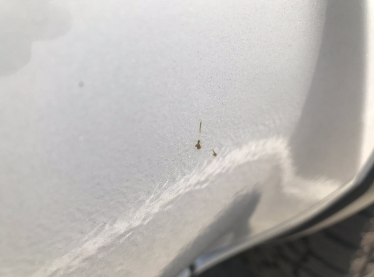

    Yeah those are not rust stains, they are too uniformed in color. Rail dust will have a sharp color in the center as it fades out a little lighter.
    Those are grease/tar stains. Chances are its from recent asphalt that stuck to the film. Depending on how long it was on there, buffing the top layer off may be the only option.

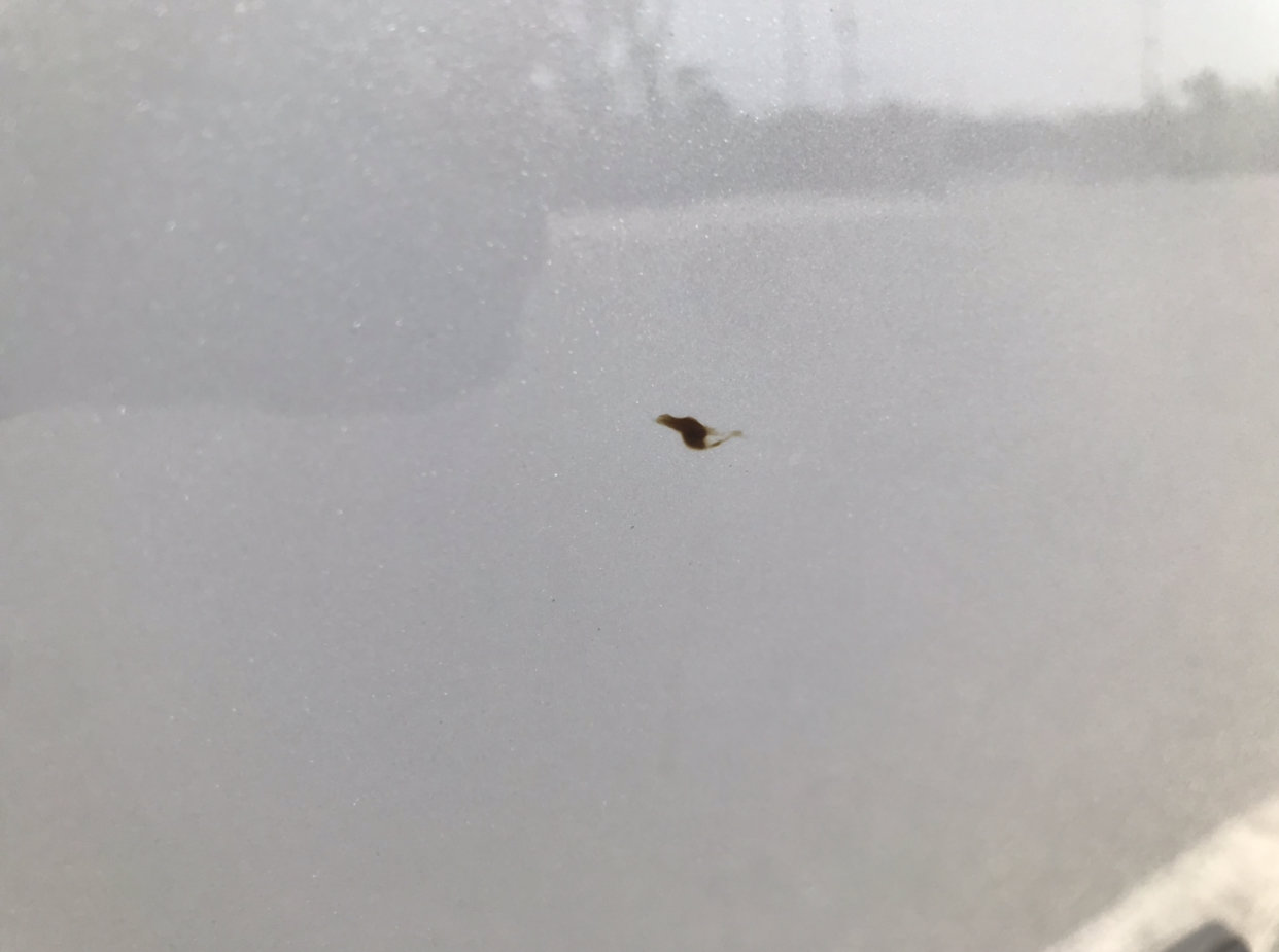

    I got something similar a couple weeks ago. I noticed a thick brown glob on passenger front door. It was thick and oily. I cleaned it off, but it left the spots as seen in the photos. I tried a clay bar and Goof-off, but nothing. You can’t feel the edge of the spot, it’s almost as it’s in the clear coat. :confused: You can see a drip mark on the first photo.

    Only way it'll come off is paint correction / cut and polish. I tried citrol, ironx, clay bar, its definitely stained / bled through the clearcoat. Dealer is gonna tell you tough luck, since they aren't responsible for road conditions and its not a paint defect, just bad luck. My truck is even ceramic coated and it did that.

    Finally got something from the dealer, they want to buff out the spots to see if that helps.
