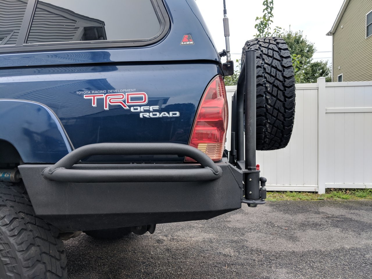

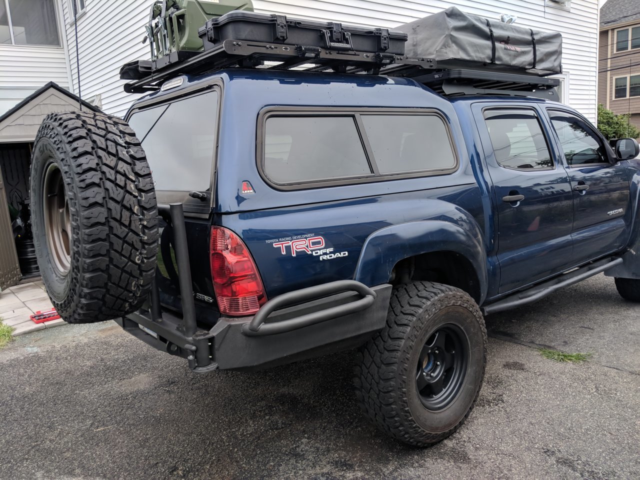

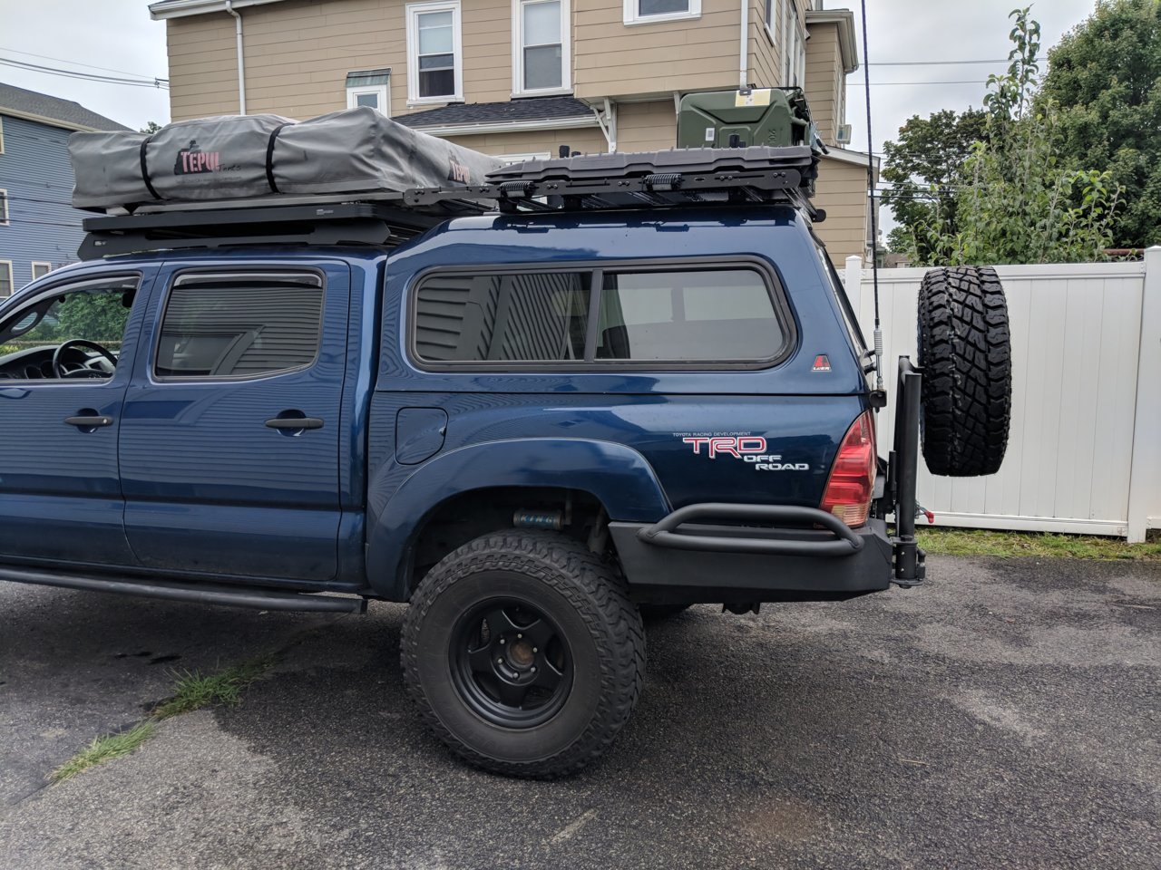

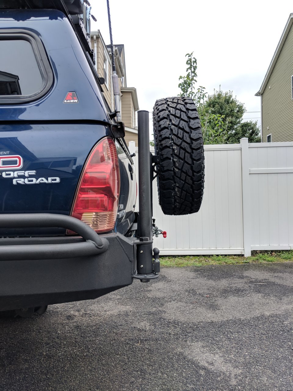

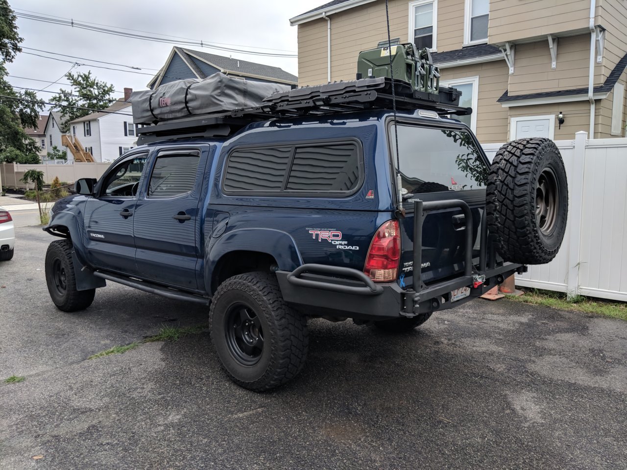

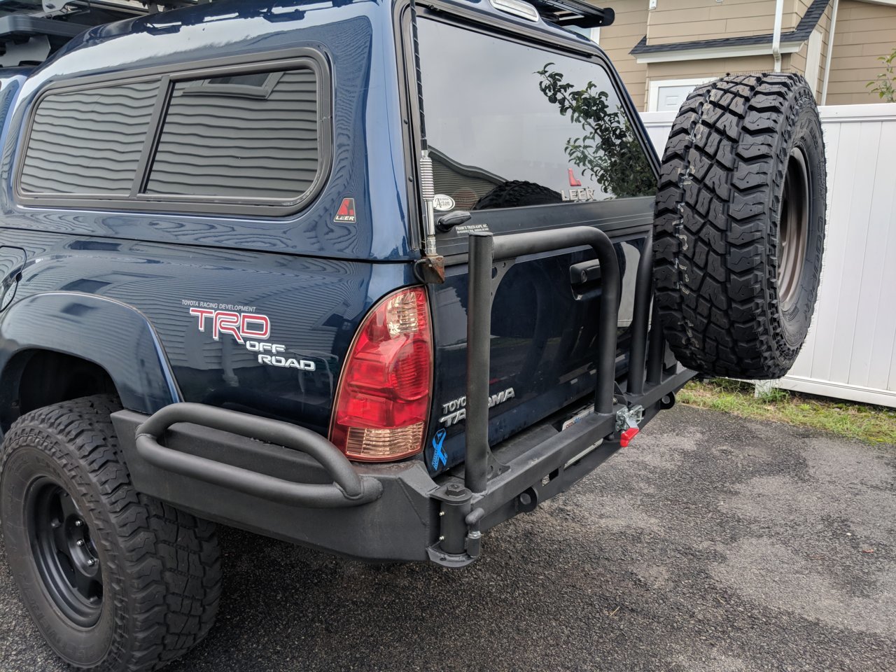

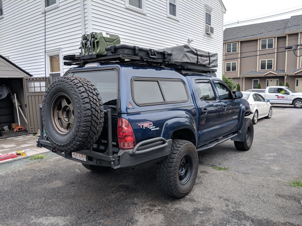

    Well - the SOS Concepts High Clearance Swingout is installed and ready to go. I love the fitment and the swingouts feel solid with the spare mounted up there.

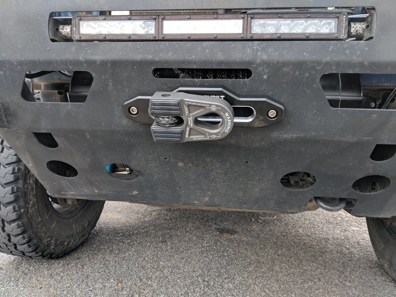

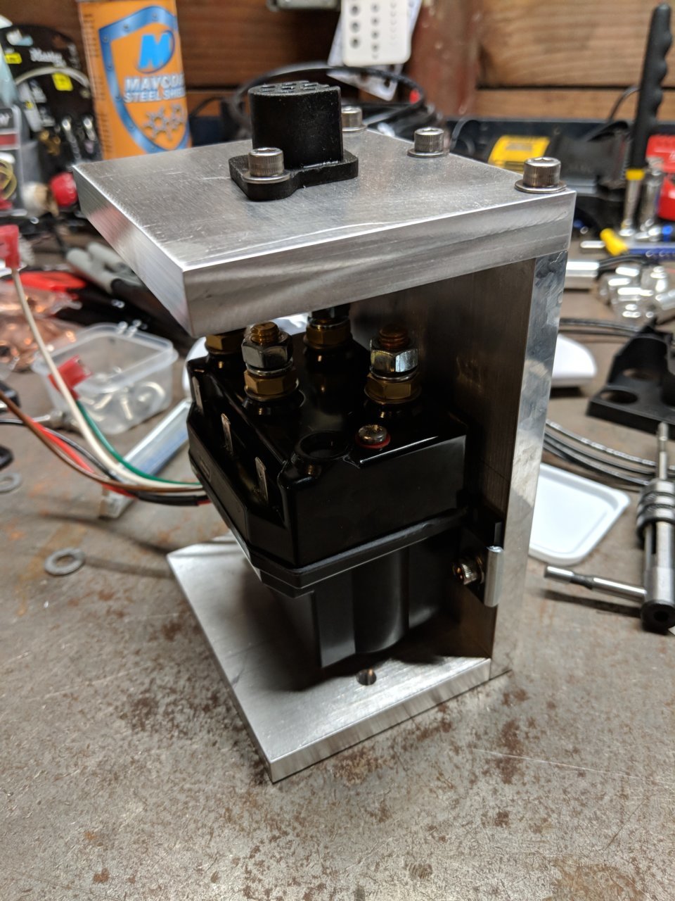

    Started the long meticulous process of getting everything to install the winch and the arb twin compressor.

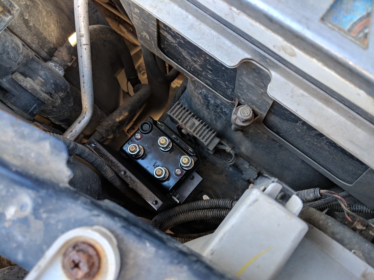

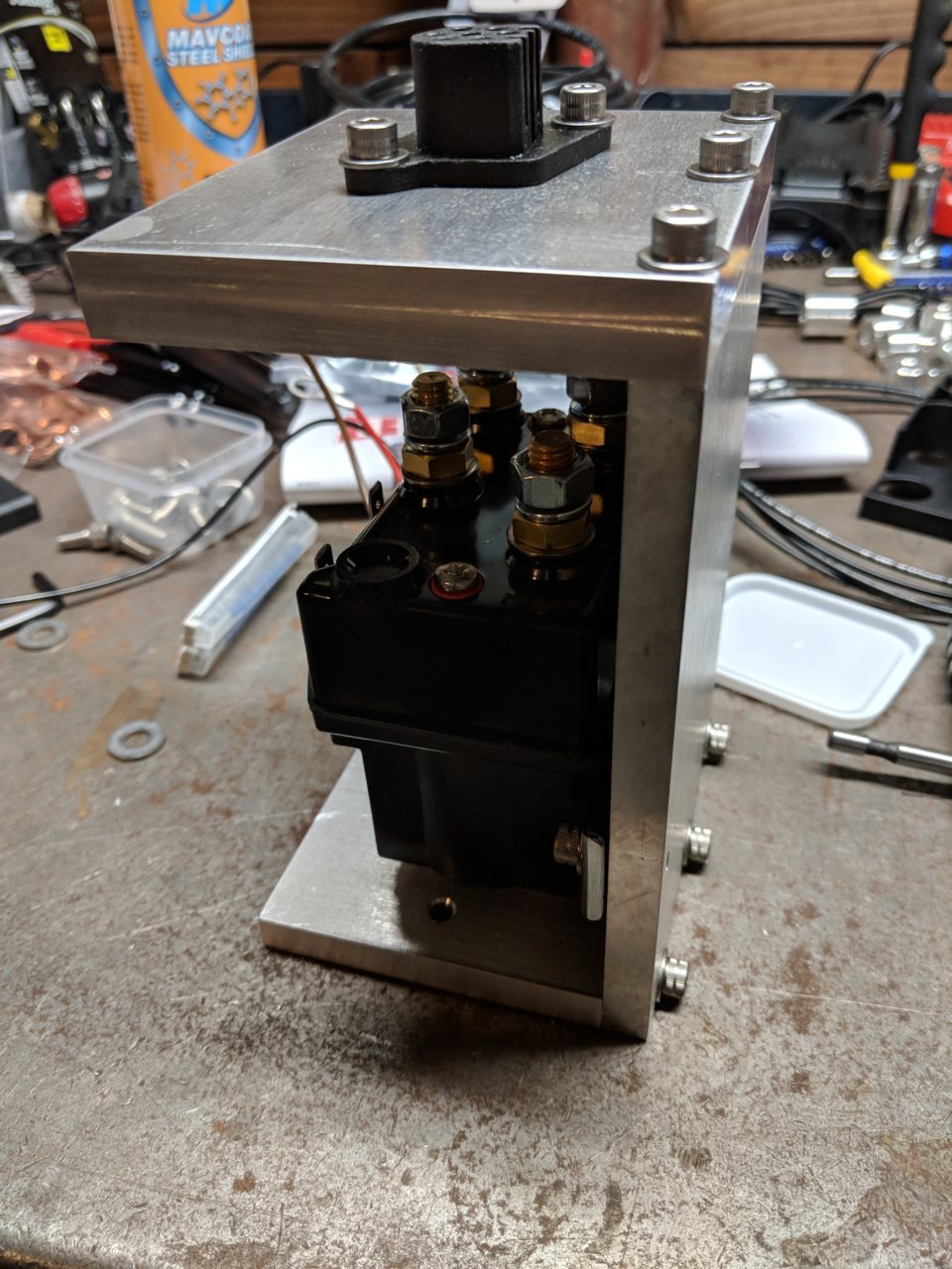

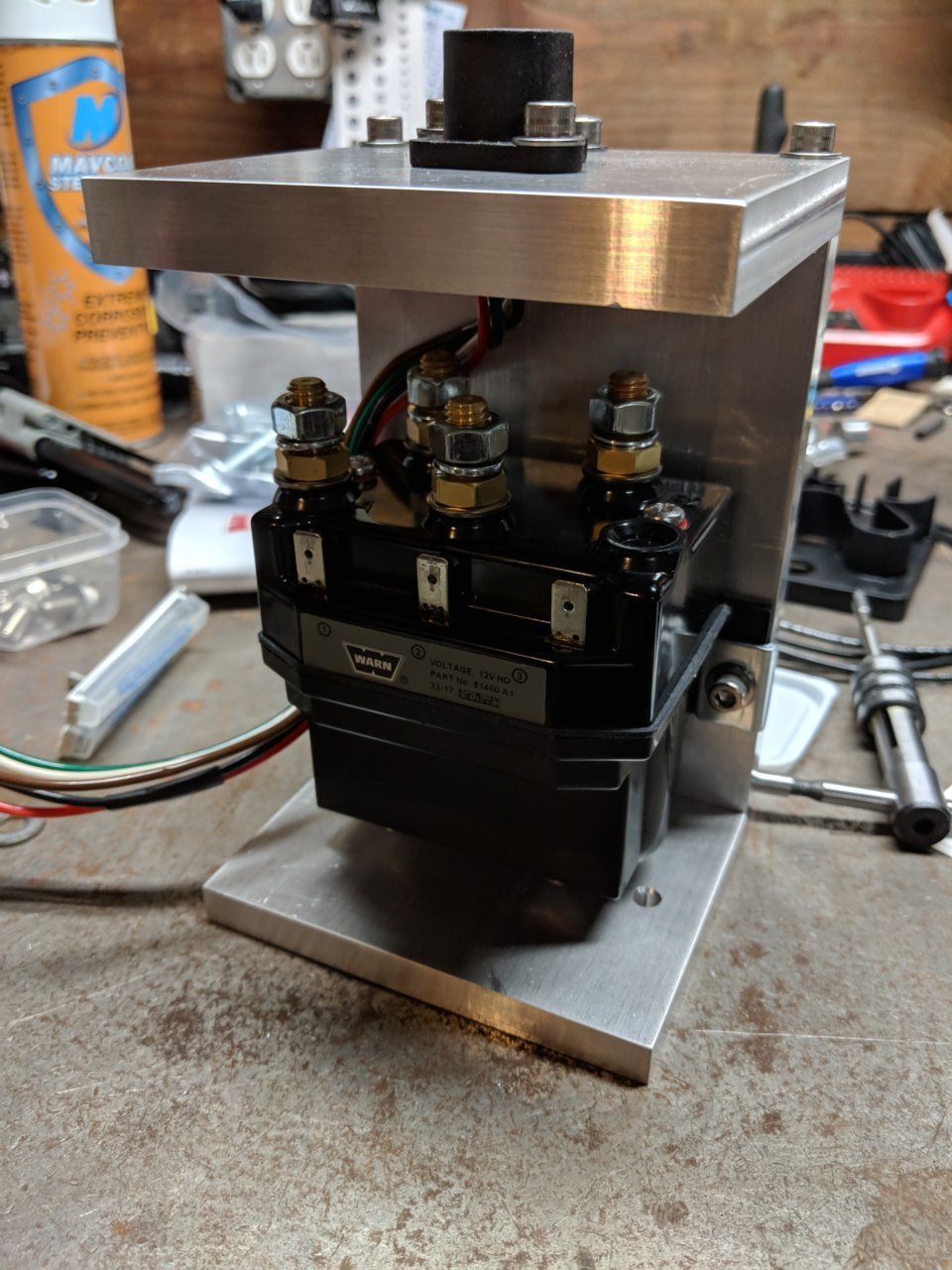

    Warn Zeon 10s Winch:

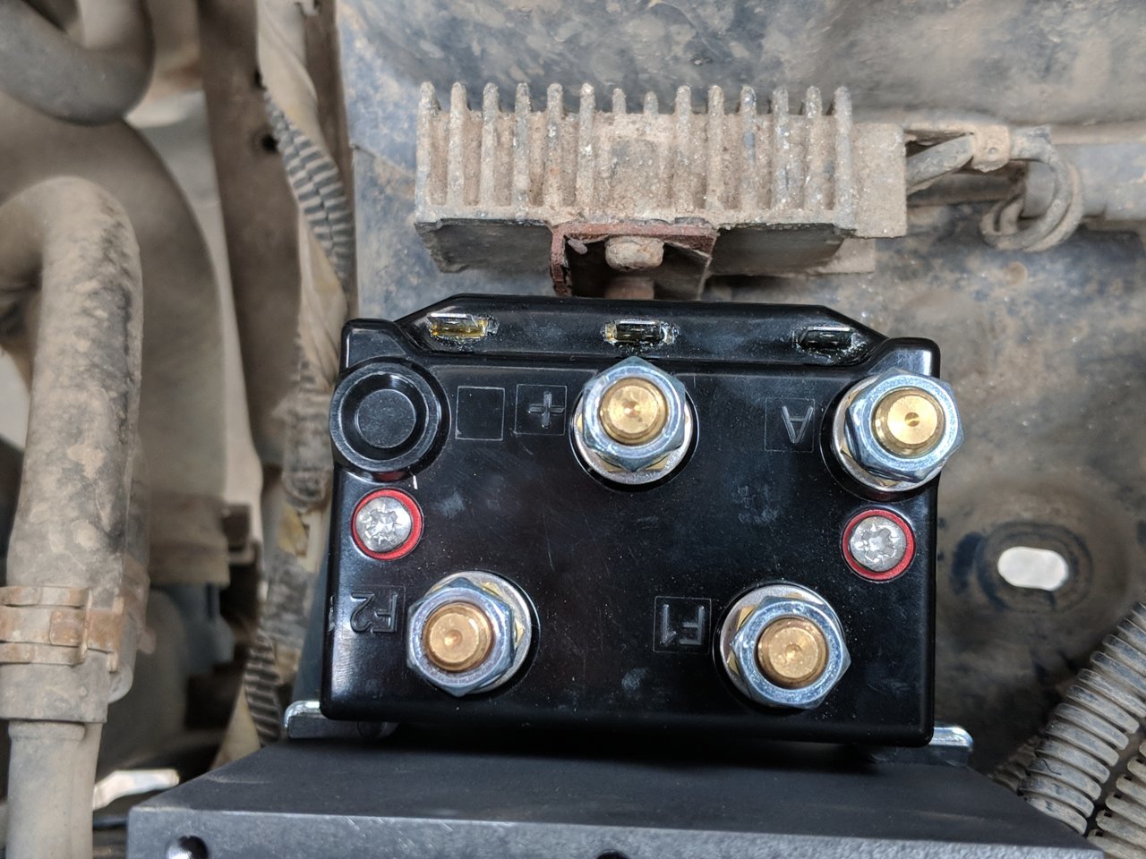

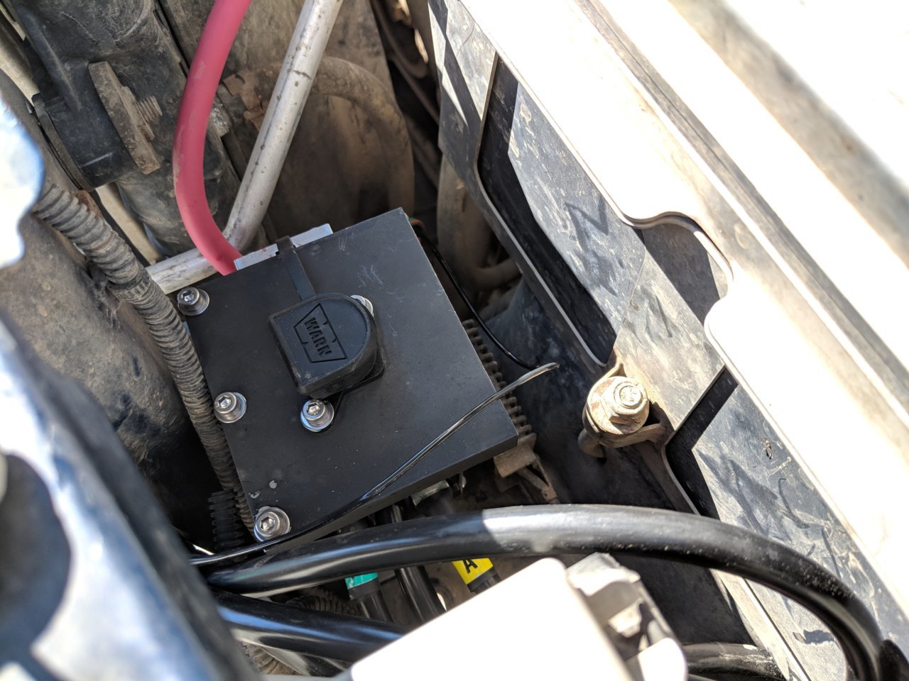

    Since I have the pelfrybilt hybrid I needed to relocated the controller into the engine bay - with the wire relocation cables I purchased for the winch it gave me a whopping 3 feet of cable limiting me to pretty much right behind the driverside headlight. I was unable to find a mounting point so I machined one up along with a bracket to hold the control plug. After some adjustments and test fitting the controller situation is solved. Onto the wiring...
    I decided against using the supplied power/ground cable because it was either way too long or just too short so I ordered some 2awg welding cable and terminals to cut custom lengths. In addition I could make the controller cables as well if need be out of 4awg cable but it should be long enough.
    Photo of the controller solenoid and plug hookup
    Mounted without the plug plate just for test fitting...

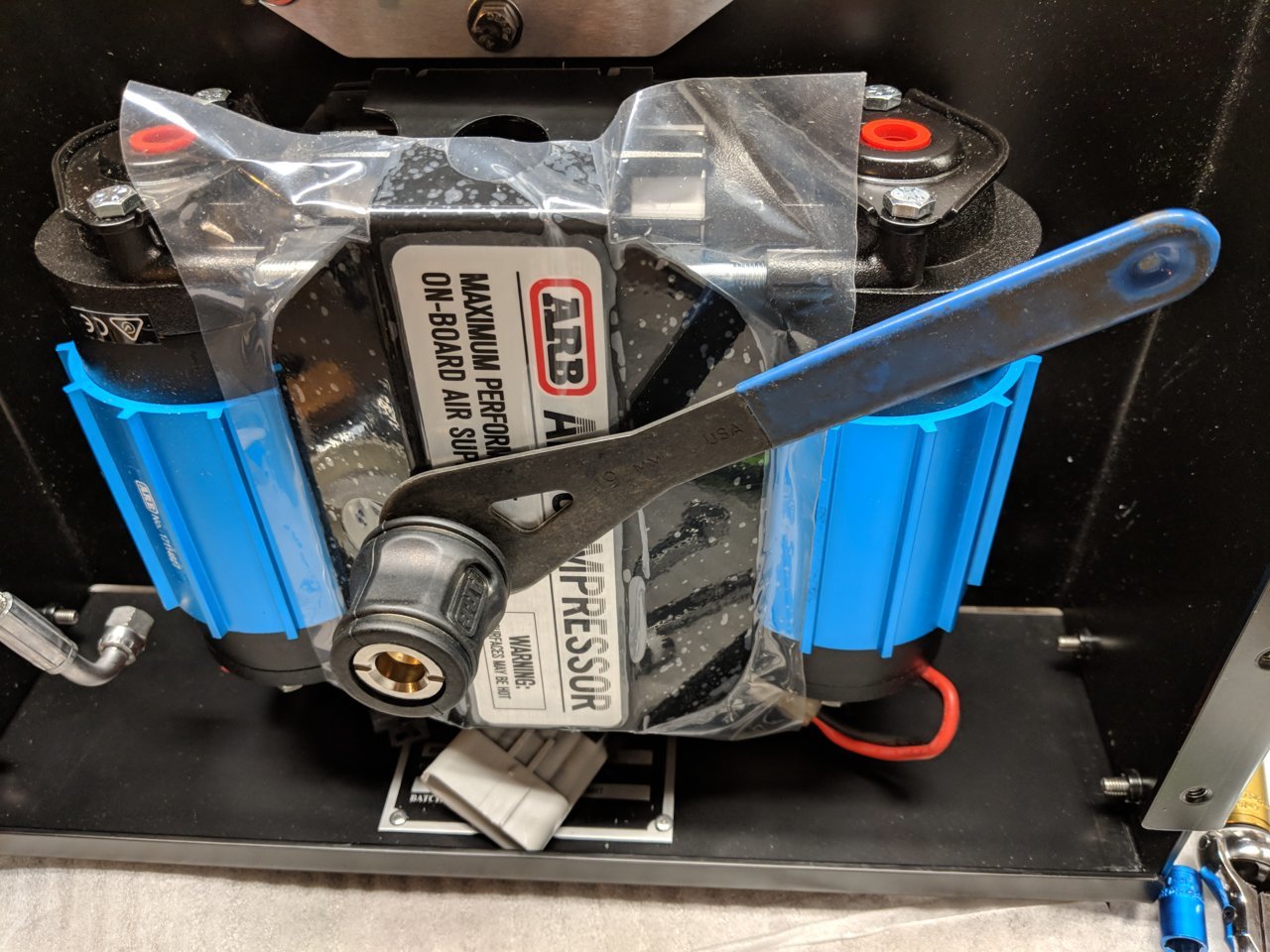

    Onto the ARB Twin Compressor...

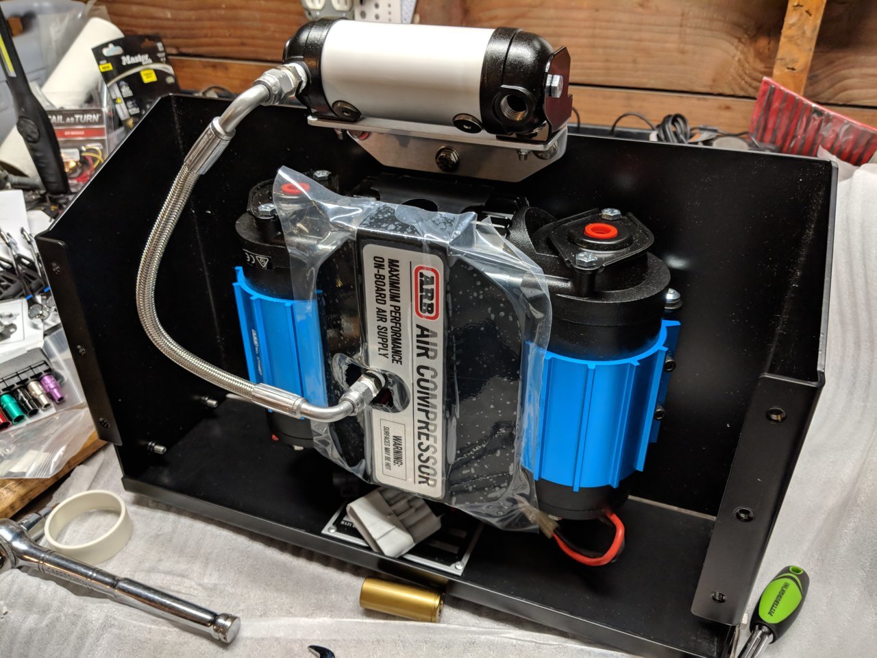

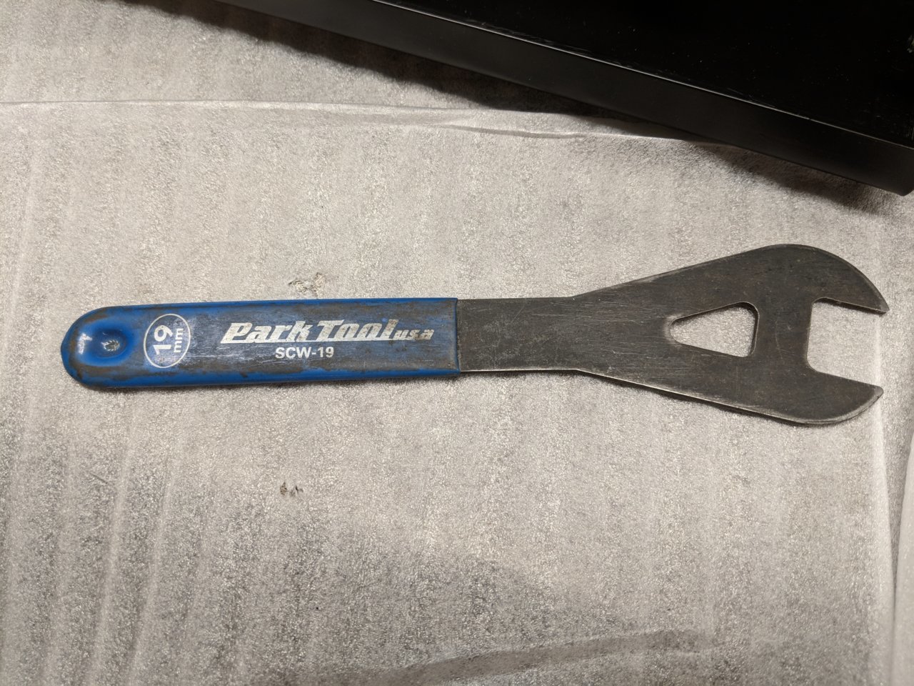

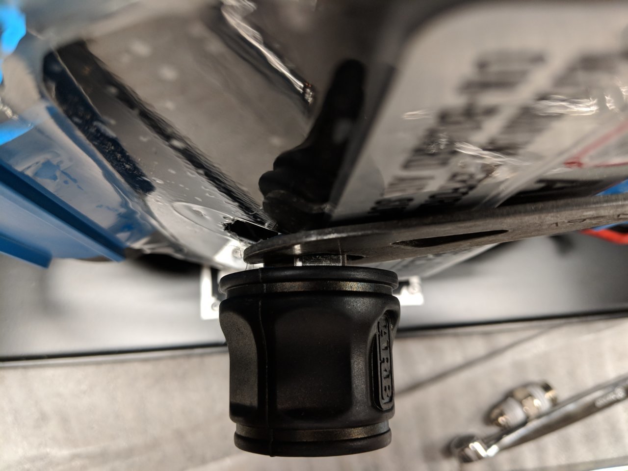

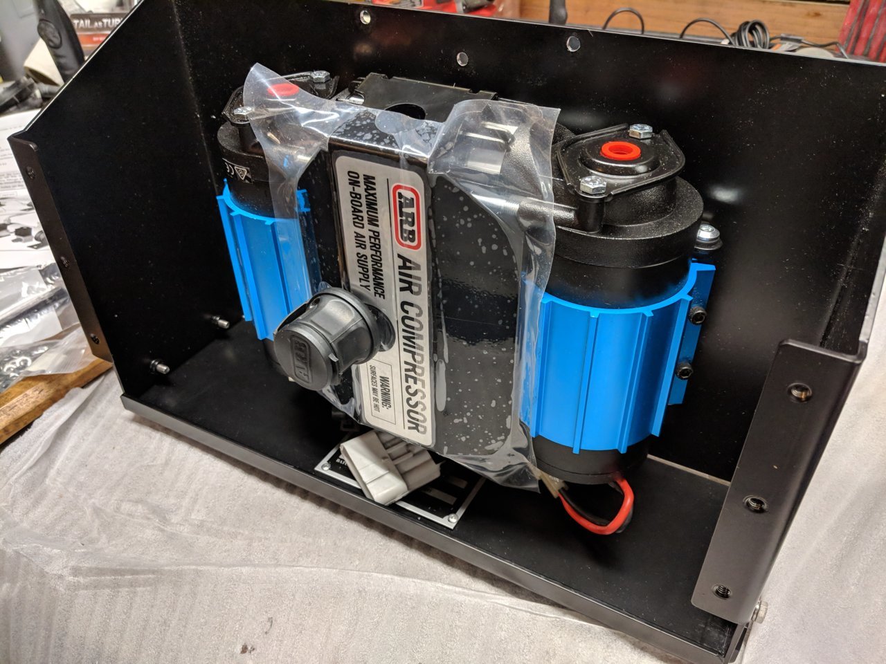

    I am mounting it in the driverside bed compartment using the Expedition Essentials [EE] bedside compressor mount. I purchased the ARB Manifold, EE manifold mount, coupler and air-up kit with everything as well. The ARB Twin compressor comes with about 4-5 feet of cable which is more than enough that I need so I bought matching connectors for both the 3-pin and 5-pin ARB harnesses. Both were metri-pack grade connectors listed below...
    5 pin power harness uses the following:
    Delphi 12084891 Metri-Pack 280 Series, 5-Way Gray Female Connector
    Delphi 15324857 Metri-Pack 280 Series 5-Contact TPA Secondary Lock, Black (specifically this one as the harness uses larger gauge wire)
    Delphi 12077413 Metri-Pack Female Tanged Terminal 12-10 GA, 280 Series
    Delphi Metri Pack 12129493 280 Series Female Tanged 14-12GA Terminal
    You will also need the corresponding cable seals for the cables as well however I'm still not sure what they used for the two power lines - I'll update when I figure that out.
    3 pin switch harness uses the following:
    Delphi 12110293 Metri-Pack 150 Series 3-Way, Female Connector, 14 Amp Max
    Delphi 12052845 Metri-Pack 3-Contact TPA Secondary Lock, Off-White
    Delphi 12084200 Metri-Pack 150 Series Female Terminal Loose Piece, 22-20GA
    Delphi 15324973 Metri-Pack 150 Series Cable Seal, Dark Red (specific for 18-22awg wire)
    Another thing I noticed was if I were to run the ARB manifold I wouldn't be able to quick connect an air line as the mounting point EE offers for the manifold puts it above the assembly out of reach from the bed. I would need to run a line and put a remote connection point which isn't that bad of an idea so I might go this route someday. For now I won't be mounting the manifold and will just connect straight off the compressor. I did order the remote airline fitting brackets and hardware - I just need to figure out what length line I would need and where I would mount the tap to.
    One thing to note about the ARB compressor and the ARB Coupler - there isn't much room to get a wrench in behind it to tighten it down, luckily I had my old bicycle tools and a flat wrench (19mm) to tighted then fitting down as seen in the photos below:
    For now the winch and compressor hopefully going to be installed this weekend - pending the arrival of a new lift table that I'm purchasing tomorrow night off craigslist. Hopefully that will help me remove the bumper without needing additional help.

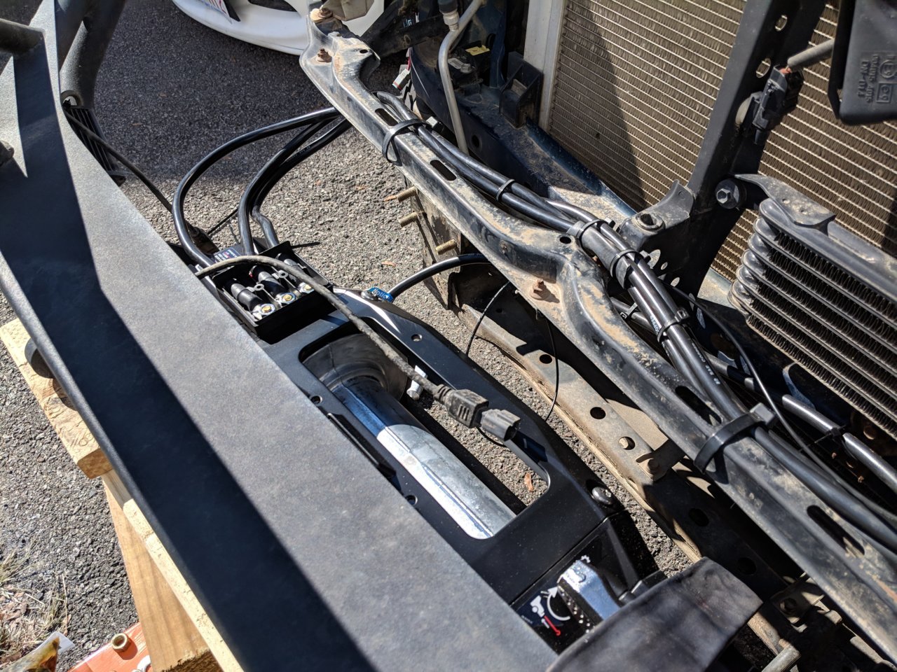

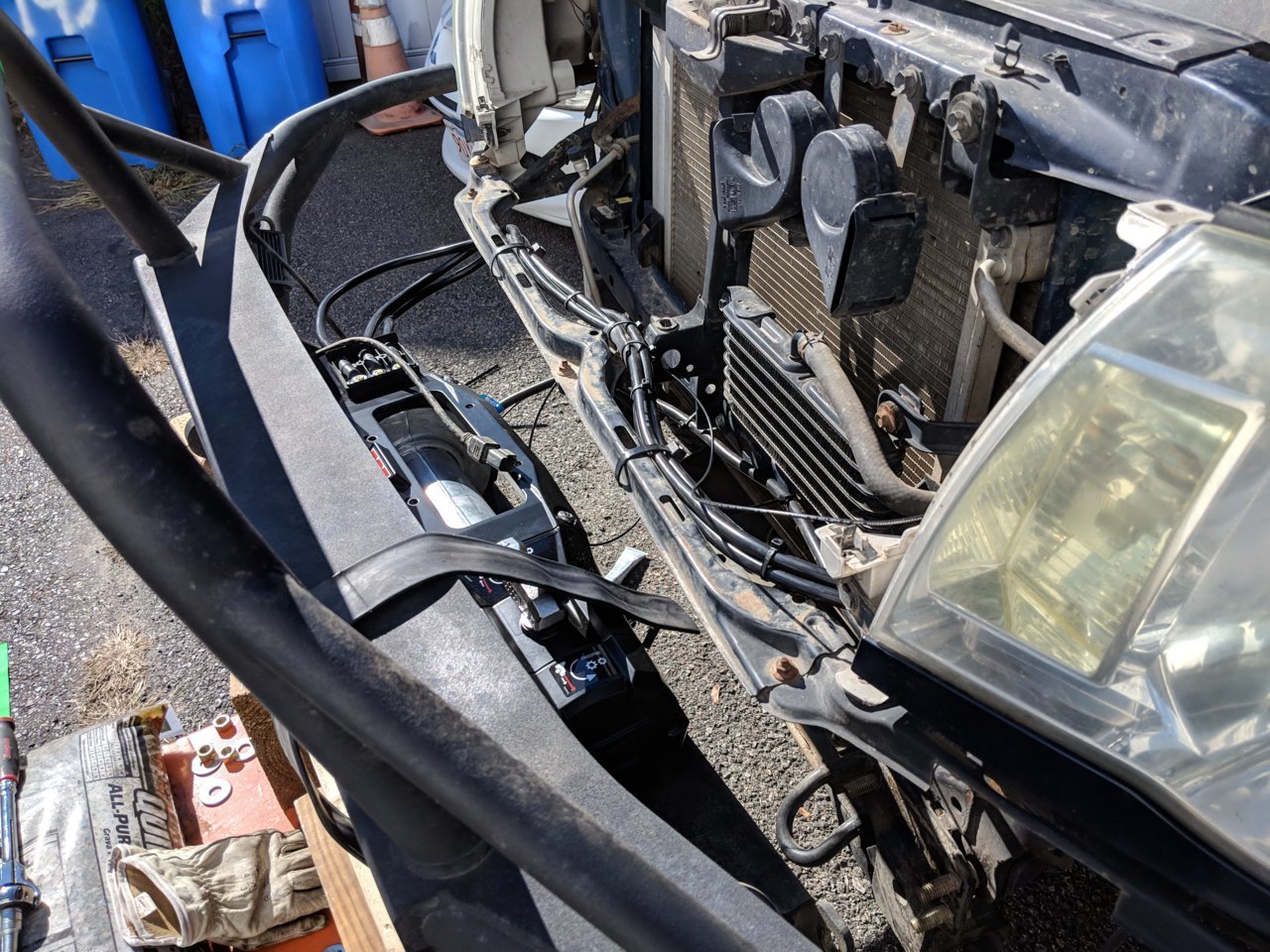

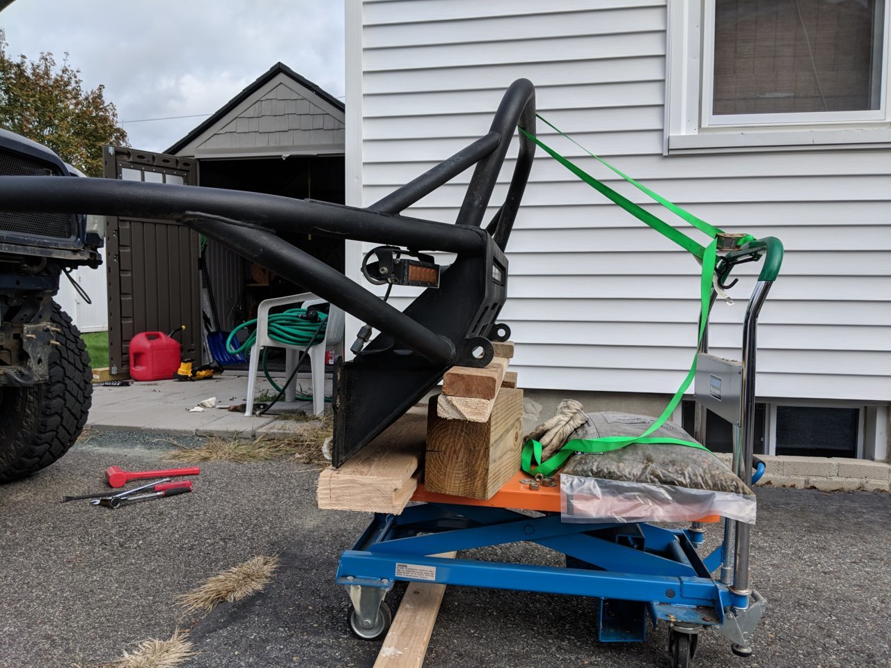

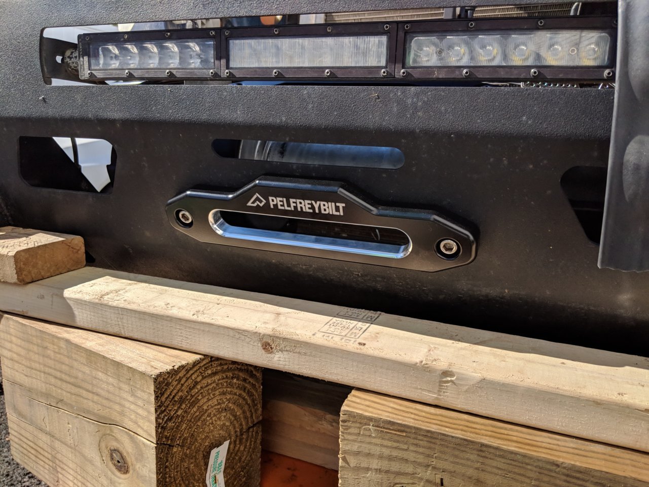

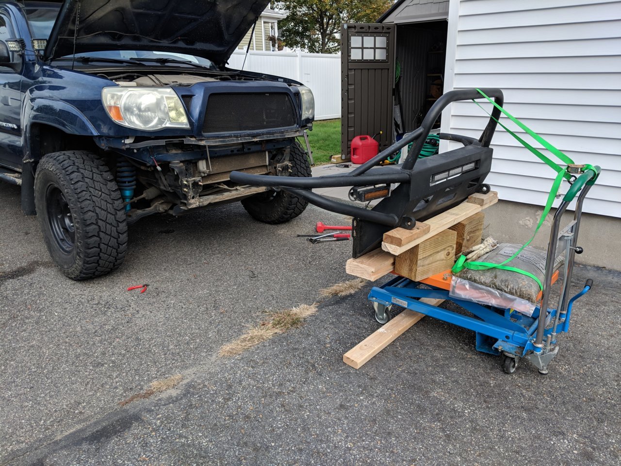

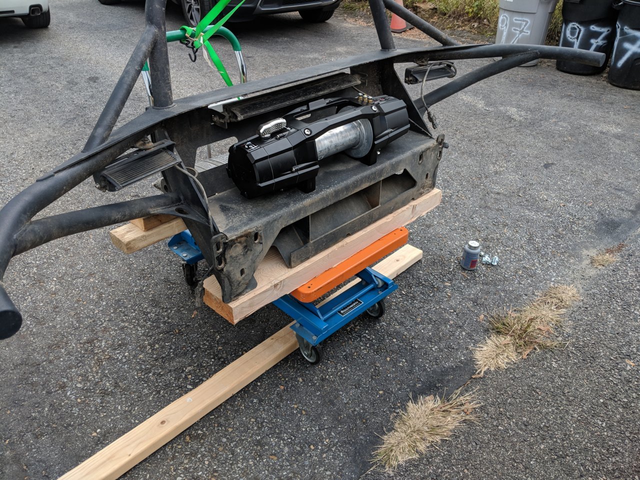

    Didn't get around to doing the ARB Twin Compressor install however I did get the winch in! I just need to tension/stretch it tomorrow.
    I bought a lift table specifically to help remove the front bumper without needing to phone a friend. After running the wiring, test fitting my Solenoid bracket/switch setup and cutting a custom length power line (I'll relocate it better when I get a chance - I really need to figure out a way to tap off the battery more efficiently instead of having 4x lines feeding off one post) I finally mounted it all back up. Initially the bumper/headlight support brace was hitting the winch which has the bumper sitting a bit lower just for clearance sake. I'll have to address that at a later time though.
    Here are the photo's from today's progress - I currently have about 50 zipties under my bumper holding the wiring up and tucked.

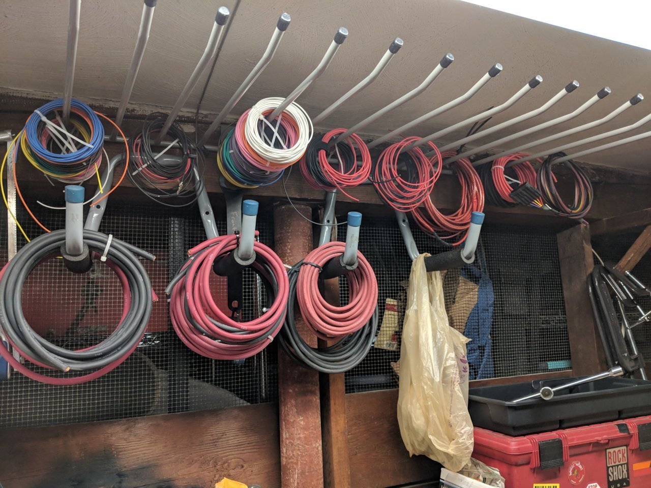

    I also spent some time organizing my electrical workshop area, originally all the wire was just sitting in a bin and it was super unorganized now I know what I have and need to replenish. Same goes for the socket cap screws which I just forked up for a pre-assembled assortment.

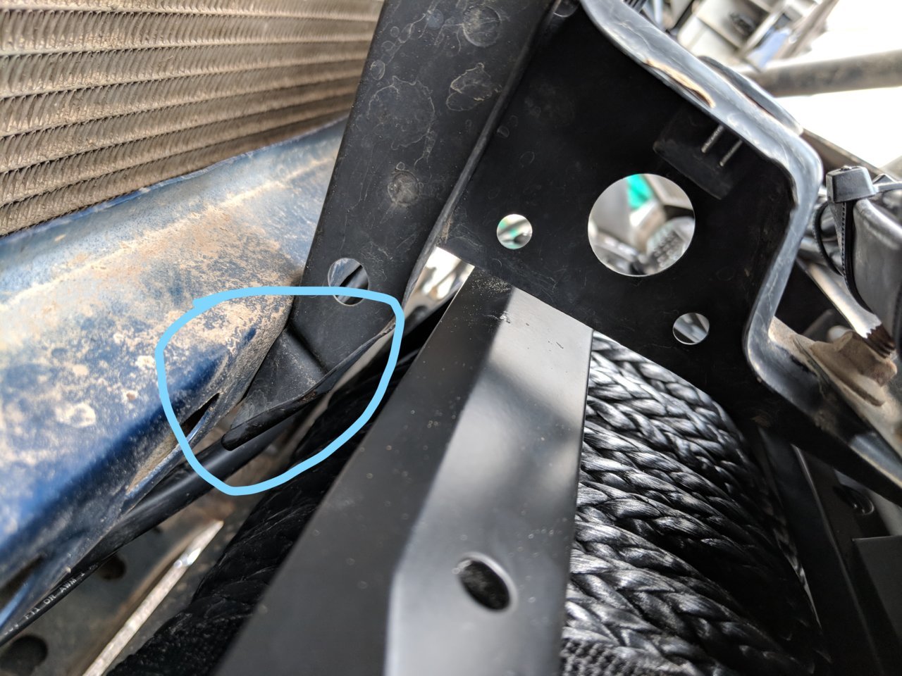

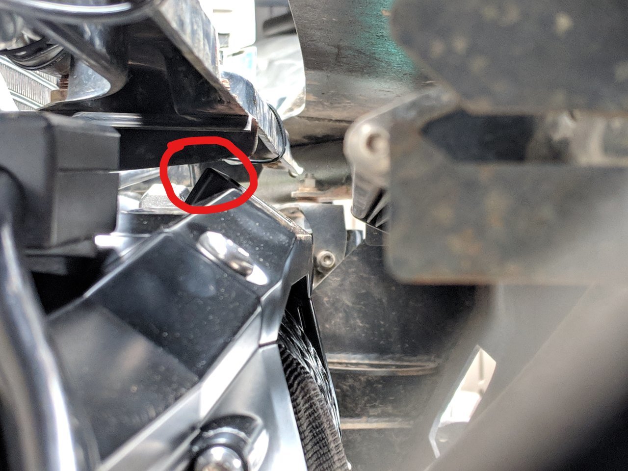

    You can see here where I was having issues with the winch hitting the bumper/headlight support - these photos were after I adjusted it, unfortunately now the lower portion of the bumper sits low enough to create a lip that could potentially snag on things if I ever need to back off a obstacle.. I'll have to address this at a later time.

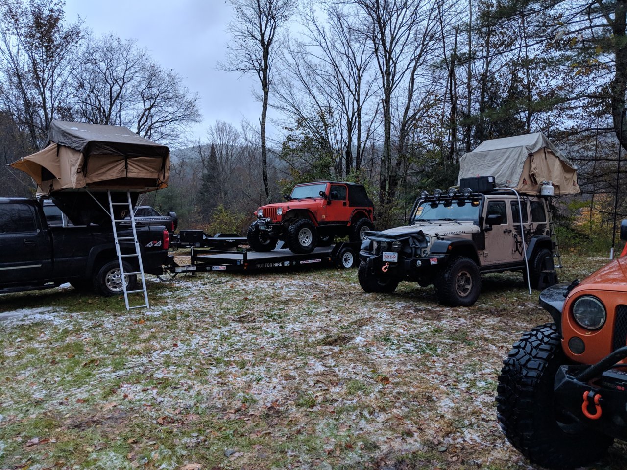

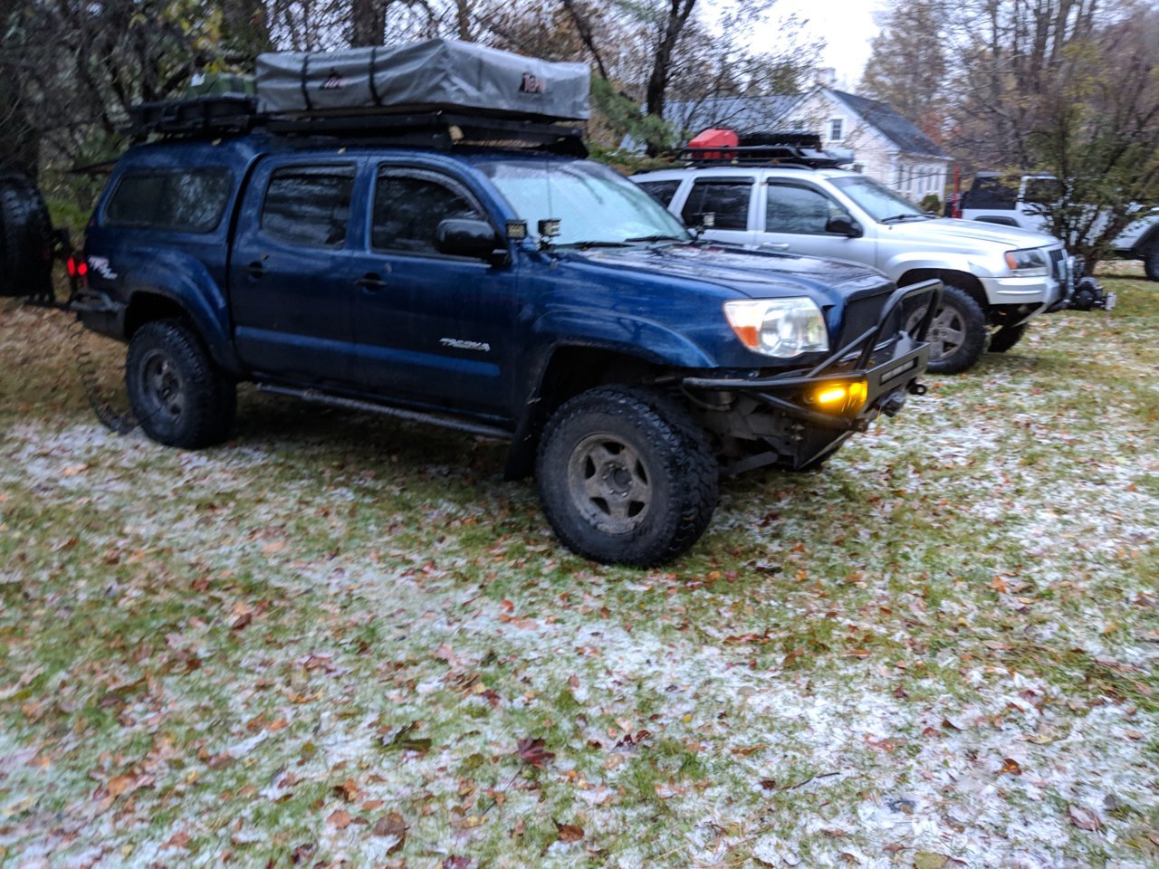

    October 28th, 2018.

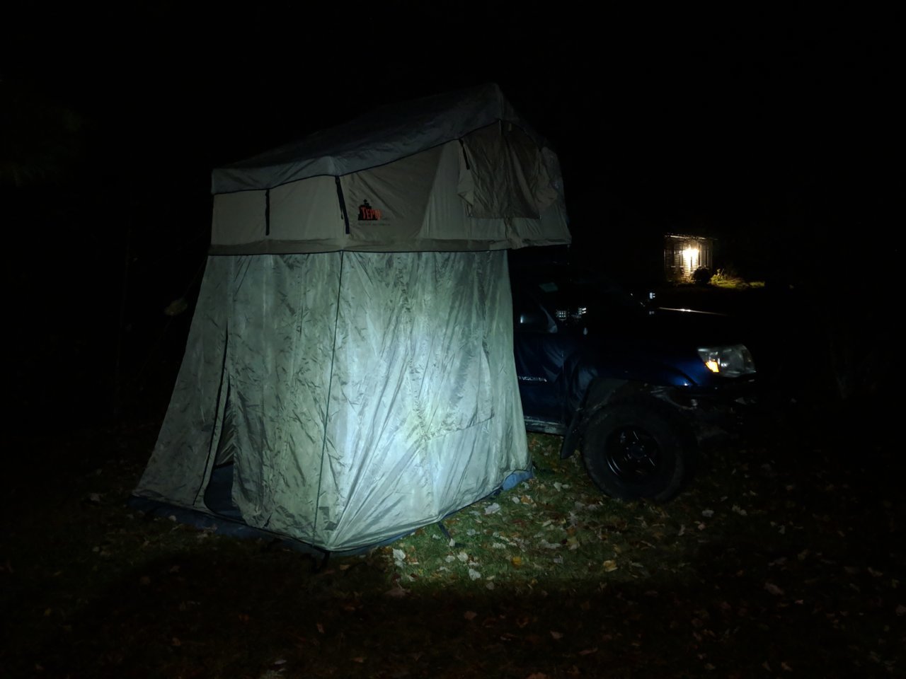

    Did my first colder weather (30 Degrees F) camping in the Tepui RTT.
    I bought a new Teton Sports Fahrenheit Regular 0F Sleeping Bag... which I figured would be sufficient along with new medium weight REI branded base layers.
    Needless to say I need to re-assess my sleeping gear for winter time. I have ordered some items to help insulate the tent a bit:
    1) Emergency Blankets - Double layered - to line the ceiling of the tent along with the sides. I'll try sewing some velcro clasps on them to attach them to the poles
    2) UCO Triple Candle lamp - supposedly could heat the tent almost 10-20 degrees warmer depending on the tent size. I'll have to crack the door into the annex to allow for airflow to come in.
    3) Mr. Heater Buddy - I actually bought this before my trip, when I was setting up the inside of the tent I had it running on low and it was super warm, almost too much but I started getting a bit light headed and had to step out - people have said they shouldn't kill ya in a tent since they're ventilating - I think otherwise. I'll leave it for heating the annex but the main tent with the flaps down is too risky.
    Sorry not to many photos...
    This was an ExploringNH Fall Crawl:

    Man it's been a long time since I have updated this...
    July 2019 update:
    I have driven the truck 2-3 tanks of gas since March due to being gone so much for work travel...
    Well that's about it for the update...
    Thanks for following!

    Thanks for reminding me about this post. Sorry about the ramblings to come.
    The LCA's are holding up wonderfully especially with the whiteline bushings. I do spray them with some tri-flow every month with/without driving the truck. Currently I'm at 167k on the truck and I installed the LCA's with the whiteline bushings and proforged ball joints at around 135k. I did have to replace one proforged boot at 140k which wasn't torn it had popped off the ball joint and wouldn't reseat properly. Proforged sent me an entirely new ball joint so I just carefully popped the boot off and swapped it. The ball joints were a B1tch to install - I had two different shops try to press them in but in the end I had a machine shop press them in. The paint hasn't held up the best, I wish I didn't use the LCA skid plates as it just caked mud/moisture causing it to eat through the paint faster. I don't expect them to rust out at all but they just look gross.
    Overall update
    The new leaf packs are doing great - they are blackout14's(spelling?) but he's no longer a vendor on here - I did shear off one of the nuts holding the retaining sleeve on the passengerside. I reached out to him on IG and he sent me a replacement with instructions (Haven't done the swap yet)!! The truck does have a clunk, I can't figure it out for the life of me and I'm getting a good amount of rub left/right on the cab mount chop which means my buddy didn't cut them back enough and I'll have to get that redone - I have new plates just haven't reached out to my fab guy. I replaced the passengerside wheel bearing at 165k which was previously replaced at 130k. I know between 130-145k there was a ton of hard off roading done for those periods so I'm not shocked it went after 35k. Which reminds me I need to order another backup wheel bearing assembly....
    I'm starting to wonder if the kings need a rehaul, the front seems to be sitting an inch lower than it was previously. In the past I have had to adjust the kings to compensate for the "break-in sag" but I don't think I have ever had to re-adjust unless something is wrong with the suspension.
    I installed Diode Dynamics SS3 Pro's in replacement of the Diode Stage Series 6" bars and holy crap are they bright. The cutoff isn't as good as the sports but they are amazing at night. I can basically drive around with the headlights off (not that I do). I took the truck out one night in a rain storm into the backroads and the fogs made a huge difference. I aimed them a bit lower than the headlights which was supposedly the ideal legal method.
    Since picking up a daily and travelling 60% of last year I have only put 4k miles on the truck since dec 2018... I drive it once a week now to/from running errands however I might do some camping next month since travel is on hold indefinitely this year.
    Things to do:
    - Figure out the clunk...
    - Start saving to get the King's front rehauled
    - Finish rebuilding my backup LCA's
    - Install the Expedition Essentials TPAM
    - Install ARB Bedside compressor w/ Expedition Essentials Mount/debris cover/etc
    - Diagnose the e-locker and or replace the actuator
    - Replace Plano All Weather box on roof rack with new one and hope that it really is all weather
    - Order backup wheel bearing assembly
    - Rebuild spare driveshaft with joints/carrier bearing and swap in
    - General maintenance...
    And finally
    Use the damned thing...
