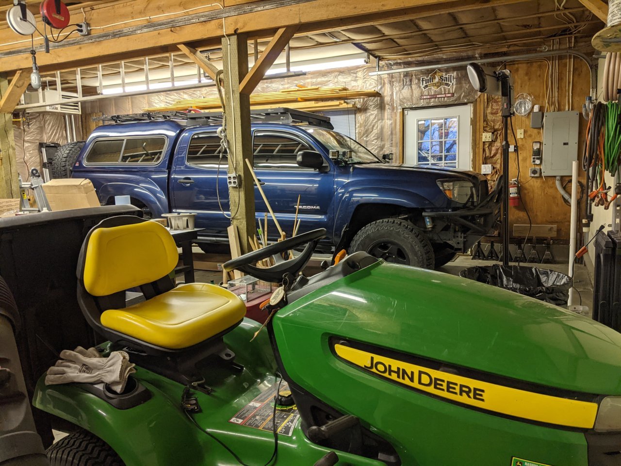

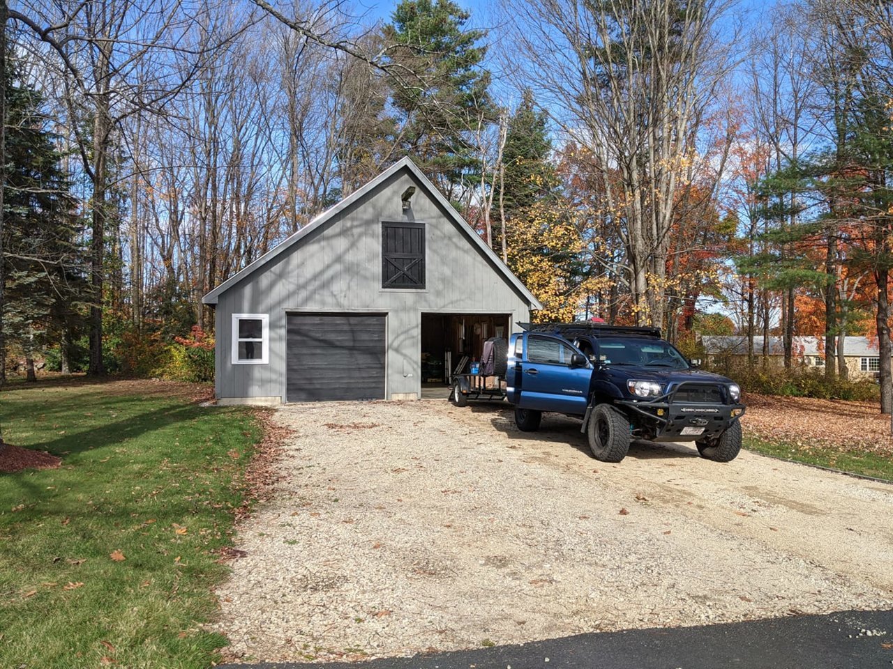

    New house (as of Oct 2020) - new to me barn - truck fits in barn with the RTT on top too.

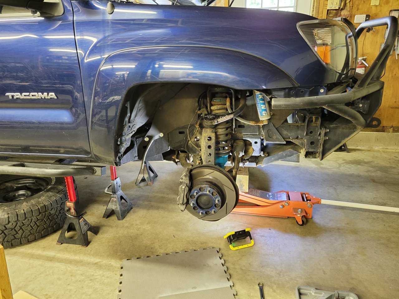

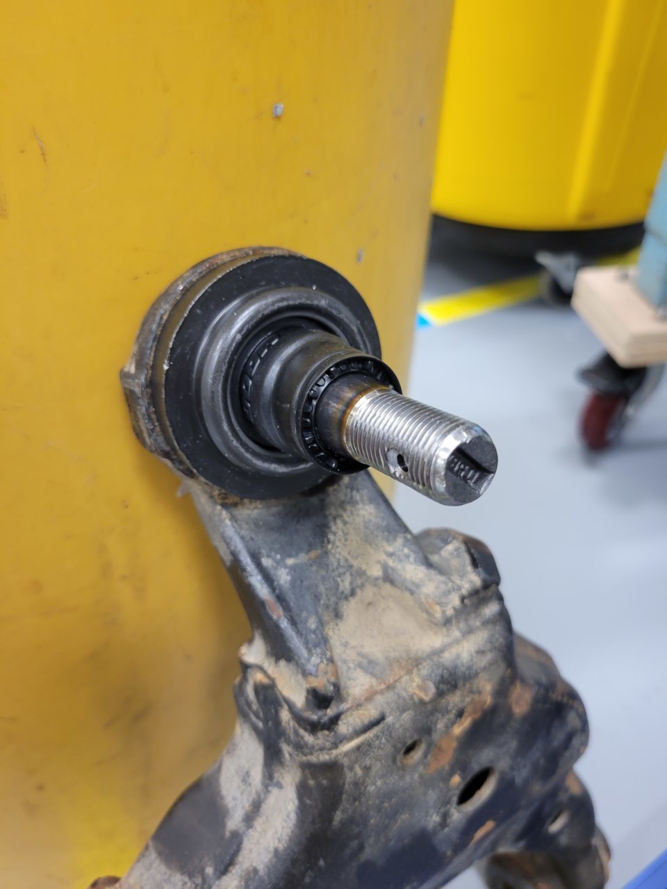

    As for the truck I did a bunch of general maintenance. Pro-forged lca ball joints are shot on both sides (wicked bad on the passenger side) so it's in pieces and hopefully pressing in a new Moog ball joint tomorrow at work.

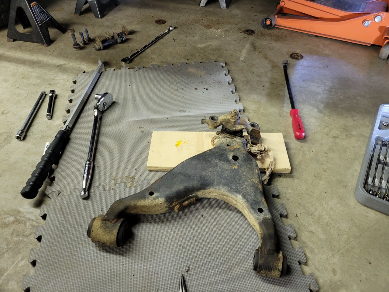

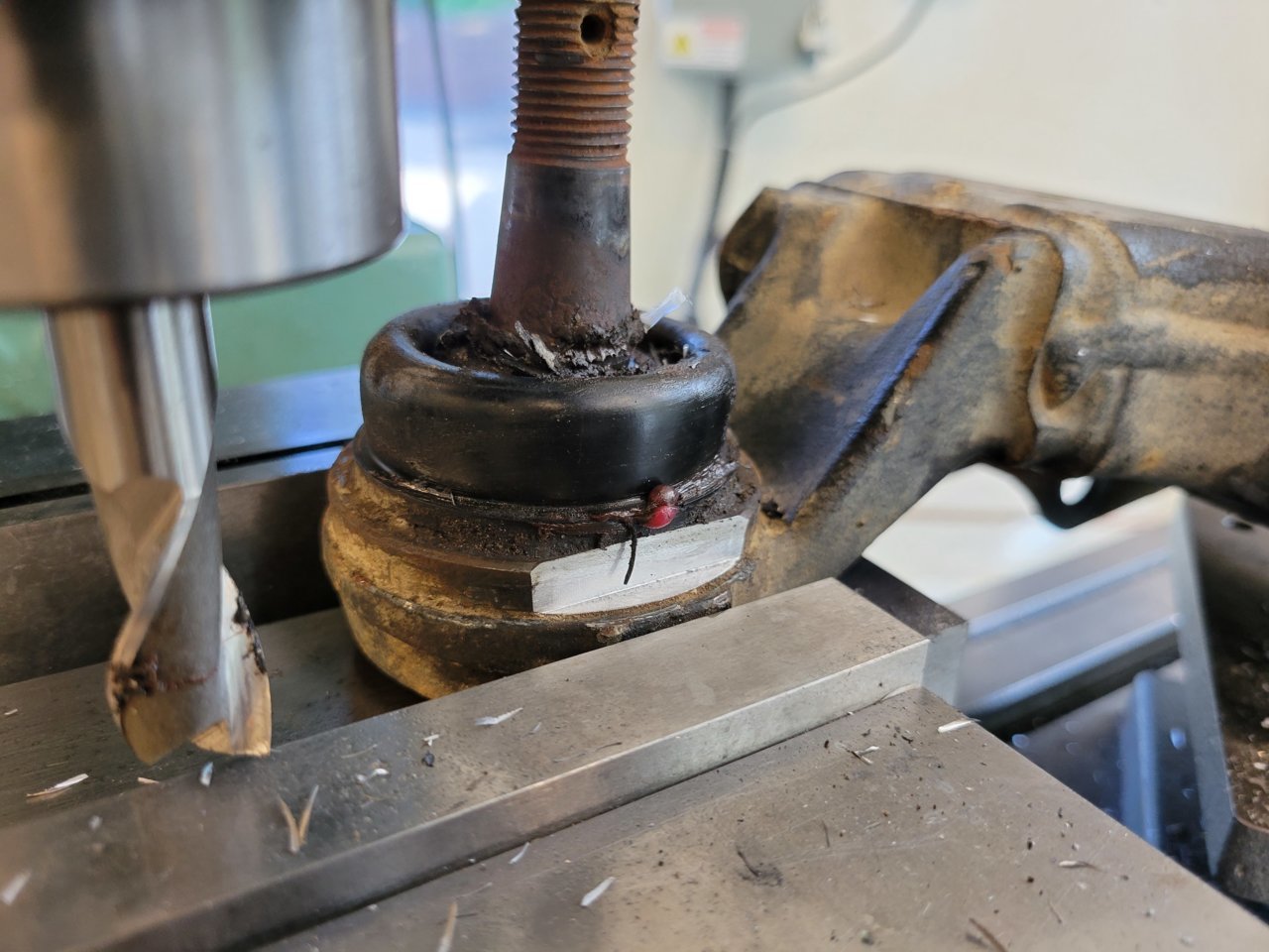

    Pro tip - can't find a flat surface on the lca to press out the ball joint? Just machine it down so that you have a flat surface.
    Also a 60 ton hydraulic press...
    New Moog ball joint in on the passenger side. Will do the driverside in a few weeks, just need to clean the alignment hardware, re-neverseize it all and reinstall.

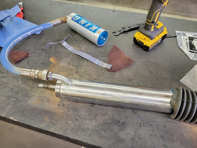

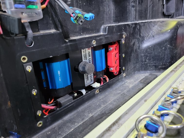

    Well it's been a few months since I updated this...

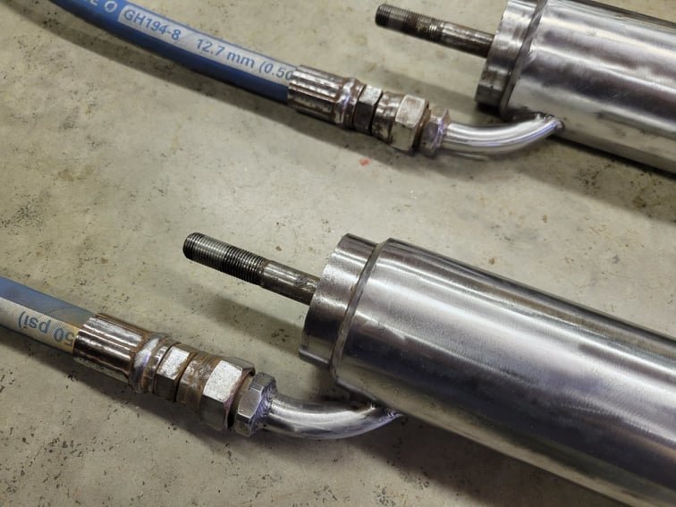

    So far I have done both the other LCA ball joint with the newer designed MOOG "internal boot" setup. I noticed some wear and a bad bushing on the King Rear shocks so I went ahead and sent them in for a rehaul. Just got those back yesterday and have begun the tedious process of stripping the corrosion/buildup on them off and repolishing them. After that I'll Steelit the line connectors and clearcoat the shock body with hopes of prolonging the cosmetic appearance of them.

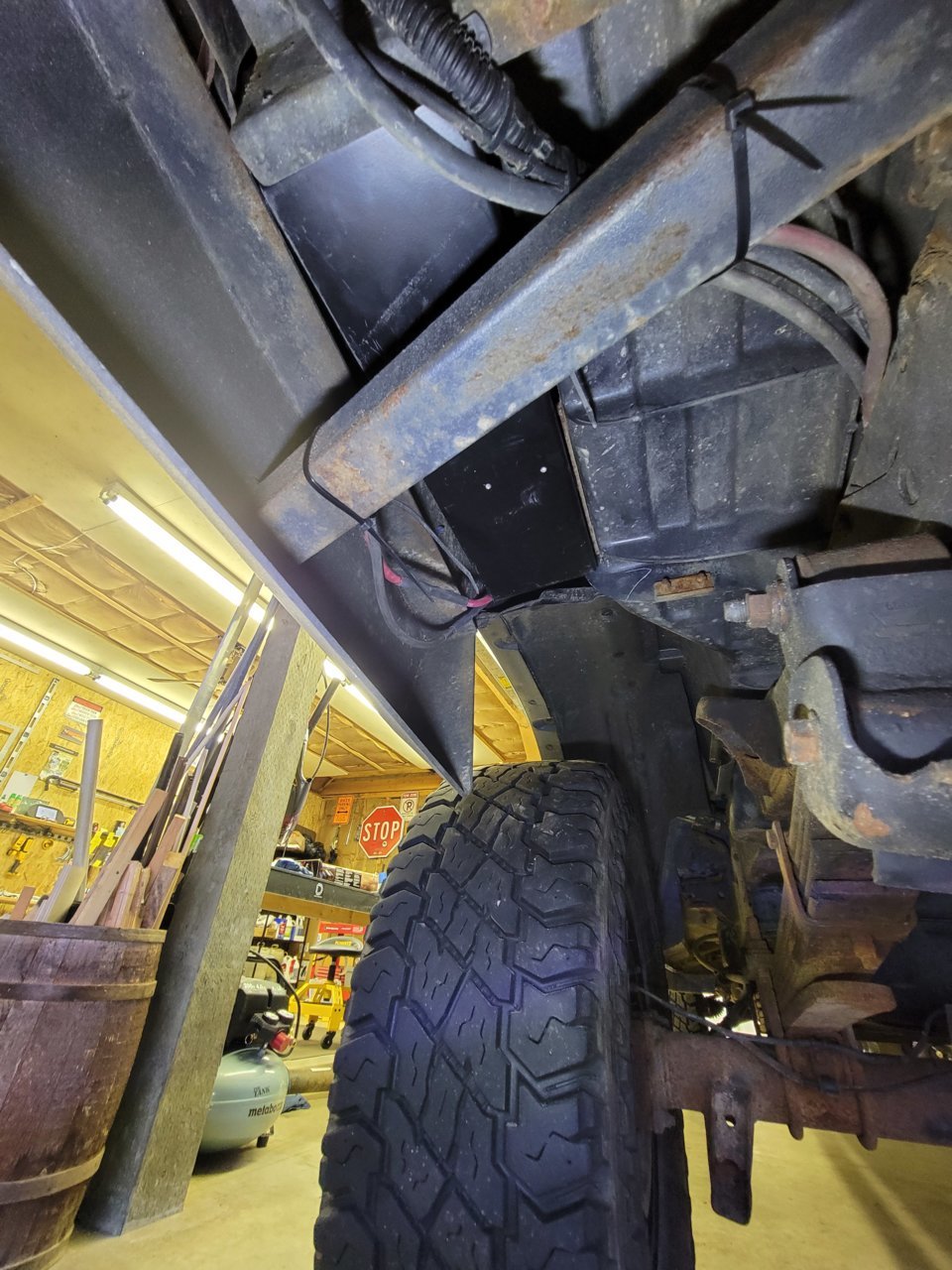

    Also installed my ARB twin compressor in the expedition essentials bedside mount w/ dust shield. Currently waiting on my order of fender liner material to come in so I can custom make a fender liner on that side of the bumper to keep debris/dust down. Also need to run a dedicated line for the compressor as the #4 wire isn't enough juice for both the compressor and misc items I have running in the bed.

    Phase one done - removing build-up and majority of the rust...

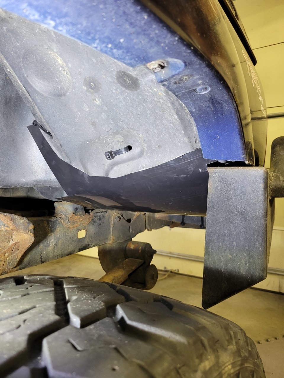

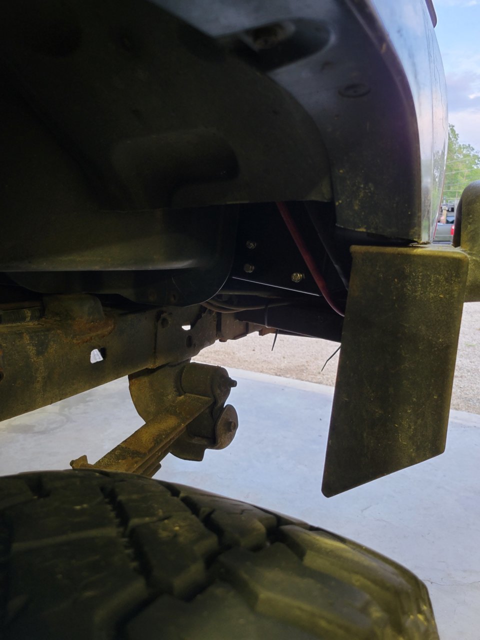

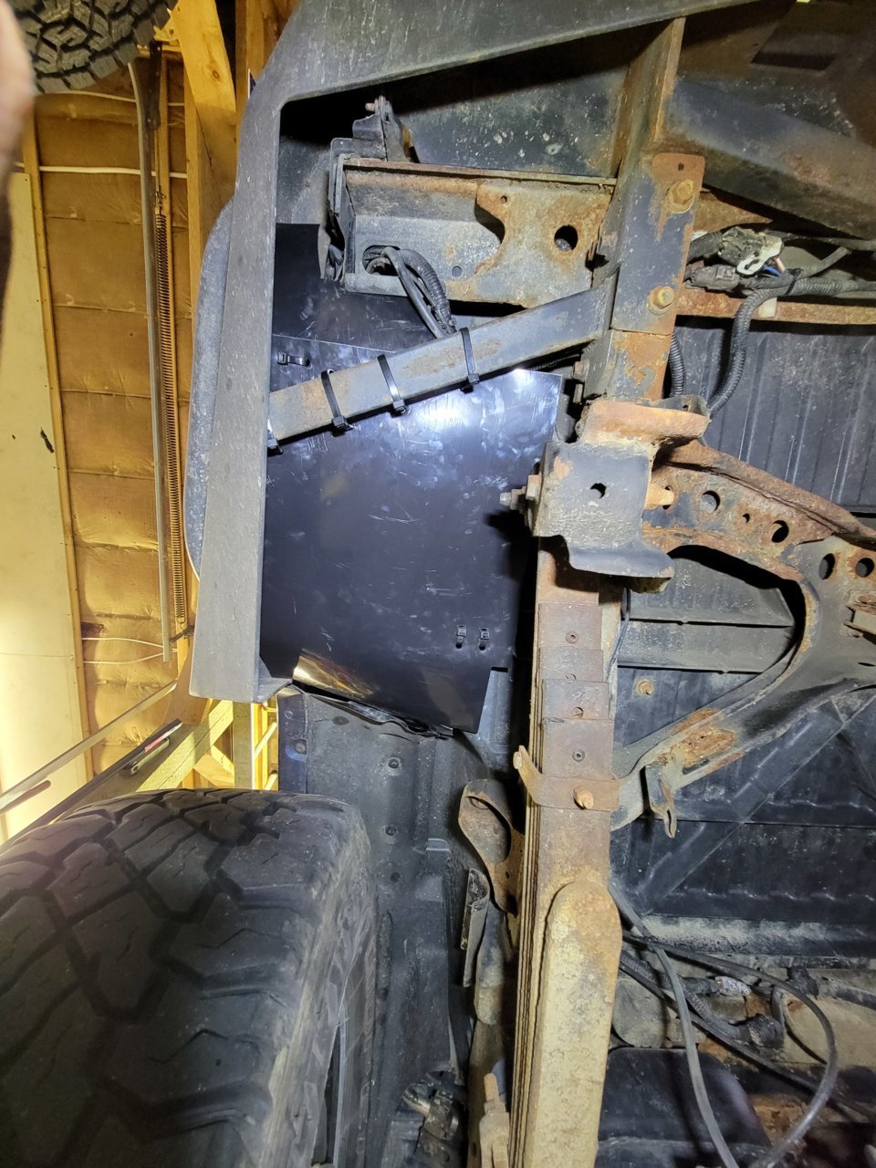

    Finally got the material in to do a custom fender liner in the driverside rear now that the bedside compressor mount is in. Before and after photos... Excuse my rusty undercarriage....

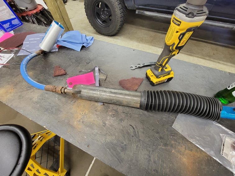

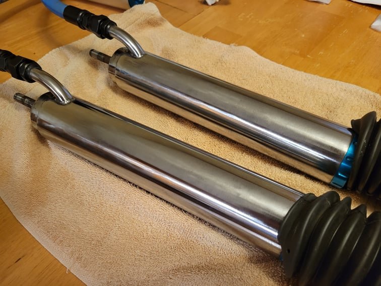

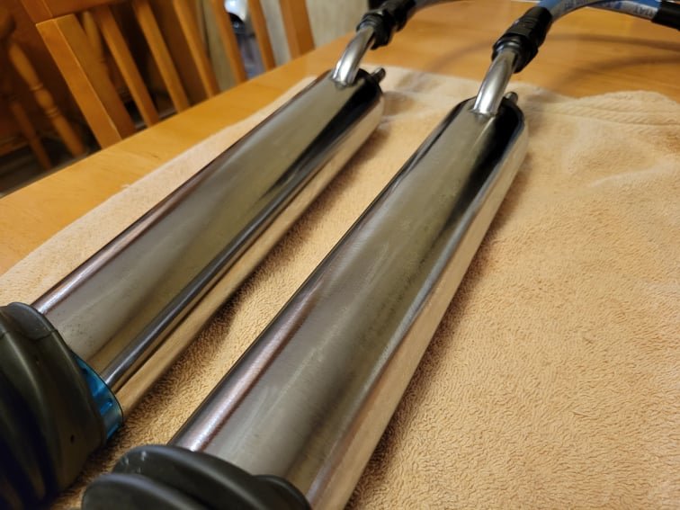

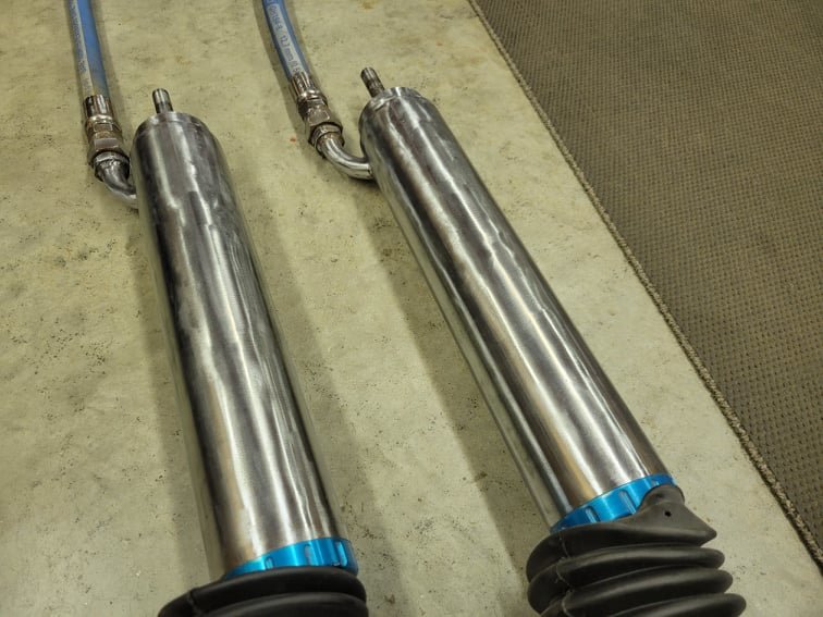

    Rear King shocks polished, clearcoated and reinstalled with new boots from Kings. I know the boots look horrible but they'll protect the shafts from pitting which was a failure point for me. Currently the shiniest thing on my truck....

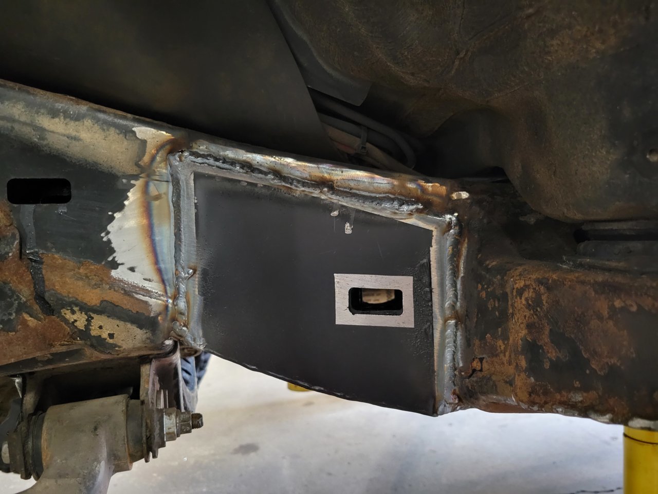

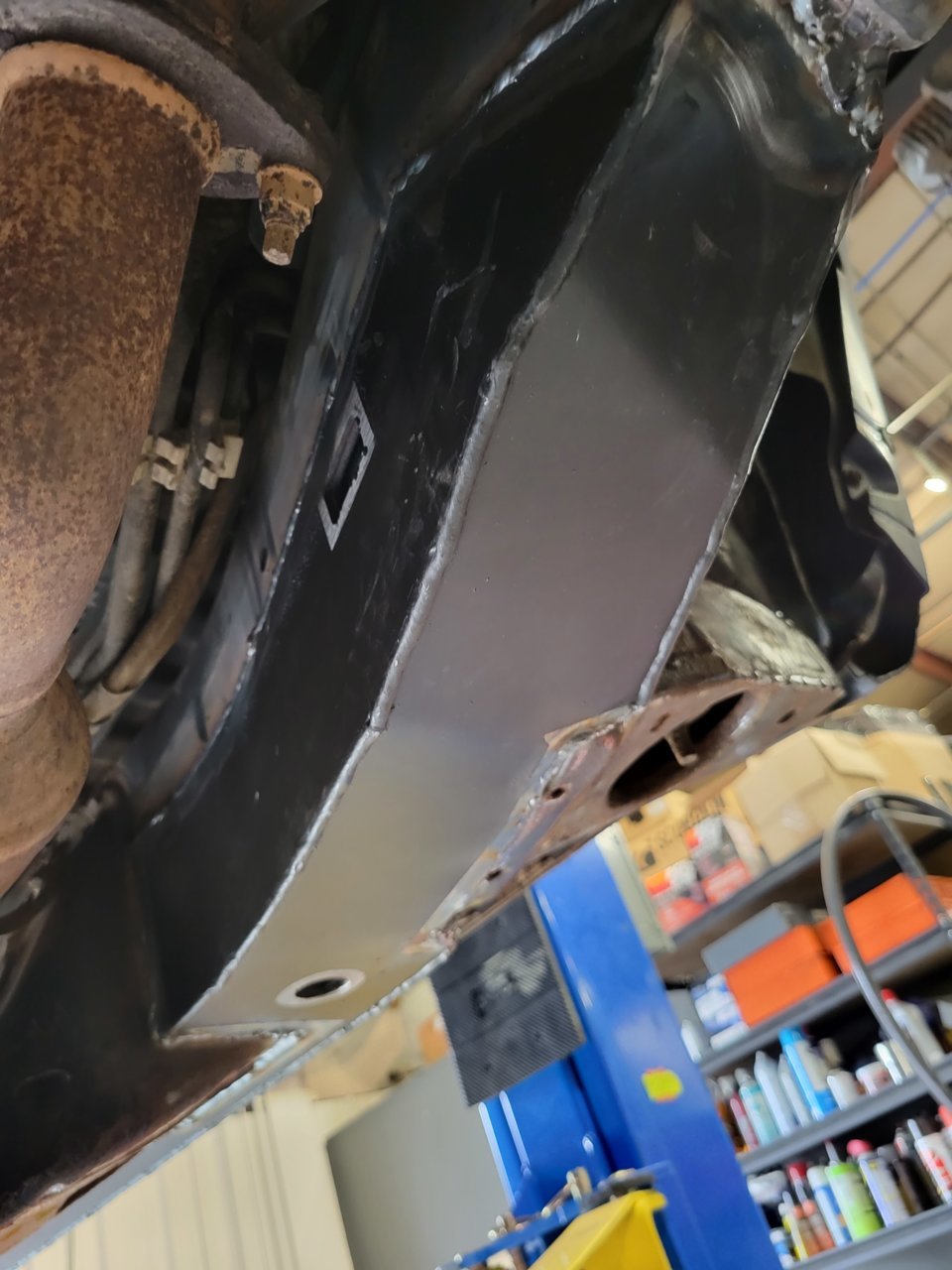

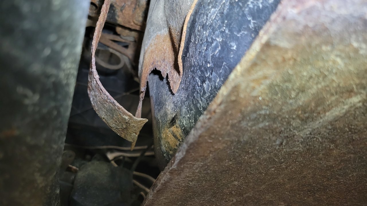

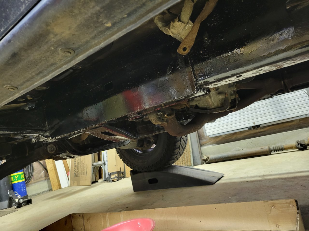

    Well it's been a while - been doing a ton of Rust remediation on the truck and then I discovered some rot on the driverside
    It has literally been exactly a year (and a few days) since the passenger side front part of the frame rotted out near the cab mount, now it's did so on the driverside. After cutting it open, patching it and then painting the inside of the frame with internal frame coating I started painting the rest of the frame with Chassis Saver. Chassis Saver can be painted right on after wire brushing the frame and then degreasing it. I used a wire brush and some marine clean to degrease it then painted two coats on whatever I could reach without pulling the cab or bed off. Later this year I'll pull the bed off and do the rears. I just realized now that they offer a non-gloss version.... But gloss works.

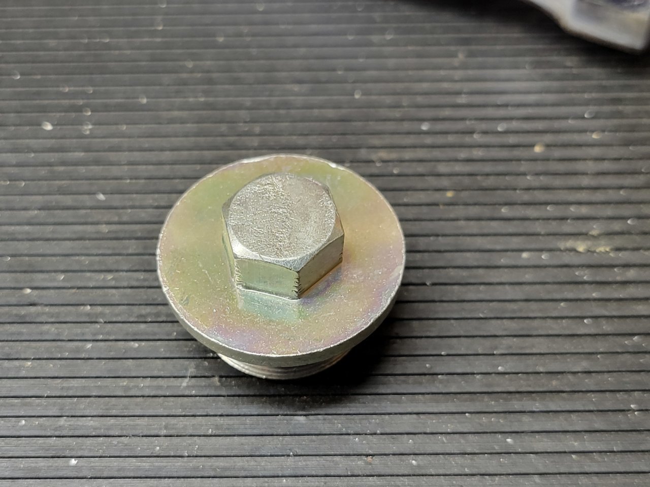

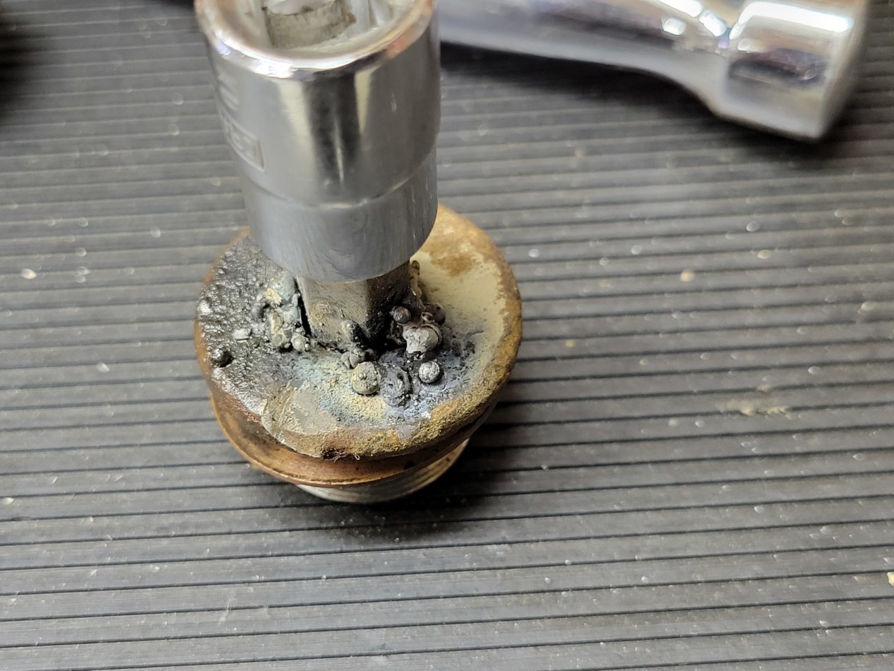

    I also did a front diff flush and finally removed the stuck/stripped drain plug by tacking on a spare socket, replaced it with the Lexus equivalent part which has a nut head (see photos).
    I got all the skid/sliders mounted again so she should be ready for some wheeling adventures this year. I still need to do more frame painting on the passenger rear but for now she's road worthy.
