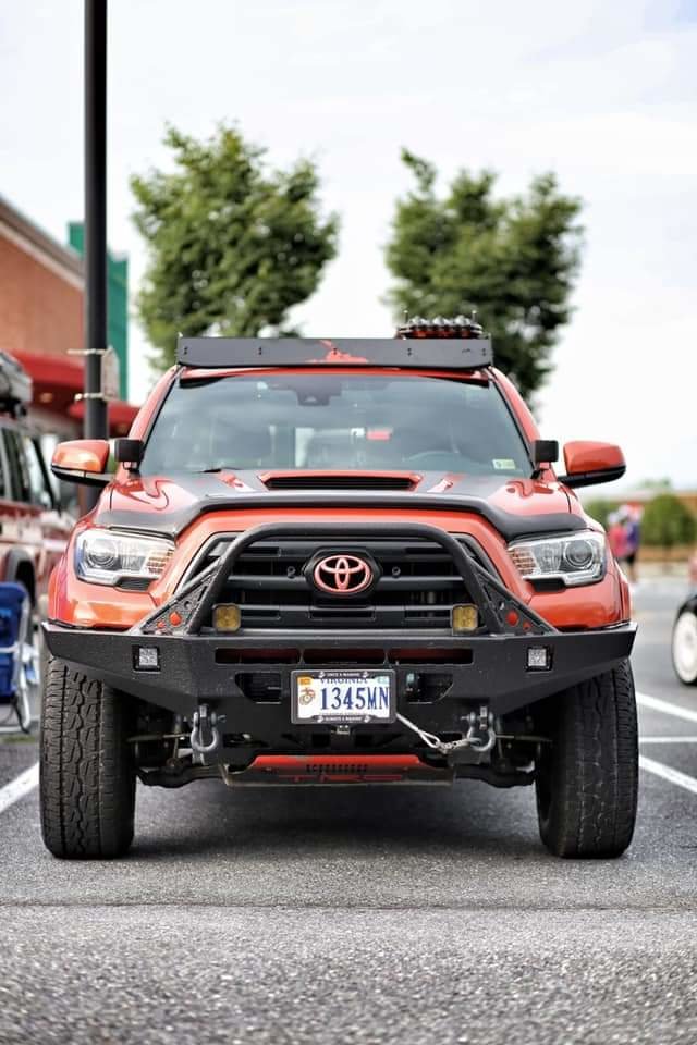

    You still don't want to hit anything with much force with that. The upper mounts can push back to your radiator mounts and take that out. I had one and got rid of it for a full winch bumper.

    First, here's a thread on plate bumpers I haven't seen referenced here.
    https://www.tacomaworld.com/threads/plate-bumpers-after-impact-with-pics.379600/
    Second, if all you want is a place to hang lights, get the brush guard. Especially if you have really good insurance.

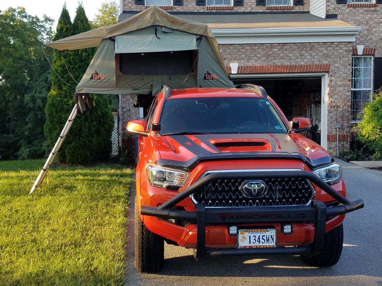

    I had the Armodillo referenced here. I bought it after a minor deer strike without doing a lot of research.
    The problem with the brush guards is that they only have a solid mount on the bottom, and a weaker mount on the top. That top mount will collapse with anything much more than you rolling into someone while trying to park at the mall.
    Before you buy anything, decide how you're going to use your truck and go from there. I use mine to overland and for moderate trails and built accordingly. I also have 45 mile commute through deer county. While this isn't perfect, it will most likely protect the "vital organs" on the truck and should get me home.
    Not trying to sound like a know it all. I've made a few missteps as I've built mine. This can be expensive as this stuff isn't cheap.
    Amorak likes this.

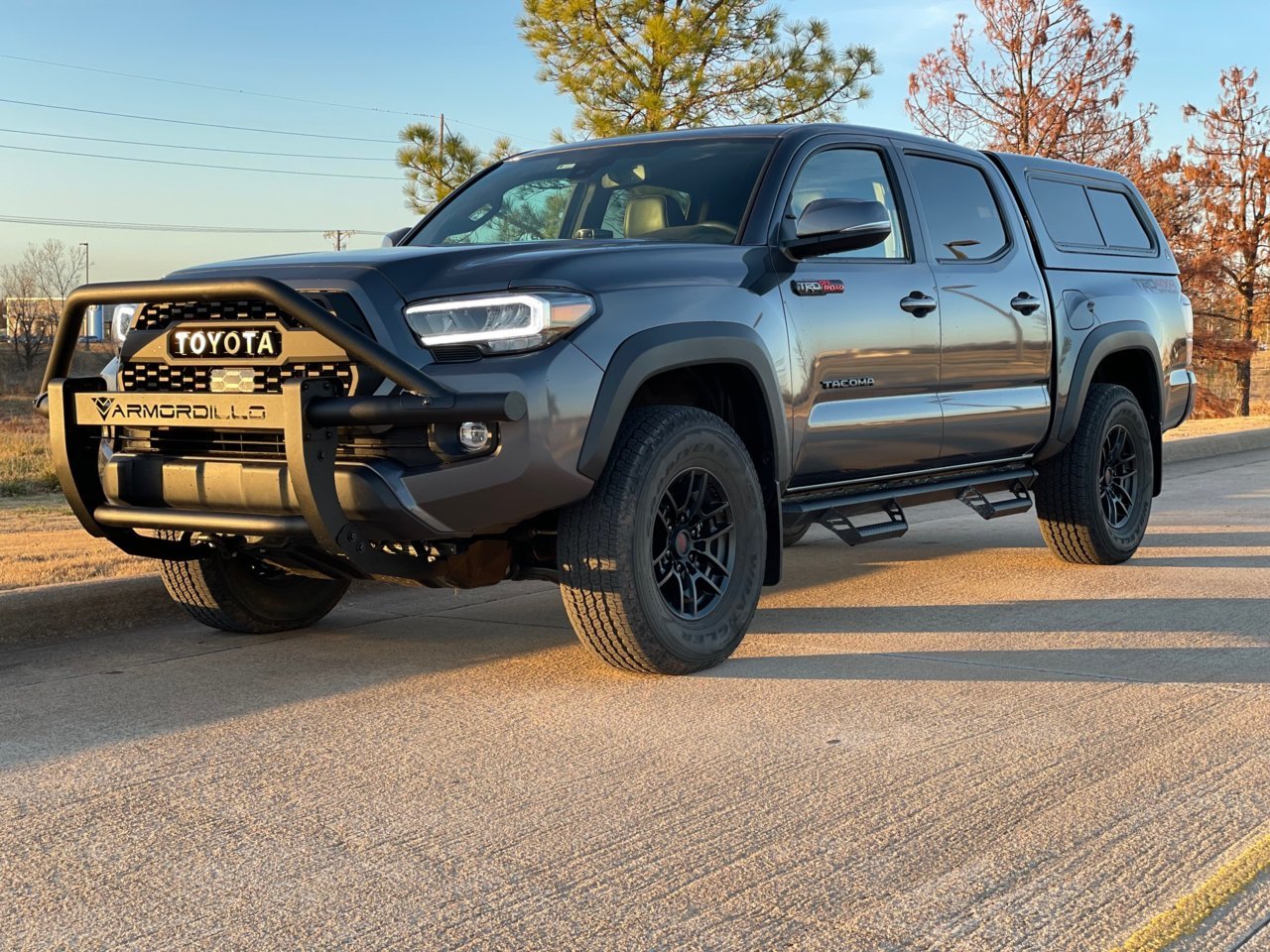

    All good stuff. Your bumper design has a way better chance of making it thru a deer hit.
    Mine is truly functioning as brush guard. Yep a deer hit would have to be mild (time enough to really brake!) for the Armordillo to "perform".

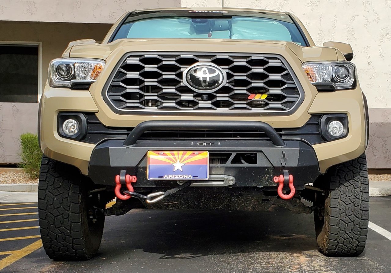

    I just wanted a clean looking winch mount and not a lot of trimming!:cheers:

    Wow! That light is nice. :thumbsup:I may have to do this. I never added the light because I wanted access to the winch clutch. Also, I don't look forward to running/wiring a switch in my dash. At least this still allows winch access. Thanks!
    BTW AwesomeLaw68, it's a significant job to install. Not hard, but a fair amount of work. :cheers:
