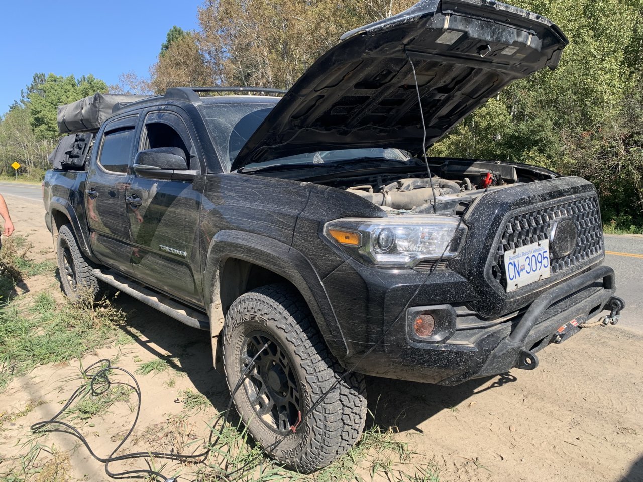

    Really don’t understand these “bull bars”. They provide absolutely zero protection and reduce your approach angle by a lot. Tacoma’s already have shitty approach angle.
    Front stump bumper looks kind of similar but actually provides protection and recovery points, 3-4 times the price though.

    How did you find a black one to match your truck...custom paint? :spending:
    No...wait a minute...is that Plasti Dip? :rofl::rofl::rofl::rofl::rofl::rofl::rofl::rofl:

    I actually splurged that time and had it powder coated in black.:D

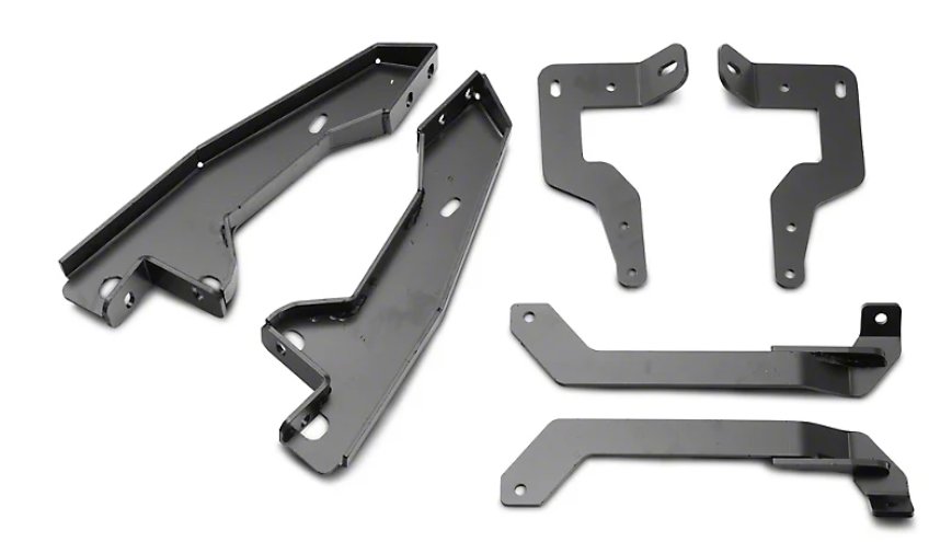

    https://westinpublicsafety.com/front-end-protection is the line up. They don't have one specific to the taco, but the winch tray is the same as the base of my brush guard

    I'd be leery of that set up for one reason, it doesn't show any upper support for the for the bumper or winch in the picture or the parts pictured. And there is only one bolt hole at the bottom where the brush guard attaches to the piece that attaches to the frame. If the upper support is there and not shown, the only place it can go is through the lower grill to the lower radiator mounts. That's the same set up the the Armadillo had and why it's no longer on my truck. I'd also be careful of winch capacity without support and one bolt holding that to your truck, especially if that is bolted to your radiator mounts.

    There is an upper support. You have to cut two slits through the center bumper molding (hidden by the winch tray in your picture). The two brackets in the lower left of this picture pass through them and bolt to the two "?" shaped brackets. Those brackets fish plate your frame so you have something stronger than the aluminum crumple zone to bolt to. I've tried to get a good picture of mine to no success.

    How thick are those plates?

    At least 1/4" but the powder coat is pretty good so I'd say probably 3/16" of it is steel. I used a 3/8" drill bit to cut the ends of the slits.
