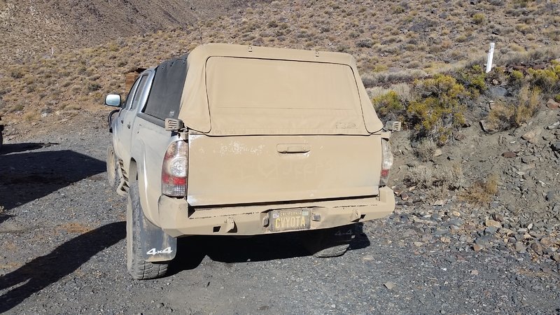

    Can't wait to see it, Nick
    Here is my old BF bumper, still going strong

    Looks great, Nick, I wish I had gotten the hi-clearence. Have fun cutting, I am looking forward to the write-up.

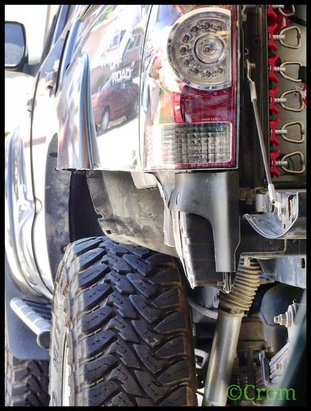

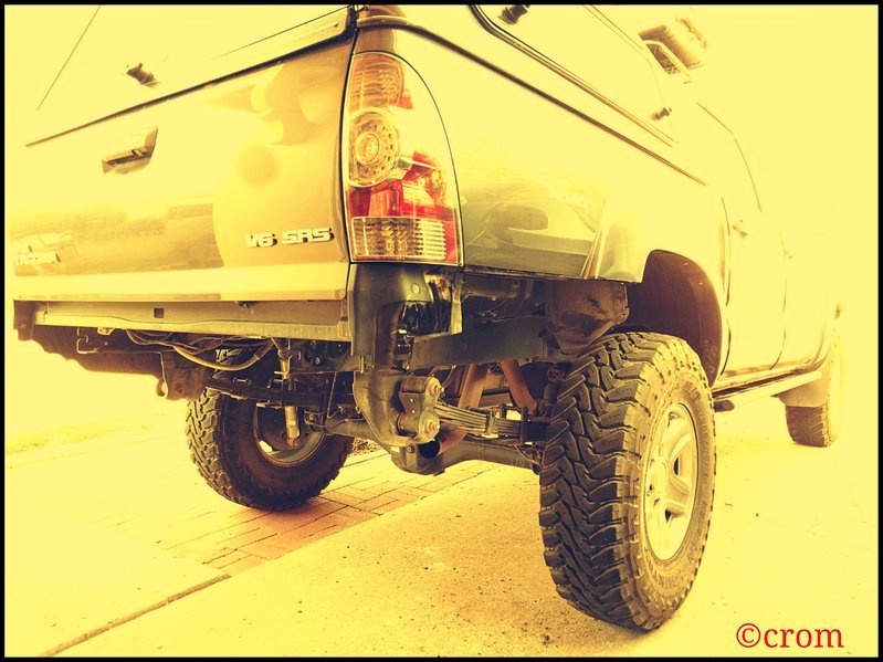

    I cut a few weeks ago. No write up. I mostly followed advice from Leo, @Night Eagle .
    Cut level with taillights. Measure a bunch of times and go to it with angle grinder with fresh cut off wheel. Cut right through the plastic flares right on the truck. Pretty straight forward.
    Cleaned up sheet metal edge with a metal file, then mask off and paint edge.
    I still plan to put some quality 3M door edge stuff on there for a more finished look.
    Here is my six year old painting Rustoleum onto the truck. :)
