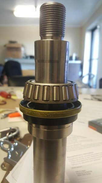

    For those of you who have put their gates on,
    Is this the correct configuration?
    Rubber seal with long part down,
    bearing with taper up,
    then gate
    Then bearing with taper down,
    washer,
    nut,
    cage lid.​
    Does that sound right?
    How tight do you torque the spindle nut? I had to go get a socket it's 1-7/16".
    I received no instructions, so any help is appreciated.

    the way you described it is how I did it. the bottom bronze/rubber seal should be nearly flush with the bumper. pack the bearings real well with grease prior to install.
    as for torque, billy just mentioned tighten until the swingout wont just fall open, but still moves.
