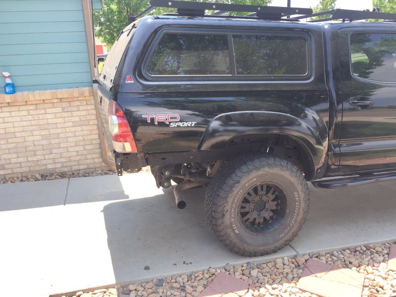

    for those of you with HC rears. what are you using to make your cut? I dont have any nice saws and am hoping lowes can rent something out to me
    ChadsPride likes this.

    These work pretty good. Nice clean cut.
    All you need is a angle grinder with a cutoff wheel. Bedside is thin material and cuts super easy.

    Cut off disc works great.

    All set :thumbsup: Bumper should be done powder coating soon. Cut was way easier than I thought it was going to be.

    While that bumper is off, might wanna chop the exhaust to dump over the axle. Easier now than on a trail when it got crushed

    Also keep an eye on your bedsides. I believe toppers on bedsides cut for high clearance bumpers have been stressed before. Looking forward to seeing the bumper on your truck.

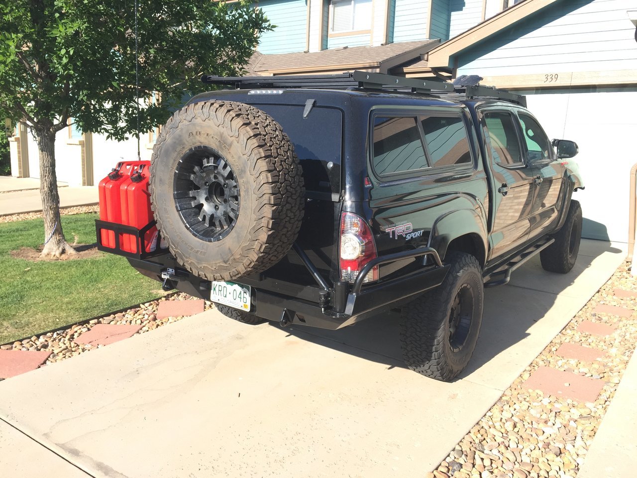

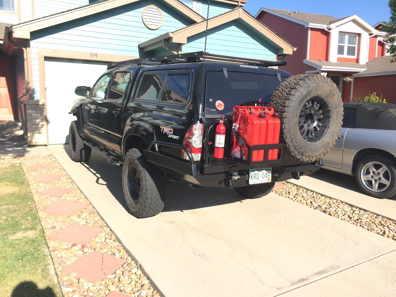

    Brute force armor is the only armor!
    Got my new butt installed today! Amazing product I must say. Build is excellent. So happy with how it turned out... I just need to swap out my crappy AAL for some dakars plus the AAL. Got s good amount of sag going, especially with my rear storage.
