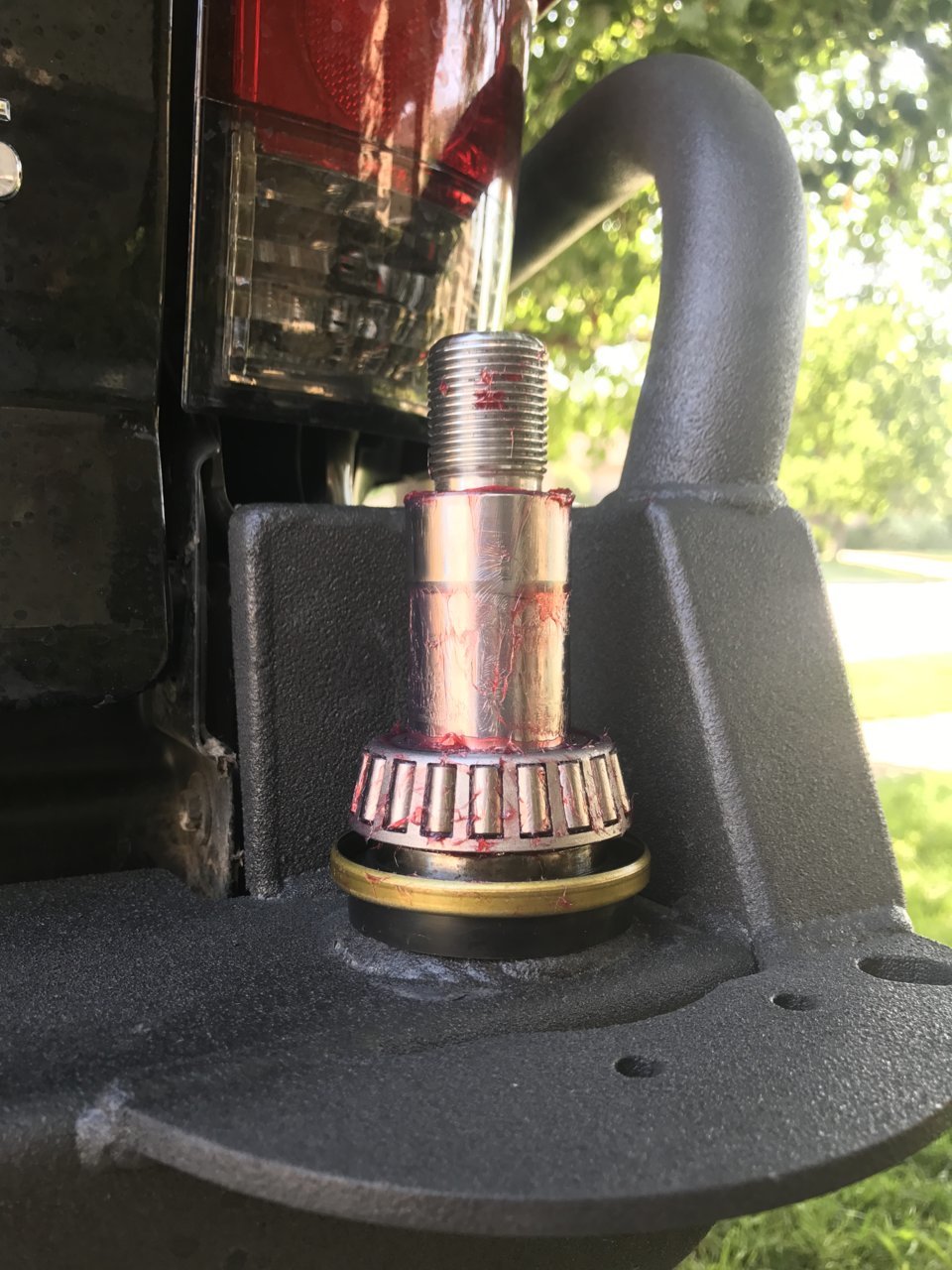

    Try hitting it with a couple shots of PB blaster the night before and trying again, I had the same issue and that helped I then coated the threads with permatex anti-seize and reinstalled it.

    Also an option to try and super cool the only aluminium plug on a hot day and keep the steel warm and perhaps the shrinkage will do the trick.

    Same thing happened to a friend. He had to use an air hammer with chisel tip to break it free. We tried damn near everything.

    The cap being aluminum and the swingout steel it's easy for there to be galling and galvanic corrosion that basically glue it together. I would recommend putting some grease on the threads to help alleviate that before you put it together.

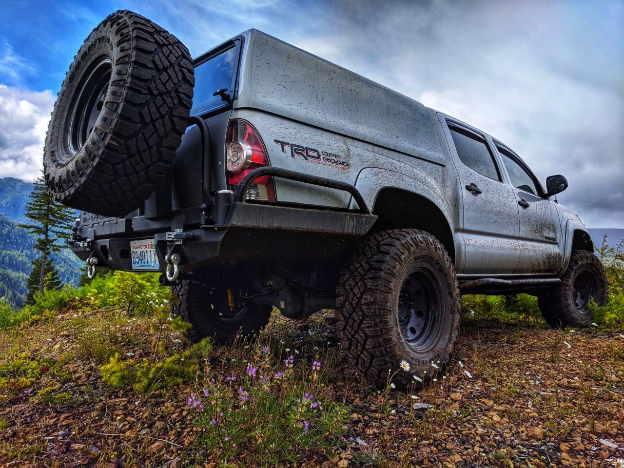

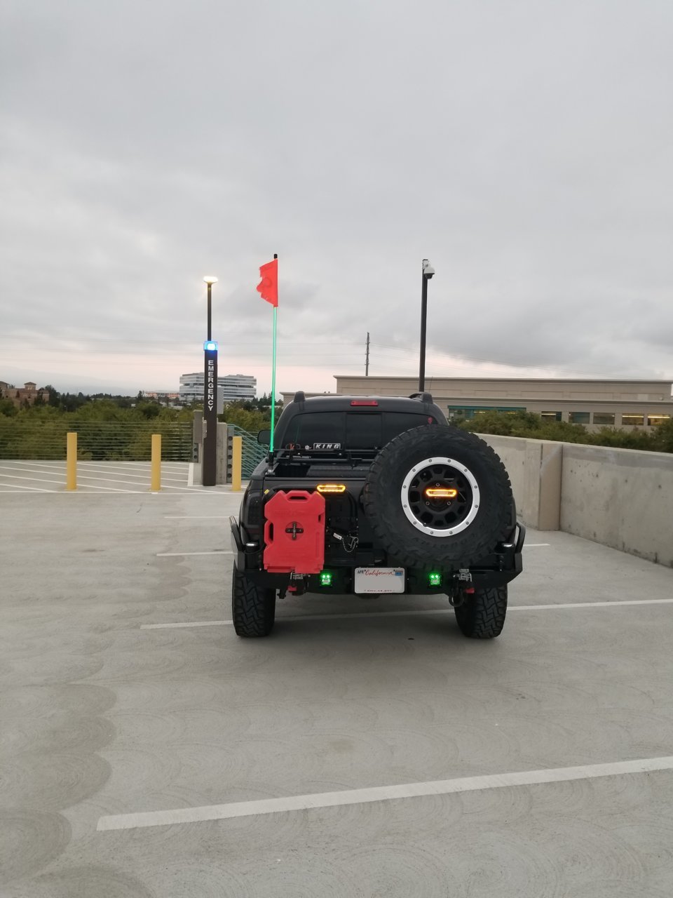

    Looks good. What lights are those on the spare tire?

    Those are Rigid Chase lights

    You should have @ERMB do portrait of that 1st picture!

    I like them, nice choice.

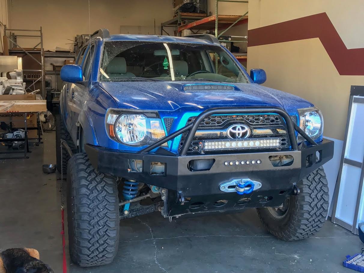

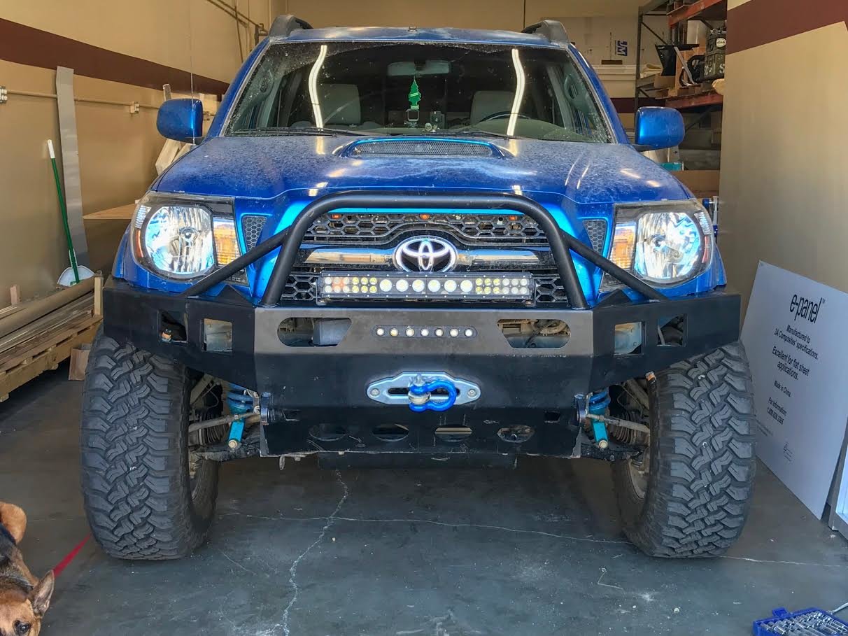

    So you have a Smitybilt 12K winch in there?
    Did you have to do any modifications to the bumper or truck to get it to fit?

    A 9.5k and 10k winch are roughly identical in my experience, some manufacturers just use one weight or the other for whatever reason. A 10k should fit just fine in Billy's bumpers
