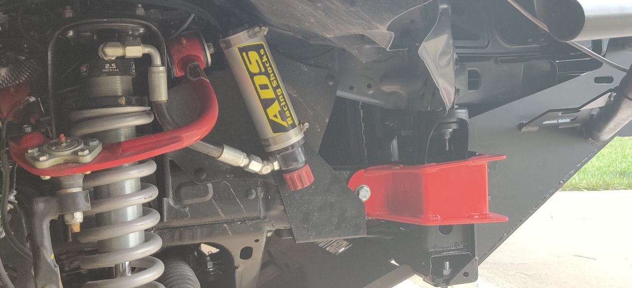

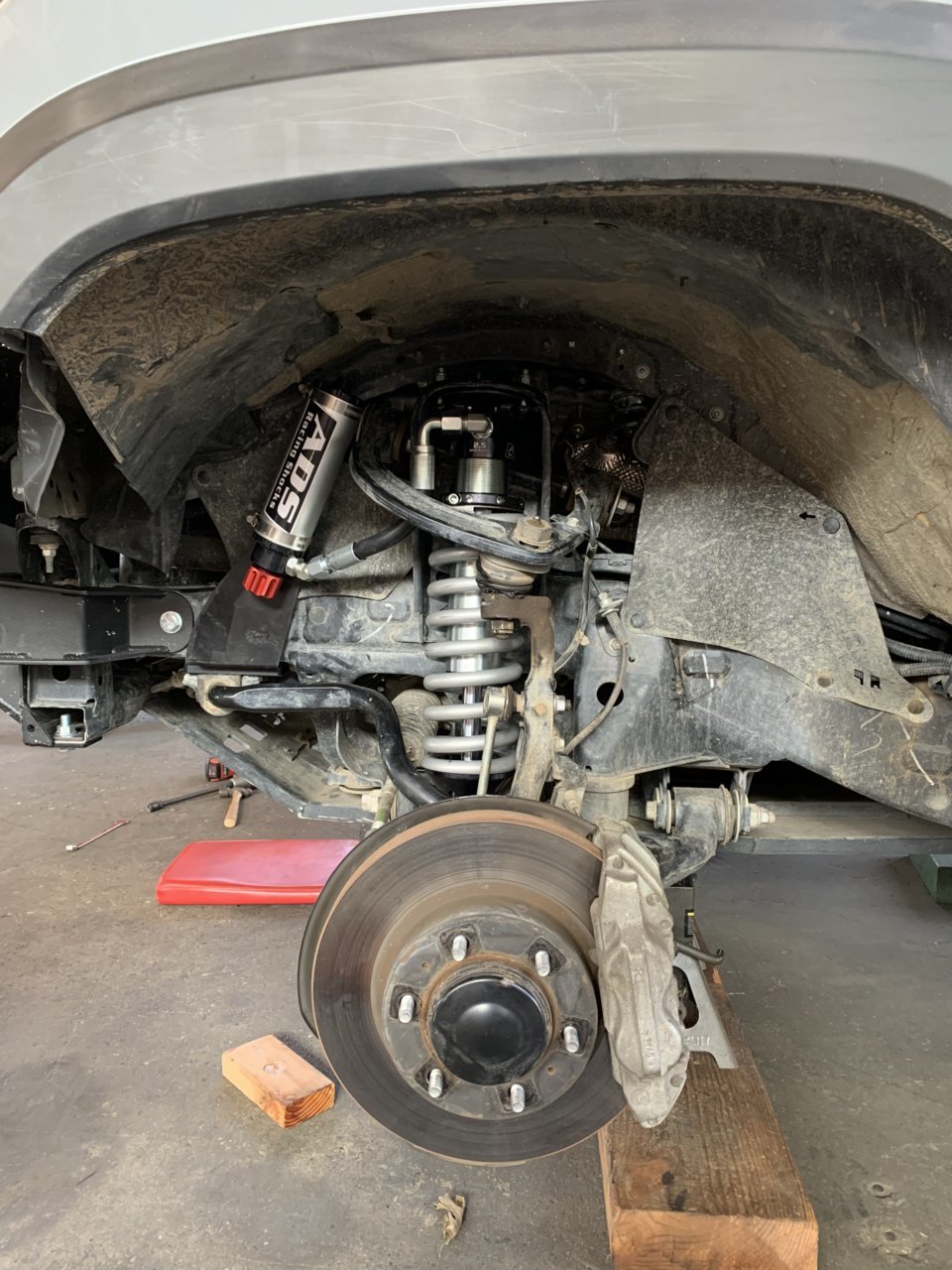

    I radiused off the corner of my ADS mount, but I think it would have actually fit without any modification. Hard to tell from the picture, but it mounts about a 1/4" off of the frame, so it may have cleared the bumper bracket.

    @ChadsPride I think the best route is to get the BAMF brackets as @Longboard1110 did. There is a sale right now. They are stronger anyways. @Anderson can tell you why. i cut my shit up for install and soon i will buy the BAMF and new resi mounts. It would be cheaper to do it from the get.

    Looks solid but good info. I'll see about those tonight. Still have a few weeks while my shocks are being built but I'd like to be ready when they arrive.

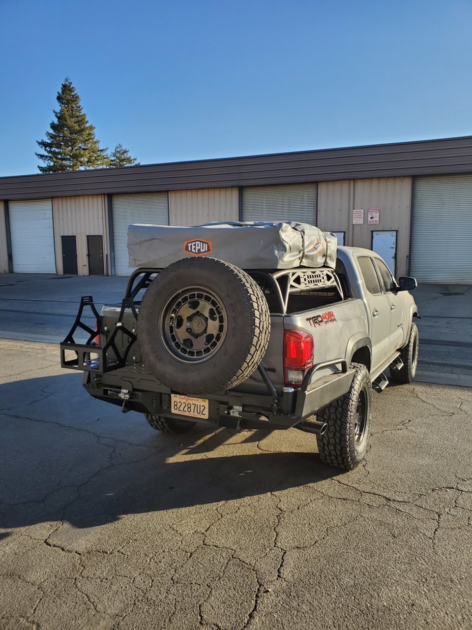

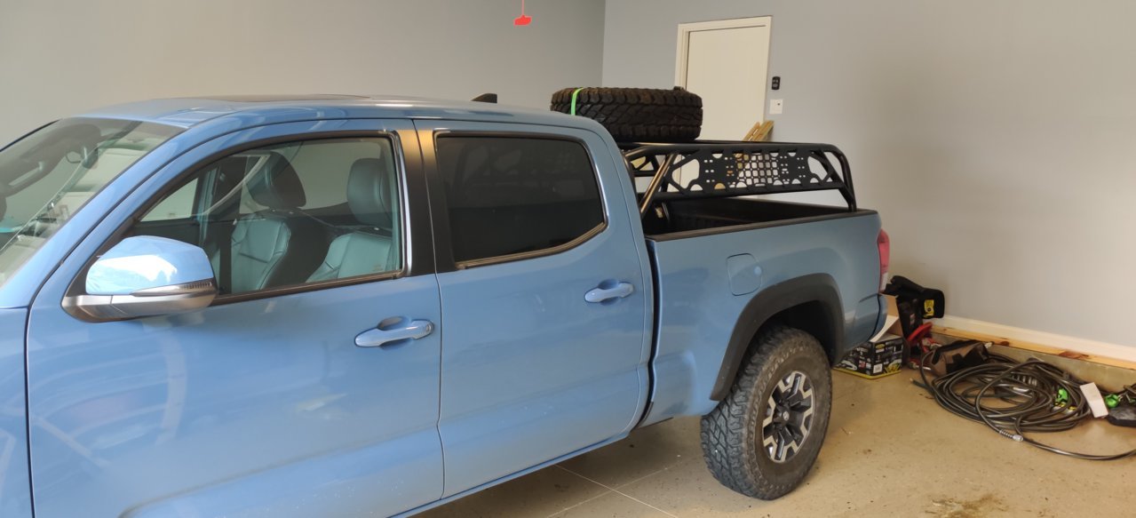

    Took a trip to Clovis today to have Billy and Will install my bumpers.

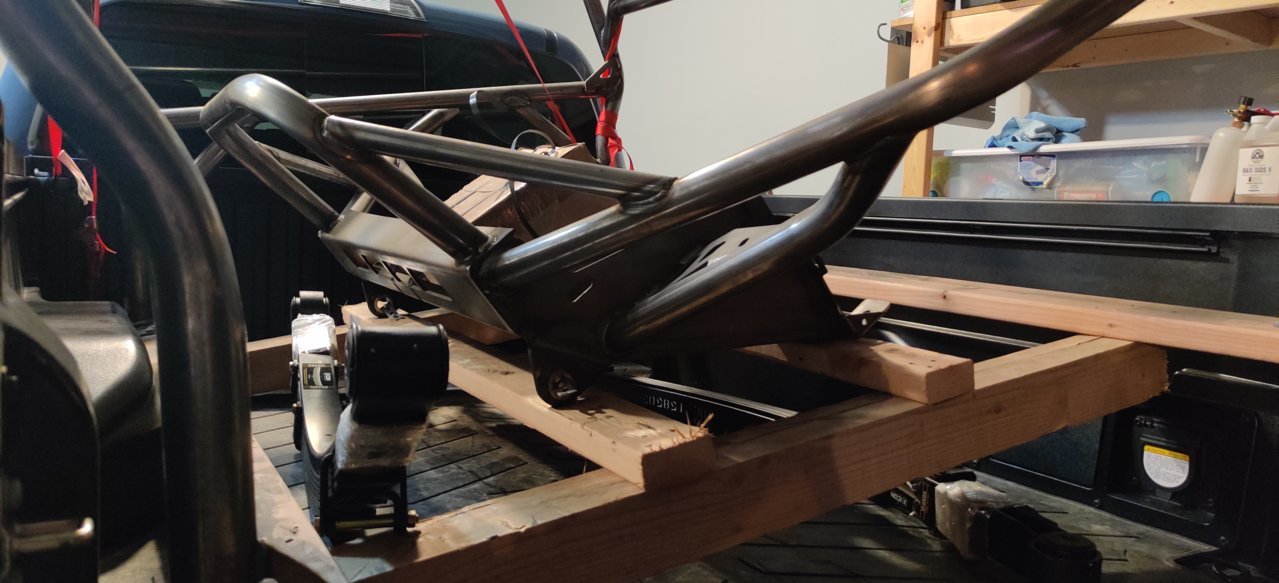

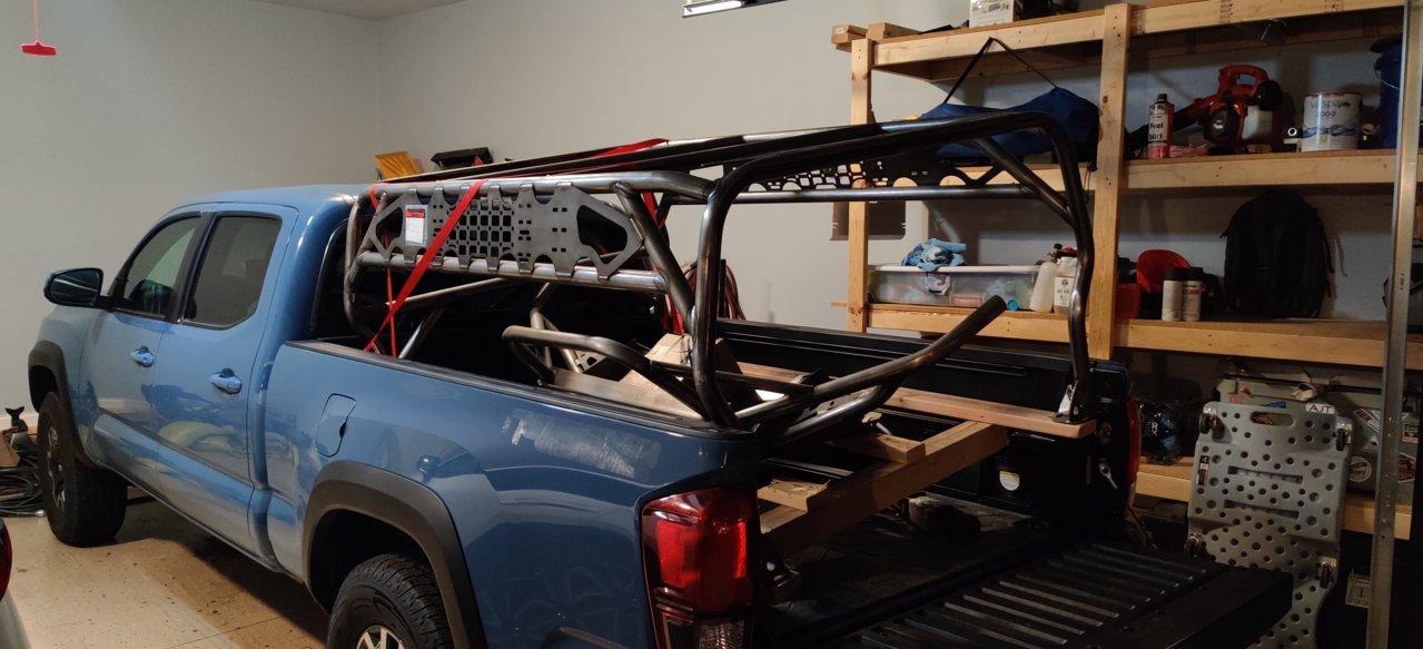

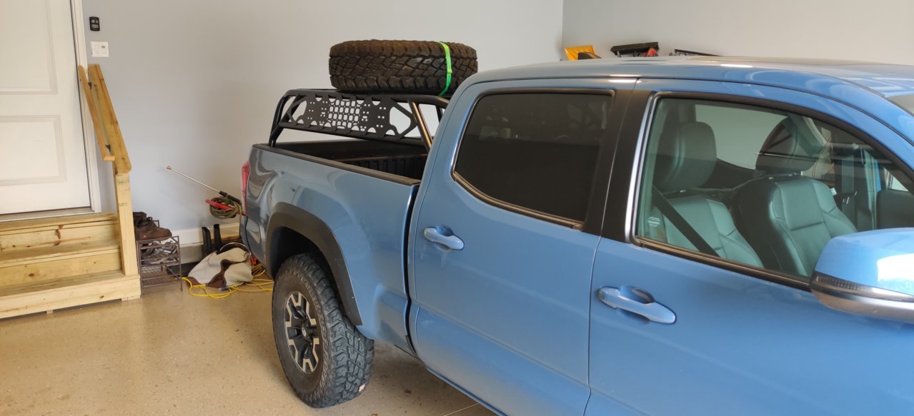

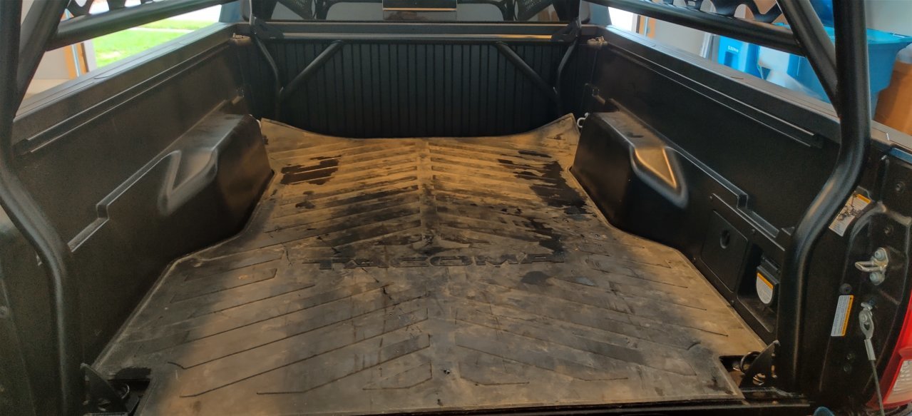

    Bed cage in, super simple to install. Spare tire on the rack and I have pieces to fab mounts for recovery boards
    Front bumper some time next week. Are there any tips/guidelines for front bumper installation? I have the hybrid and was going to loosely follow the C4 Fab video unless Billy has something similar.

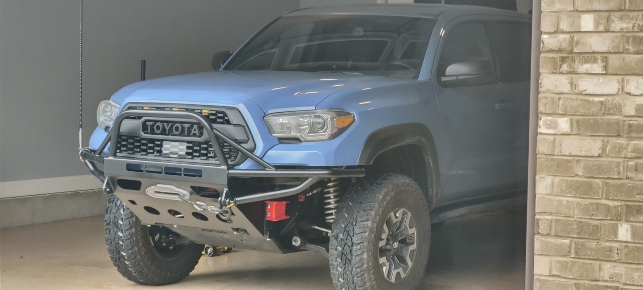

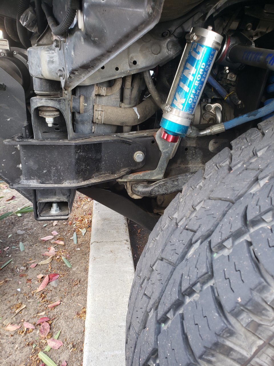

    I other news, I finally grew a pair and drilled holes in my frame to finish the installation of the bumper. I've been running without the frame bracket for a few weeks.
    For those curious, I did not need to modify my ADS resi mounts. Perhaps important to note, I am using the sway bar relocation brackets, even though I don't run the sway. This might provide the clearance necessary to fit everything.

    Looks awesome
