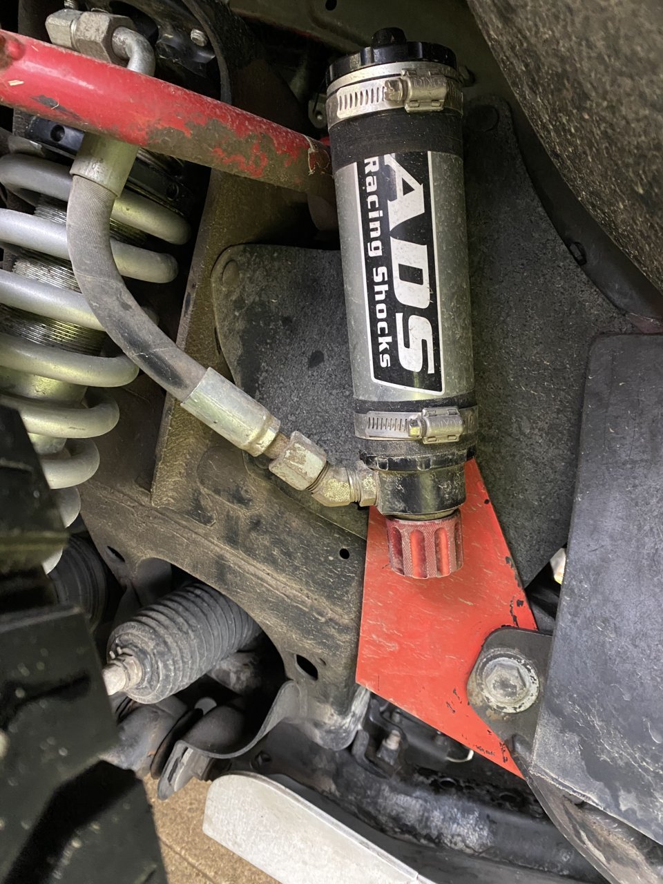

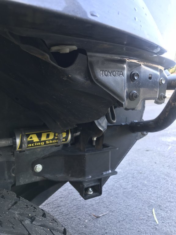

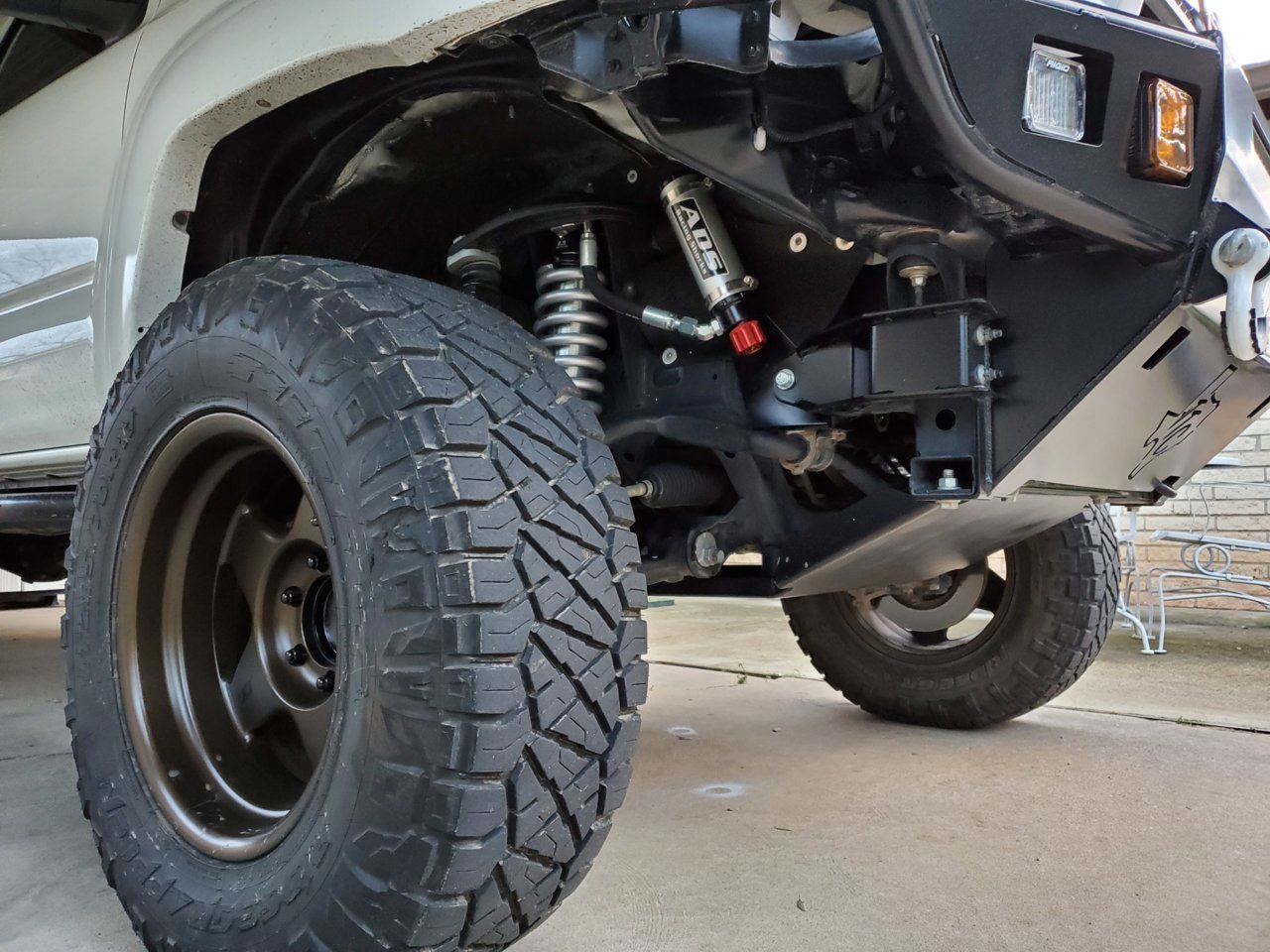

    Dang, I've started really wanting a brute force bumper, but looks like I'd need to change up my resi mounts. My ADS's came with the horizonal mounts so I'm sure that'd interfere with where the bumper mounts... hmmm.

    I was able to sandwich my mount between the frame and the brute force reinforcement plate. my mounts were from @M C M but i imagine yours are similar if theyre horizontal.

    Yeah I think they changed the mounts for the clicker versions. You can also always run the BAMF brackets which clear everything.

    I removed the large bolt for the bumper and sandwiches the mounts in between the bumper and frame, drilled a hole through the mount and re installed the bolt for the bumper. ADS with the vertical mount

    Nice! Thanks for the replies guys. Looks like I'll be able to pull it off with limited work then.
