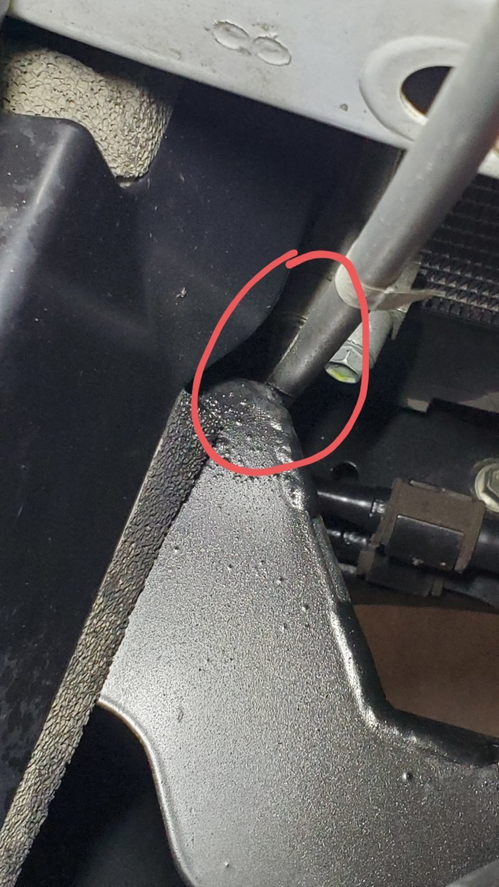

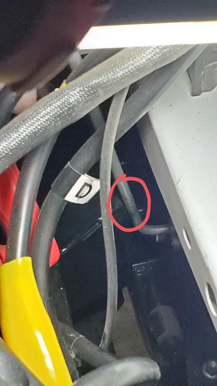

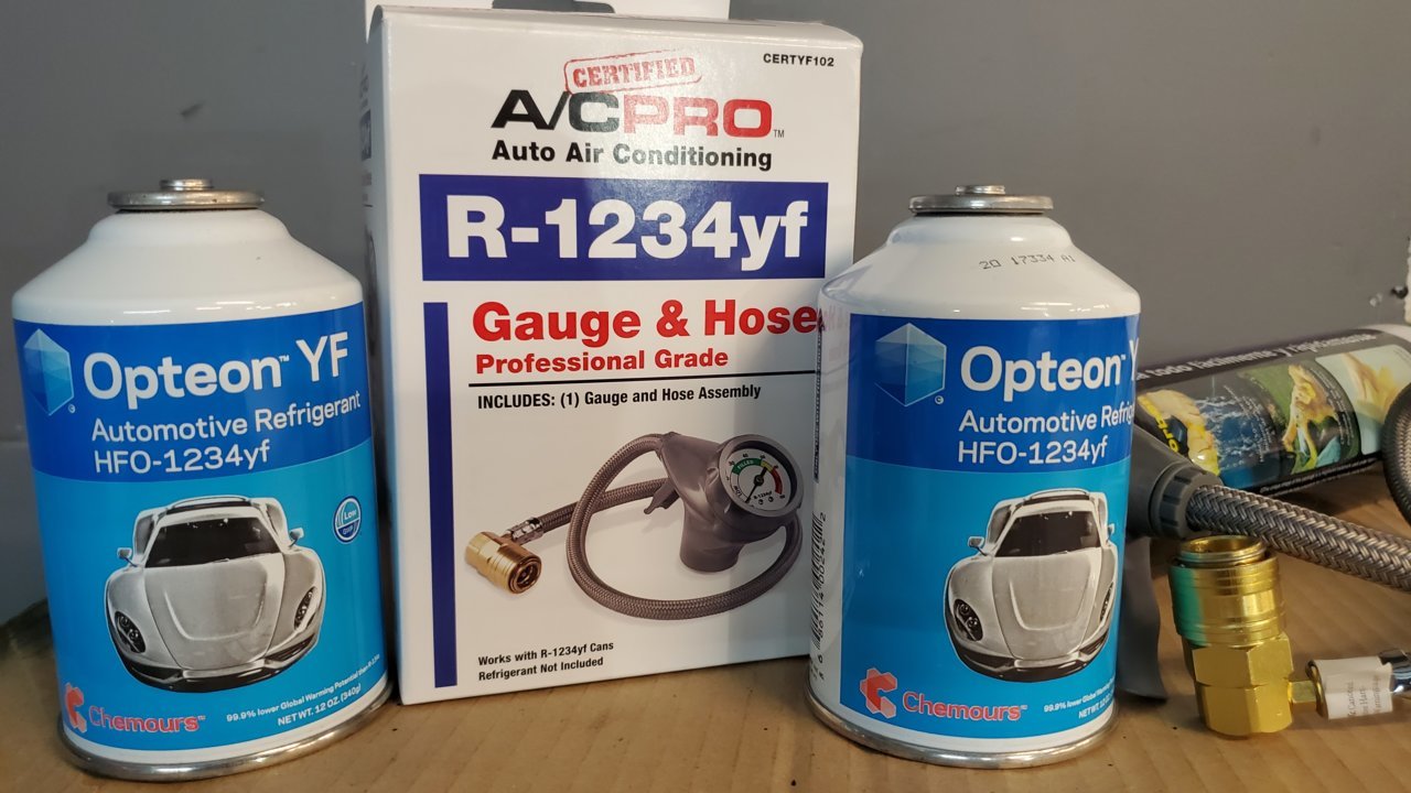

  20. Jul 11, 2020 at 11:19 PM
    #840
    k_j_souv
    k_j_souv Well-Known Member
    Dec 22, 2016
    #205514
    263
    NorCal
    3G OR DCSB, Dual Case, 42s
    After having the Brute force Fab front bumper on my 3rd gen for just over 14 months now, I ran into a problem today. The bumper was rubbing against the AC line causing a leak. I'm not sure if it's my fault or not but I just wanted to share and bring it to attention so it doesn't happen to you. It does look like the bumper was installed correctly. What I ended up doing after the repair was bend the AC line for more clearance. Fortunately for me, my brother can weld aluminum. Btw, the Tacoma uses the R-1234yf $$$
