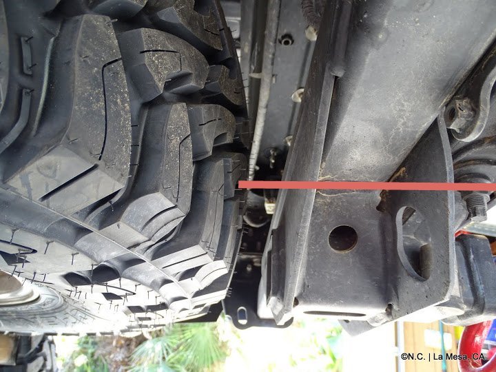

    Thanks a lot! I'll have to get my eyes under my truck to compare.
    The only photo I have at the moment is this one, which was before taking the 1" space between the tire and factory hitch.

    Sure.
    For now, yes, spare needs to stay there.. It's 84 lbs. and want to keep COG down low.
    The HC bumper would give protection to the sides where none exists, and the factory hitch can get out of my way.
    All the times I've dragged the rear end on trails, it's always been the section below the red line.

    As an aside, I want to better study the cross member holding the spare tire elevator and see if any space can be gained by cutting it out and having one fabbed up in it's place. Maybe gain an inch, at the same time, I'd probably have frame plates welded in I think, just because.
