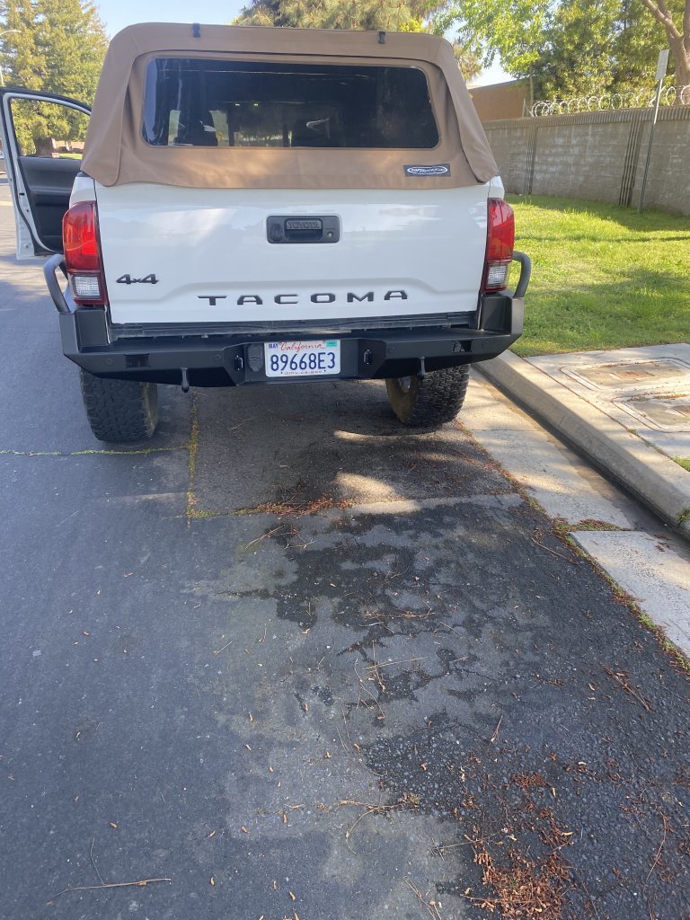

    I finally got my bumper installed by billy last friday.

    That looks really good! Congrats!

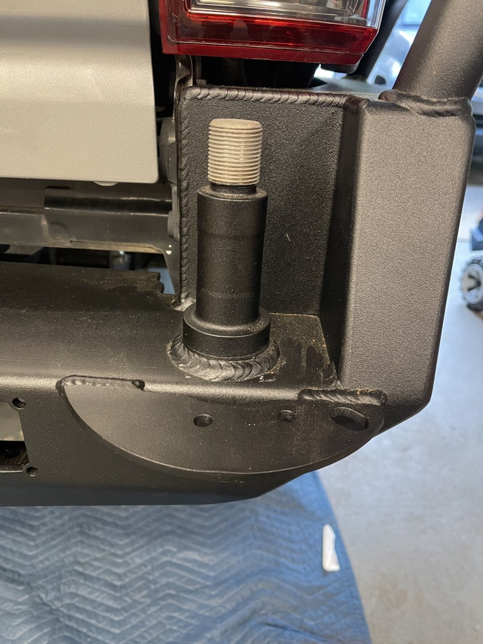

    For those of y’all with swing outs. Did my powder coater go to high? I can’t freely slide the bearing on. If so any tips to get the powder coat offB51AC681-CB31-4B7E-916E-7C807350A48C.jpg

    Yes! Even if you could get the bearing on it would eat up the seal.
    Such a bummer for you, sorry man.
    The back side is going to be a real bitch to clean up. Maybe get with your powder guy and see what they recommend for removing. It should be smooth as a baby’s bottom. Good luck.

    Dang it, thanks man
    edit: I called the powder coater, he said to use “airplane stripper from lowes” paint stripper. Gotta take the bumper off

    I'd try some long strips of sandpaper wrapping around the spindle before I'd go the paint stripper route. You can start around 500 grit and go down if it's not working. Afterwards go up to get the desired finish needed.

    So just to be clear. I leave the bottom pc and strip above here 290F7C6B-3A27-48AA-BDD2-6A554F2A8758.jpg

    I thought about doing that. I could leave the bumper on if I sand it. But I don’t want to scratch up the metal by accident

    Yes there. Put some painters tape wherever you think your going to rub. It’s way over built so as long as it’s clean where the seal goes and the berings drop in your golden. Don’t over think it. It’s not like it’s really doing anything like a wheel bearing. You might want to pick up a tap to clean the threaded holes if there is PC in them. I would be more worried about trying to work in a bolt and snapping it then that spindle.

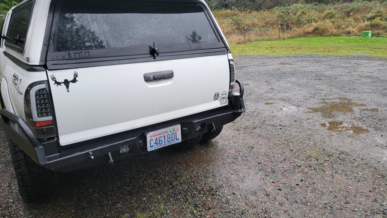

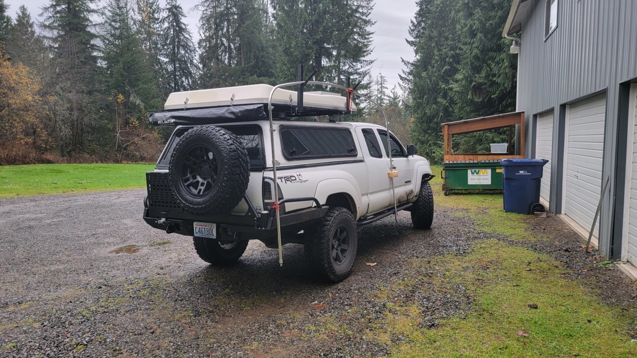

    My buddy just quit working for him. Supposedly he withheld $ from his paycheck and the welding conditions werent that great.
    I still think Billy's bumpers are some of the best deals out there, and dont hesitate recommending them to friends who ask me. Ive had my bumper for a solid 5+ years and Ive had no issues with anything. (sorry for the pics. No service at work)

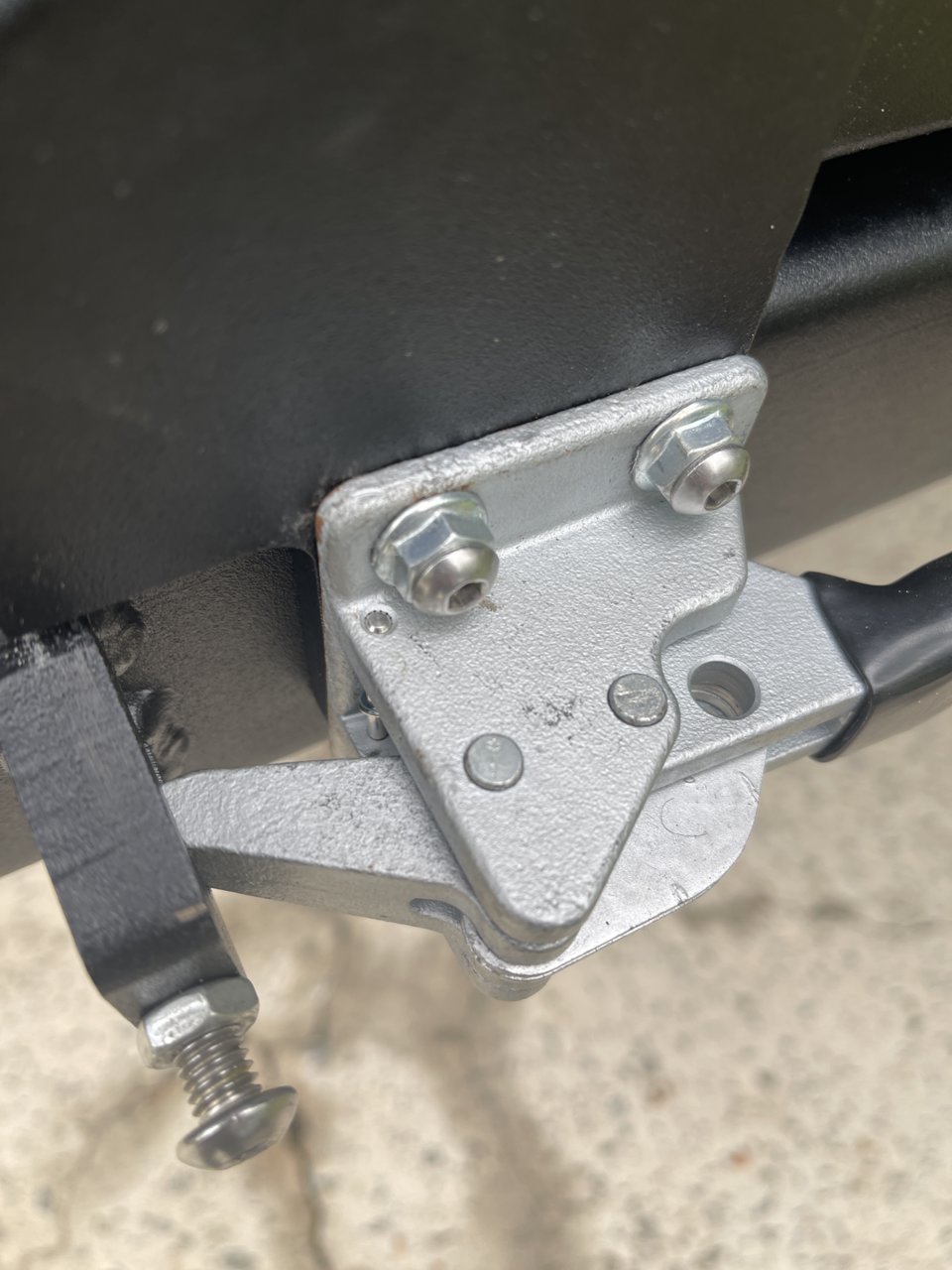

    I can’t for the life of me figure out how this latch bolts on and latches. Every combo hits and won’t latch. It’s like it has to me completely flush? What’s the trickA327FC90-7A11-4662-BC76-9835BD0DEB0D.jpg
