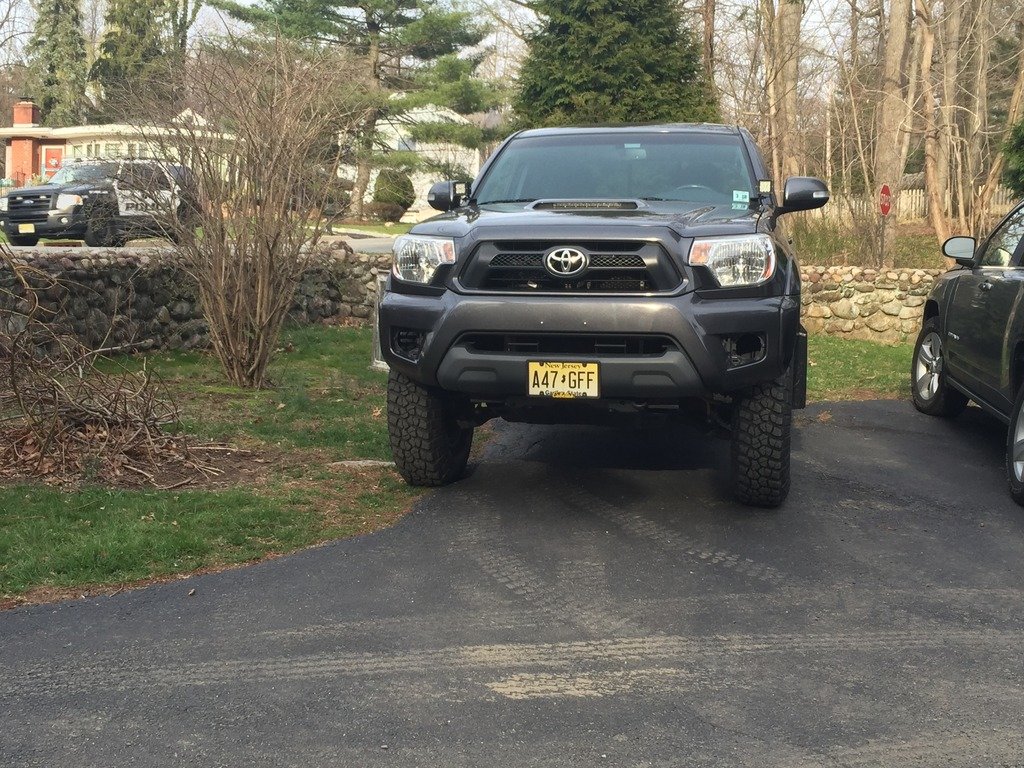

    Anyway. Before:
    CB4CCC95-0960-4867-BB79-4716DD8EC619_zps_64b7d37f669b24bfadb96c6b6bd65663b0334e76.jpg
    A3E5C35C-3567-4AD7-A147-FF6109B09F91_zps_9448c36dfe6ffa0f6cf896cd672ba72109d055e6.jpg

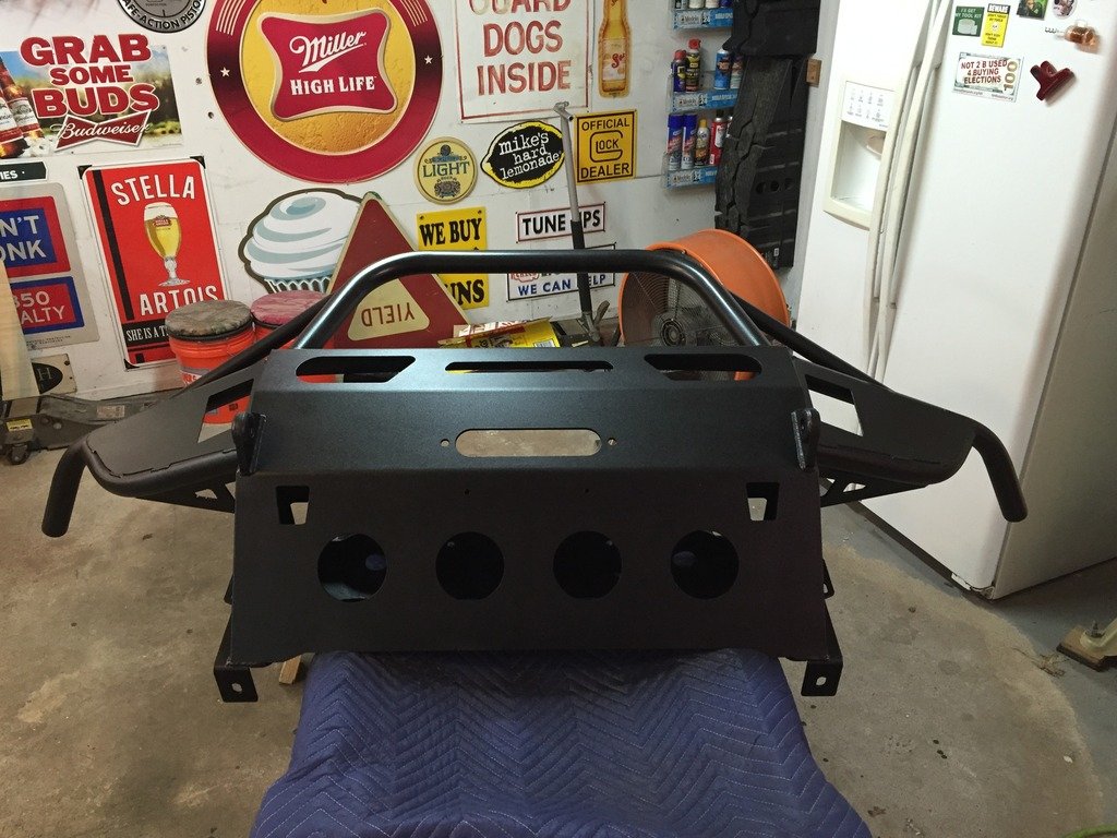

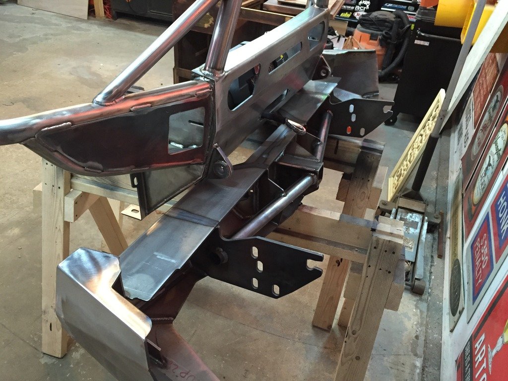

    Bumpers fresh off the pallet:
    4B60631E-33C3-4A39-A61A-4C73A33A19F5_zps_15801131785d908bab57c50282a7822ea6469706.jpg

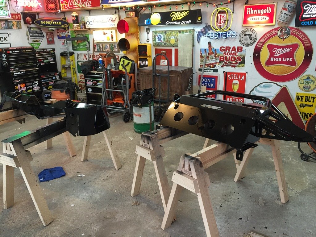

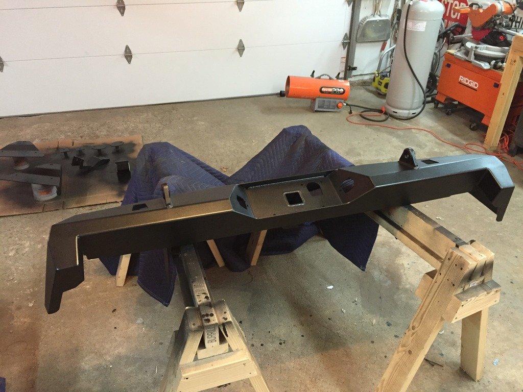

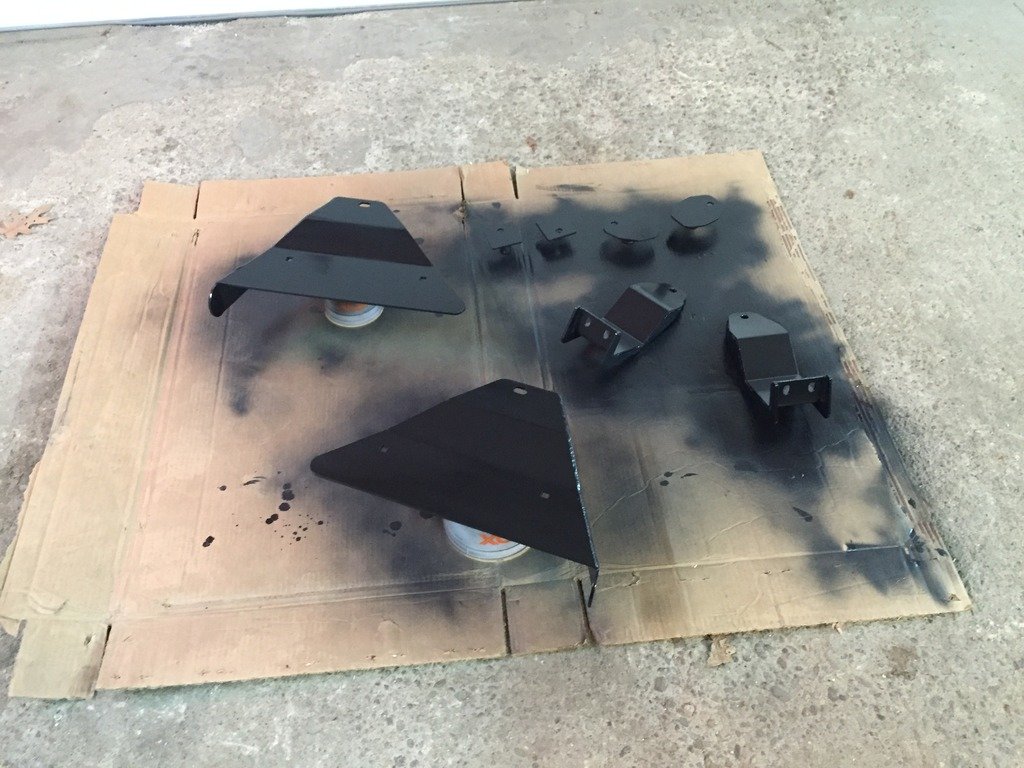

    POR-15
    11AC5032-A44F-4E46-9950-8B27EA7FF85D_zps_3ad4f8255e7d0029bec78debf0488be956a2200c.jpg
    Bed liner top coat:
    8808ADD5-FC89-4961-BEAC-0DA8B11273A7_zps_327c43aae34bff2771437b92e7423211ccce6aa8.jpg
    78483B4F-C0A5-484A-8F29-EFA585446ED5_zps_9d6faebd8d9bac8b4c6a09312c04f0663a808498.jpg

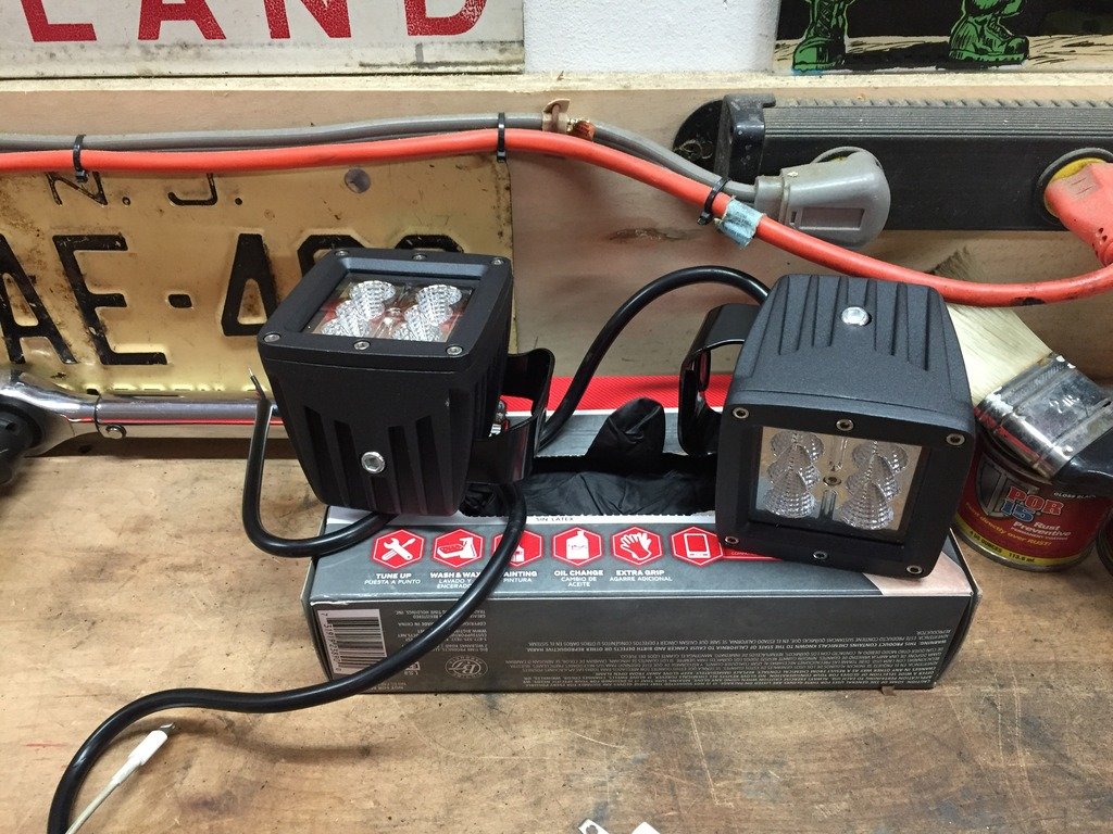

    Another set of pods from @Raxman80 for the front bumper. My third set. I love these things. I'm going to run these off of the factory fog light switch
    C90B0924-8581-410B-877E-CEDA9313F27B_zps_eb2f5019dbfed61a6c9f15b568396baab2ece5c1.jpg

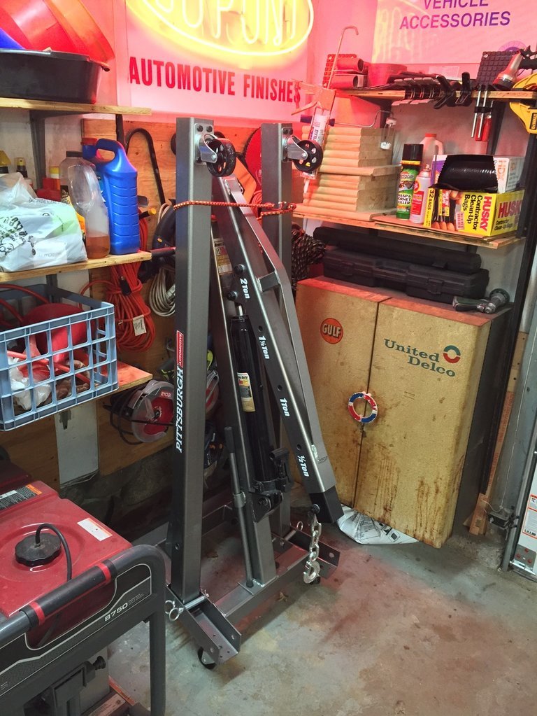

    Tomorrow I'll install the bumpers and get some after pics. I had a Harbor Freight Super Coupon so I picked up an engine hoist the other day. The front bumper is going to be right around 200 lbs with the winch installed...
    I knew this would come in handy:
    52561F1E-54AC-4844-A93B-763103C82DB9_zps_bfbcd6d123c200d60dc62e5e89efea6403b3037d.jpg

    Did you top coat the POR15?

    I did. As I'm sure you already know, it's not UV resistant. Due to the fact that I can never get a smooth finish with POR-15, I used rattle can bed liner as a top coat. It hides the imperfections and is still easy to touch up.

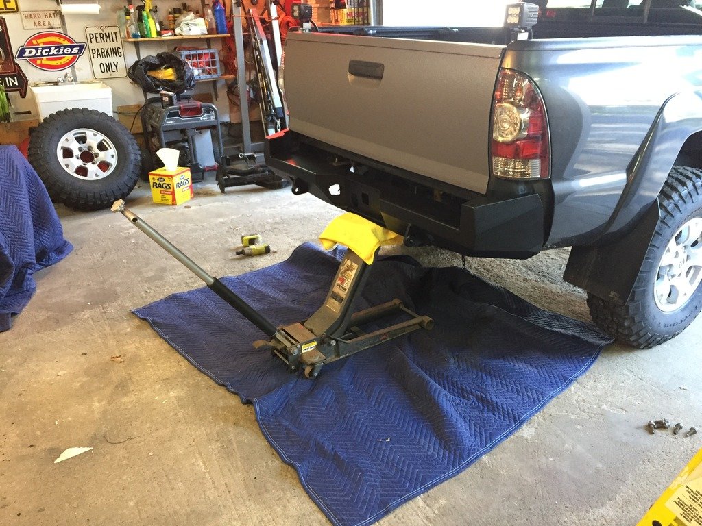

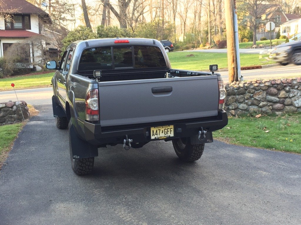

    The rear bumper was simple. Jack it into place and bolt it on:
    96CF177A-7E24-4425-87EF-523D291A505E_zps_54b7296406a2ea02a9cfc64575f48c36a8157675.jpg

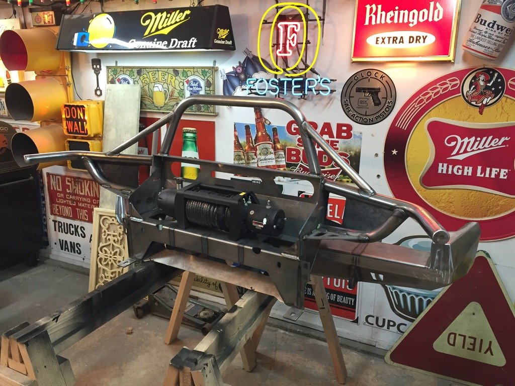

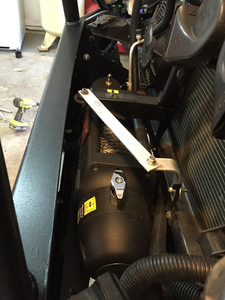

    I pre-installed everything on the front bumper prior to installing it. Space is limited after the fact. Obviously, the winch has to go in first:
    0573C44B-B36B-4F9A-8A33-EFDA71A3A3E2_zps_15b4538ff7d3d88f996c5f6aad18444ba7bb804f.jpg

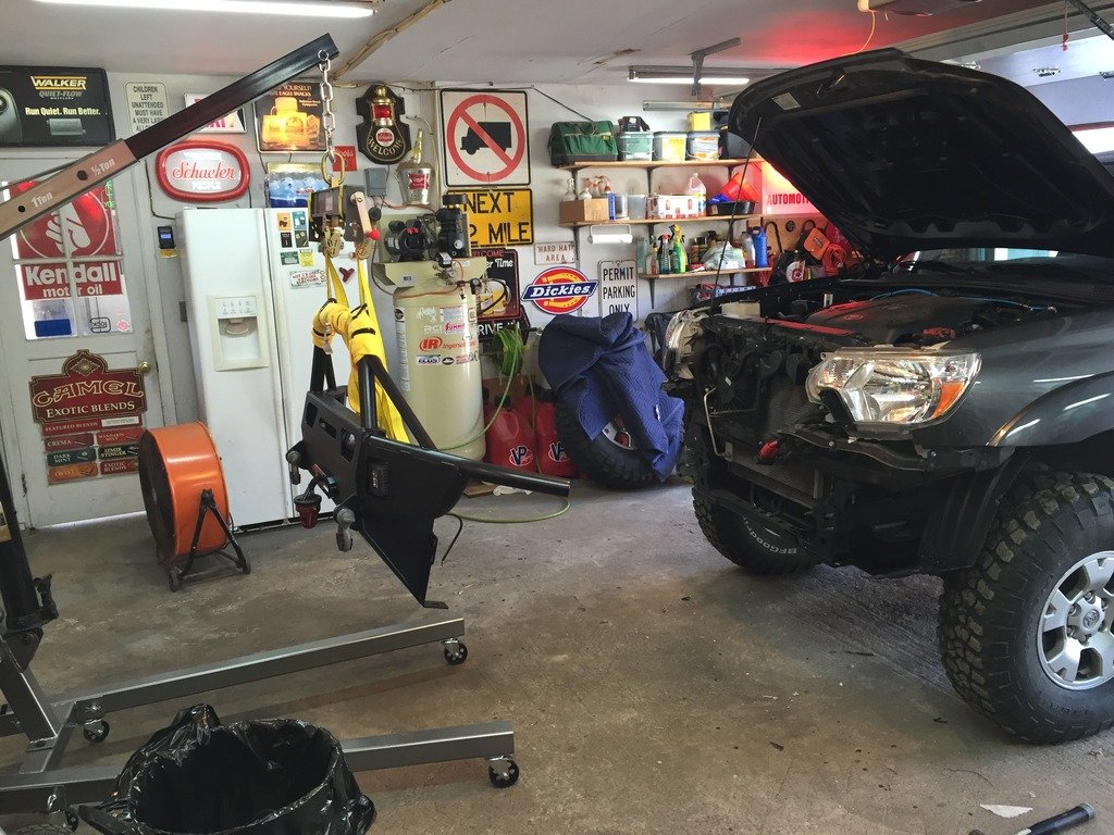

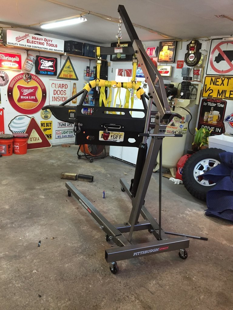

    I'm glad I got the hoist. I don't know how I would've installed this bumper without it. Not alone anyway:
    B251D406-B378-412E-88A8-2FC32B524626_zps_d2b693efb5155fac04a0abefa5c5c1fd1fab95b1.jpg

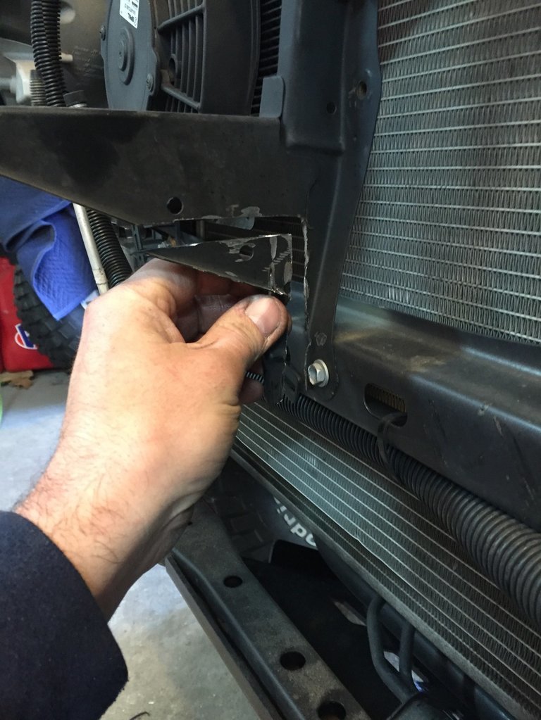

    My winch was just a little too big. I had to trim this support bracket a little:
    F490BC0A-ACAA-4A29-90E0-94894D592C55_zps_accc9acf45200c25ca496a5eba9894f5c6c73e4e.jpg

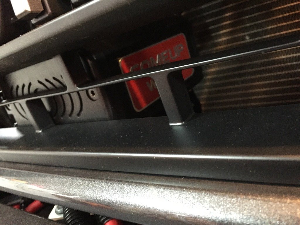

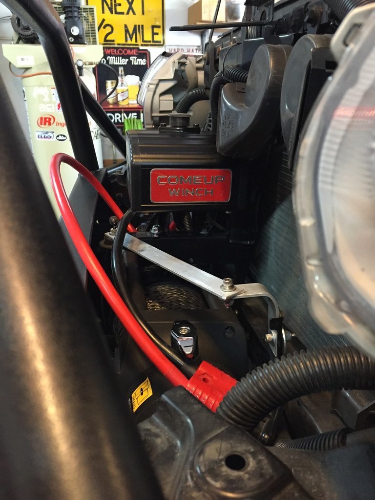

    Once I got the winch to fit, I had to figure out where I as going to put the controller. The ComeUp controller is pretty big. It's meant to mount on top of the winch itself. There was no room for that, or any room inside the bumper.
    I figured I'd use the existing center bracket to mount the controller on. The one that I trimmed above. The problem was that you have to remove the center support that bolts to this bracket to install the plate bumper. That leaves the bracket unsupported and wobbly.
    I had some aluminum flat stock laying around that I used to reinforce it.
    1063A6F2-13FE-409F-B1C9-8F2F0DB18F6C_zps_fa198eb7b158e72a80133ce3c965dd7c4911d678.jpg
    Controller mounted:
    8B1BB7A8-0070-441E-8B7F-308E42E47E0B_zps_eaf285083cfa677d02fb1060f6b2ecd7444f4212.jpg
    It JUST fits:
    2A5C506F-823A-4895-BD44-EB845839DB90_zps_b17d5356d1c7568dc9fa51f18f3a77ff50a78585.jpg

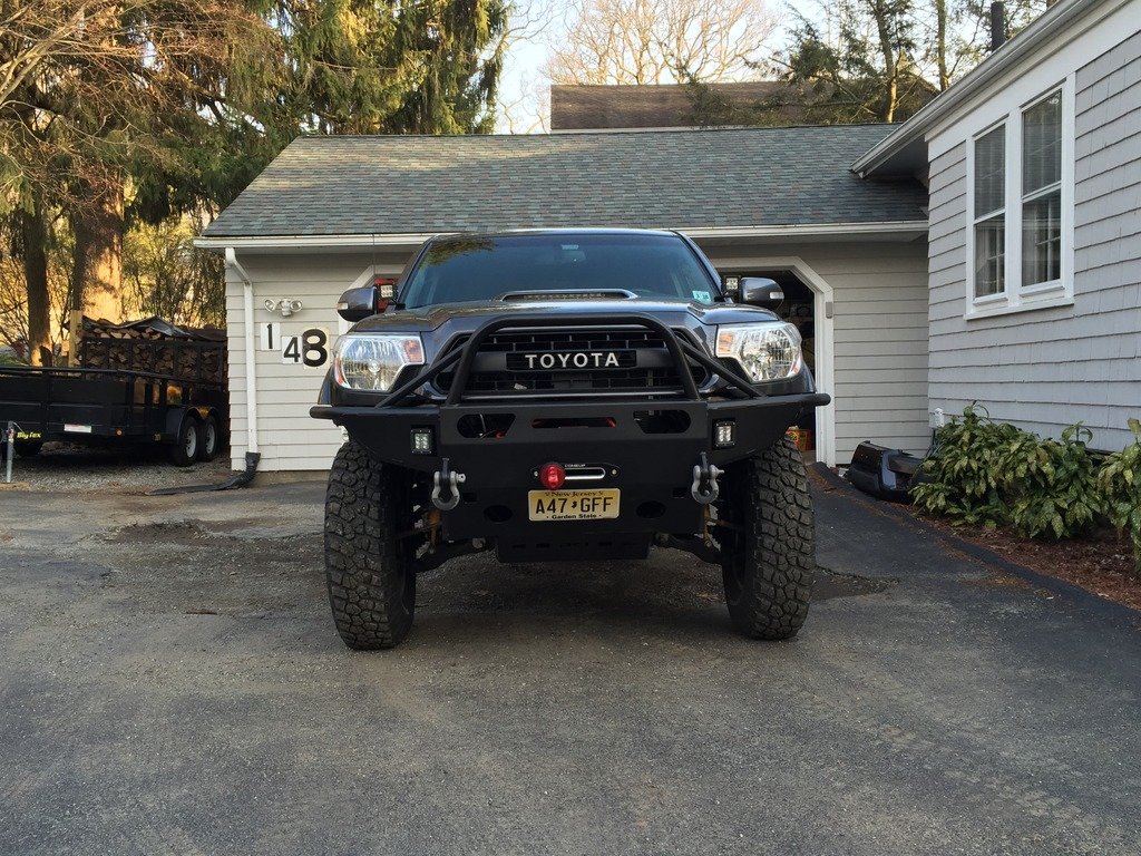

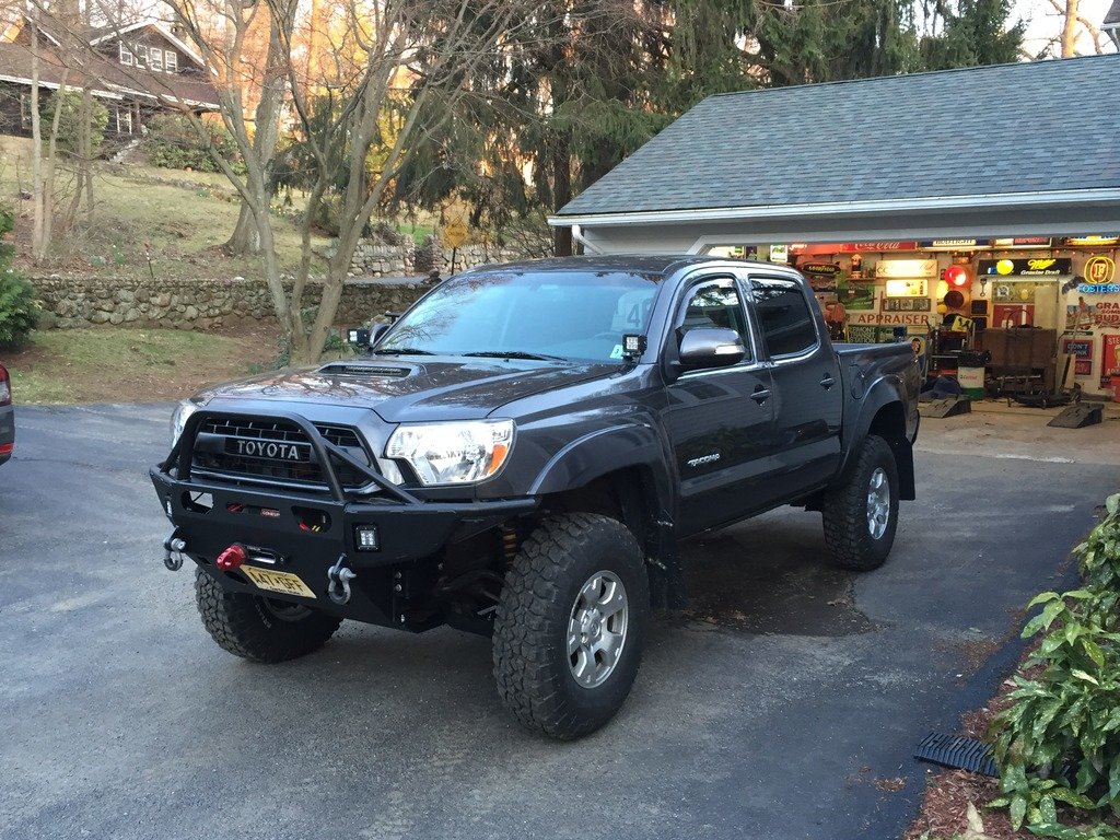

    Finished. I also threw on a Pro grill.
    62199DA4-6665-48C2-AC78-BEEE1C714333_zps_4b6629b2ebd8baafac47fd739e89d423f24c1806.jpg
    06BD5167-639F-4770-A9E9-5B8BAD096141_zps_d29c2f4db65e2bd20d019802ba01134fc6f77820.jpg
    EB6E62CD-ABE5-4745-AD73-A3AF715073D5_zps_e0a31de8fb4495a031bd4ac01aaba6a6b848c80f.jpg

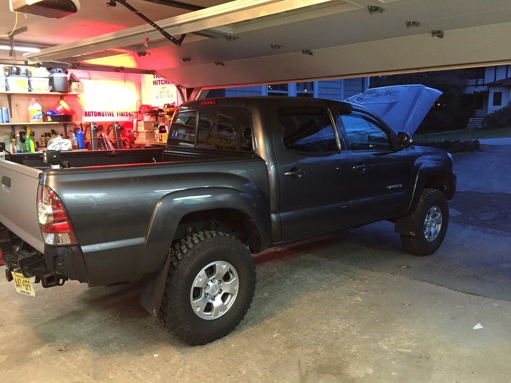

    What do you have for front lift? Spring rate? Looks like it's not hardly squatting with the added 200lbs. I'm trying to decide aluminum vs steel...

    OME 886's doing their job :thumbsup:

    Thanks man. It's a tight fit, that's for sure...
